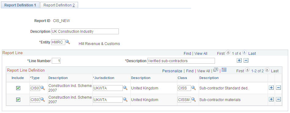

Use the Report Definition 1 page (WTHD_RPT_DFN) to specify selection criteria for withholding reports.
Define the layout of the withholding reports based on your tax authority's reporting and filing requirements.
Navigation:
This example illustrates the fields and controls on the Report Definition 1 page. You can find definitions for the fields and controls later on this page.
Each report line is generally equivalent to a "box" on the withholding entity's withholding form. Enter a line for each withholding class combination you report separately on the report.

Include |
Select this check box at the beginning of the line for each withholding class combination you are including in the report. |
