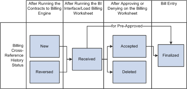

These four areas are related to billing and have status fields:
Billing plans.
Billing plan events.
Prepaids.
Billing cross-reference history.
Status fields exist for each of these areas to initiate edit checking, enable processing, and indicate billing progress.

Billing Plan Status Flow
This diagram shows the flow between the billing plan status values:

Understanding Billing Cross-Reference History Status
The billing cross-reference history stores all the billing history for any contract. For fixed-amount contract lines, the record is tracked from when PeopleSoft Contracts sends bill rows to PeopleSoft Billing through finalization of the bill in PeopleSoft Billing. For rate-based contract lines, this information is stored upon finalization of the bill.
The billing cross-reference table provides a link between billing activity in PeopleSoft Contracts and billing activity in PeopleSoft Billing. Six billing cross-reference history status values exist. The following statuses apply only to fixed-amount billing plans (milestone, % complete, immediate, and value-based).
Term |
Definition |
New |
When you run the Contracts Billing Interface process, a billing cross-reference row with the status of New is created for each billing plan event that is on a billing plan with a status of Ready or In Progress and that has a billing plan event status of Ready or Recycled (with deleted cross-reference rows). |
Received |
When the Billing Interface process (BIIF0001) is run in PeopleSoft Billing, the billing cross-reference status is updated to Received for rows that successfully complete the Billing Interface process; the status is not updated for records that appear as errors in the interface. The Billing Interface process loads the Billing Worksheet with PeopleSoft Contracts and PeopleSoft Project Costing billing activity. For billing activity coming from billing plans for which you selected Direct Invoicing and Pre-Approved, the billing activity skips the Billing Worksheet process. This situation is the only one for which the status moves directly from Received to Finalized. |
Accepted |
Once the billing activity is populated into the Billing Worksheet, the billing administrator can accept or cancel the fixed-amount billing activity. If accepted, the billing cross-reference row status corresponding to that billing activity is updated to Accepted. |
Deleted |
Once the billing activity is populated into the Billing Worksheet, the billing administrator can accept or cancel the fixed-amount billing activity. If cancelled, the billing cross-reference row status corresponding to that billing activity is updated to Deleted. |
Finalized |
For billing activity related to fixed-amount and recurring billing plans, upon finalization of billing activity, the billing cross-reference row status corresponding to that billing activity is updated to Finalized for fixed-amount and recurring activity. For billing activity related to rate-based billing plans, upon finalization of billing activity a row is created in the billing cross-reference table with a Finalized status. Any credits, rebills, or manual bills initiated directly in PeopleSoft Billing are reflected on the billing cross-reference row if they were made in reference to an existing Contract and Billing Plan. Note: Rate-based billing activity (As-Incurred billing method) that comes from PeopleSoft Project Costing is not populated into the Contracts billing cross-reference table until after the bills have been finalized in PeopleSoft Billing; therefore, rows for rate-based billing can appear only on billing cross-reference rows with a status of Finalized. |
Reversed |
For billing activity related to fixed-amount billing plans, upon reversal of billing activity, the billing cross-reference row status corresponding to that billing activity is updated to Reversed for fixed-amount activity. |
The system controls how the billing status values change based on the following application engines:
This diagram illustrates System billing status changes affected by application engine processes
