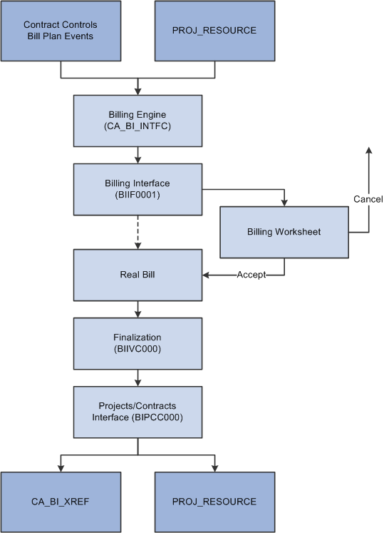

This flow chart illustrates the billing process flow for Grants transactions. Billable transactions stored in Contracts and the PROJ_RESOURCE table is selected by the CA_BI_INTFC process and passed to Billing through the Billing Interface process. After the bills are finalized, the Projects/Contracts Interface process updates Contracts and Project Costing with the billed award transaction data:
Updates in PeopleSoft Project Costing and PeopleSoft Contracts are made throughout the billing cycle for rate-based and fixed-fee billing plans.
Run the Contracts/Billing Interface process in PeopleSoft Contracts to send billing activity in PeopleSoft Project Costing to PeopleSoft Billing. The contracts that you set up control the billing activity that the system selects from PeopleSoft Project Costing.
Instructions on running the Contracts/Billing Interface process appear in the PeopleSoft Contracts documentation.
The Contracts/Billing Interface process populates the Billing Interface table with the billable lines that it finds in the Project Resource table in PeopleSoft Project Costing. The Billing Interface table is a staging table that holds the data until you run the Billing Interface process (BIIF0001) from PeopleSoft Billing.
To verify that the Contracts/Billing interface process imported the billing lines, access the Review Pending Transactions pages in PeopleSoft Billing (select
If you detect a problem with the billing lines, navigate to the Update Pending Transactions pages (select and correct them prior to running the Billing Interface process
Run the Billing Interface process in PeopleSoft Billing to create the temporary bills that you can work on in the billing worksheet. The billing worksheet is a temporary work area in which you can review and adjust billing lines that came through the Billing Interface process before you create actual bills.
After making adjustments, use the Billing Worksheet component to approve or delete temporary bills.
Instructions on running the Billing Interface process appear in the PeopleSoft Billing documentation.
When you accept a bill in the billing worksheet, the system creates a real bill with a real invoice number and updates PeopleSoft Contracts and PeopleSoft Project Costing accordingly.
Instructions on approving billing worksheets appear in the PeopleSoft Billing documentation.

Run the Finalization process (BIIVC000) on the real bills that you create. This process performs a variety of tasks, including calculating taxes and the due date.
Instructions on running the Finalization process appear in the PeopleSoft Billing documentation.
After you run the Finalization process, run the Billing to Projects/Contracts Interface process (BIPCC000). This process updates PeopleSoft Contracts and PeopleSoft Project Costing with the finalized bill information from PeopleSoft Billing.
Instructions on running the Projects/Contracts Interface process appear in the PeopleSoft Billing documentation.

The LOC billing process calculates LOC draws based on LOC numbers and summarizes the information by document number.
PeopleSoft Billing can defer a charge. Upon approval of an LOC worksheet that contains deferred bill options, the portion of the line amount that is billed retains the BIL (billable amount) analysis type and is billed. The line that is deferred is given the DEF (deferred amount) analysis type and is written back to the Project Resource table. The deferred amount is then brought back into the PeopleSoft Billing system at a later date when you are running processes that populate the billing worksheet.
The PeopleSoft Contracts application engine process (CA_BI_INTFC) selects resource rows (for rate-based methods) from the Project Resource table for PeopleSoft Grants contracts and creates bill lines in the billing interface tables.
After the Billing Interface process stages the billing data in these tables, the billing interface processes the data to create bills.
PeopleSoft Billing ensures that for all awards that use LOC as the means for obtaining payment, the awarded LOC and LOC document number are carried into the bill header.
