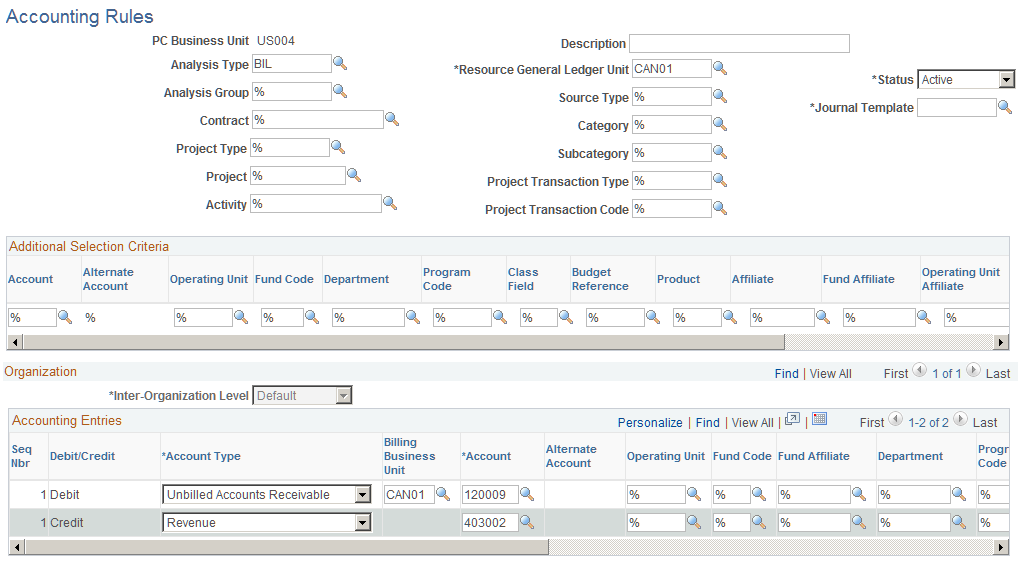

Use the Accounting Rules page (PSA_ACCT_SETUP) to define the accounting rules to apply to rate-based transactions that originate in Project Costing, fee-based transactions that originate in PeopleSoft Contracts, or transactions that were not accounted for in feeder systems.
The system uses these rules when you run the Process Project Accounting process.
Navigation:
This example illustrates the fields and controls on the Accounting Rules page. You can find definitions for the fields and controls later on this page.
This page is divided into three sections. In the top section, you define the criteria for incoming transactions to which the accounting rules apply. In the Organization section, you specify the organizational relationship for which the rules apply, and in the Accounting Entries section, you define the accounting transactions that the system creates.
Note: On this page, you can enter a percent symbol as a wildcard, which indicates any possible value. You cannot use partial wildcards on this page, which is alphanumeric symbols in combination with the percent sign symbol.
