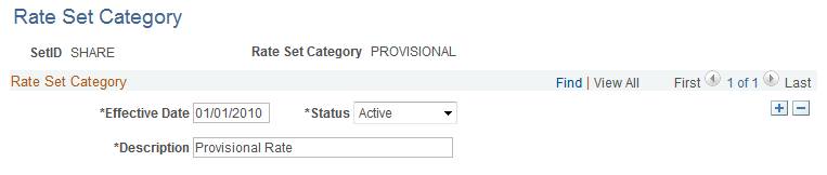

Use the Rate Set Category page (PC_RATE_CATEGORY) to define categories that are used to group rate sets.
The rate set category can be selected on the Variance Pricing run control page.
Navigation:
This example illustrates the fields and controls on the Rate Set Category page. You can find definitions for the fields and controls later on this page.
The rate set category is used on the Variance Pricing run control page, where it can be selected in the Rate Processing Option field. If Rate Set Category is selected in the Rate Processing Option field, then all rate sets that are associated with the rate set category selected in the Rate Category field are selected when the Variance Pricing processes runs.

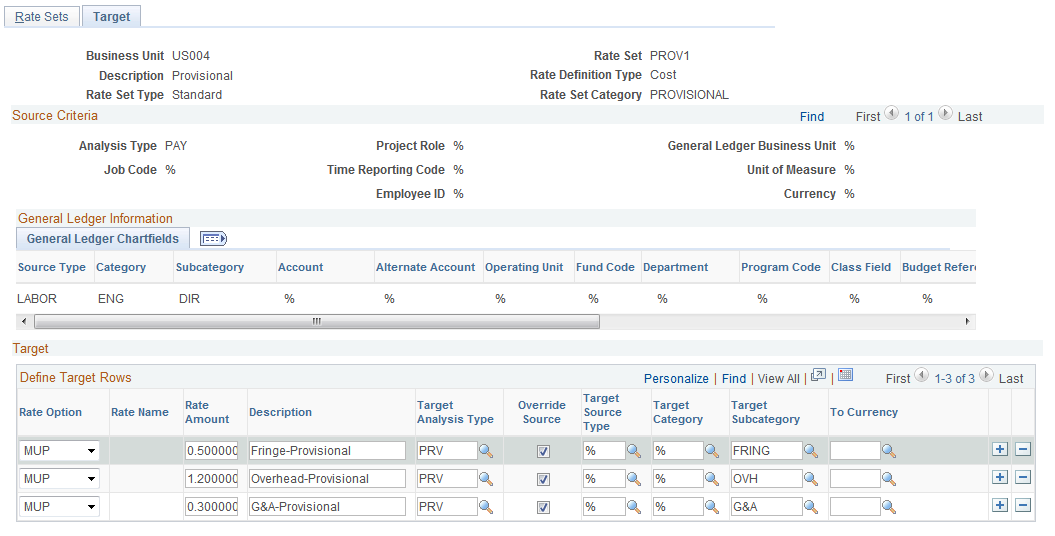

Use the Rate Sets - Target page (PC_RATE_DTL_LN) to define rate set target criteria to create cost, billing, or revenue rows.
Navigation:
Click the Target link on a row in the Define Criteria for Incoming Transactions grid on the Rate Sets page.
This example illustrates the fields and controls on the Rate Sets - Target page.
Note: The system supports the use of wildcards (the percent symbol) but does not support the use of partial wildcards (alphanumeric characters in combination with the percent symbol).
The ChartField values that you define for the source row on the Rate Sets page appears on the Rate Sets - Target page for reference.
You can associate each source row with multiple target rows.
