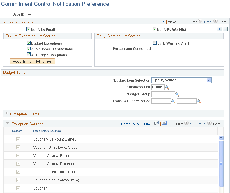

Use the Commitment Control Notification Preference page (KK_NOTIFY_PREFS) to identify early warnings and exceptions for which you want to be notified.
Navigation:
This example illustrates the fields and controls on the Commitment Control Notification Preference page. You can find definitions for the fields and controls later on this page.
Notification Options
Field or Control |
Description |
Budget Exceptions |
Select this check box; then identify the budgets for which you want to receive exception notifications in the Budget Items group box. Note: You must select either Budget Execution or Early Warning to receive notification. You can select both. |
All Sources Transactions |
Select to receive exception notification for all transaction sources—vouchers, purchase orders, and so on. Alternatively, you can specify sources in the Exception Sources group box. |
All Budget Exceptions |
Select to be notified of all exception types. Alternatively, you can specify exception events in the Exception Events group box. |
Reset E-mail Notification |
Click this button after making changes to your budgets. This clears out the message log and you receive future notifications. A user is notified once through email per budget or exception combination. For example, if budget A has run out of spending authority, then the system issues one message indicating that fact. This prevents a users email from overflowing with the same message every time a transaction fails against budget A. When additional funds have been put into budget A for example, the user then clicks the Reset E-mail Notification button to clear out the log and enable the user to receive future budget exceptions for budget A. |
Early Warnings and Percentage Consumed |
Select the check box and enter the percentage of the available budget that must be committed or spent before the system triggers an early warning. Then identify the budgets for which you want to receive early warnings in the Budget Items group box. Note: An early warning notification is re-sent for a given budget combination if the early warning percentage on the preferences page is changed or if the budget amount has changed since the previous notification was sent and the new percentage or amount is at a level that now triggers a notification. |
Budget Items
Use the Budget Items group box to identify the ChartFields and Commitment Control budgets to which these notification preferences apply.
Field or Control |
Description |
Budget Item Selection, Business Unit, and Ledger Group |
Specify the ChartField values for which you want budget exception notification:
Note: You must have security for the ChartField values you specify. |
From/To Budget Period |
You can also specify budget periods to further refine your notification preferences. |
Exception Events
Field or Control |
Description |
Exception Event |
Select the types of exceptions for which you want notification if you have not selected the All Budget Exceptions check box. You must also select at least one exception source to receive notification. |
See Errors and Warnings.
Exception Sources
Field or Control |
Description |
Exception Source |
Select the source transaction types for which you want notification if you have not selected the All Sources Transactions check box. You must also select at least one exception event to receive notification. |
