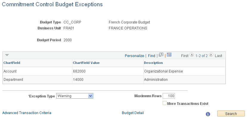

Use the Commitment Control Budget Exceptions page (KK_XCP_BUDGET) to view and override control budget exceptions on a budget-by-budget basis.
The page includes only budgets that have transactions with exceptions.
Navigation:
. Click the View Related Links button on a transaction exception header page or Exceptions Details page. Click the Budget Exceptions link on the Budget Details page.
This example illustrates the fields and controls on the Commitment Control Budget Exceptions page (1 of 2). You can find definitions for the fields and controls later on this page.
This example illustrates the fields and controls on the Commitment Control Budget Exceptions page (2 of 2). You can find definitions for the fields and controls later on this page.
The Business Unit and Ledger Group fields are required when entering search criteria on the Budget Exceptions search dialog page. The remaining fields can be left blank to return all values or you can enter values to further refine your search.

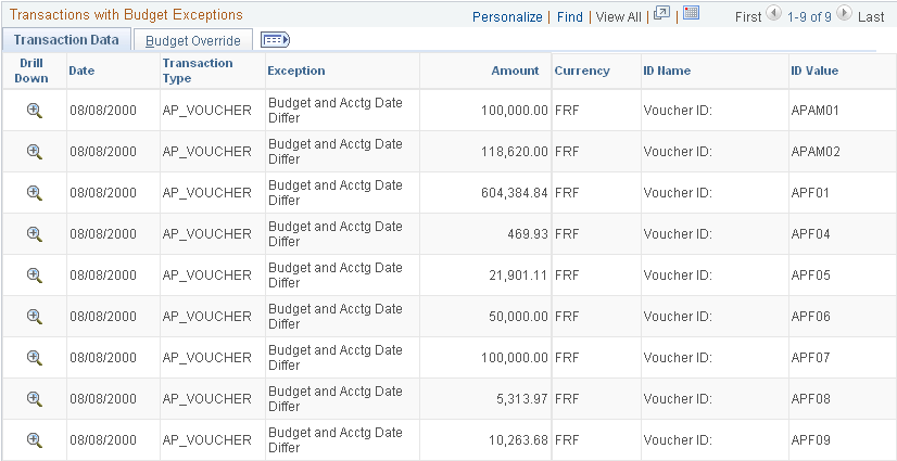

Click the Search button on the search dialog page and any exceptions are displayed in the Search Results scroll at the bottom of the search page. The scroll becomes available only if there are transaction exceptions for a budget. The scroll also returns both error and warning exceptions in the same search.
When you select a row from the Search Results scroll and no transaction exceptions are returned in the Transactions with Budget Exceptions group box at the bottom of the Commitment Control Budget Exceptions page, click the Advanced Transaction Criteria link to refine the criteria so that you can review the details of the exception. For example, if exception type and the from and to dates for the Commitment Control Budget Exceptions page do not match the exception type and dates of the exception you selected in the Search Results scroll, no transactions are returned in the Transactions with Budget Exceptions group box.

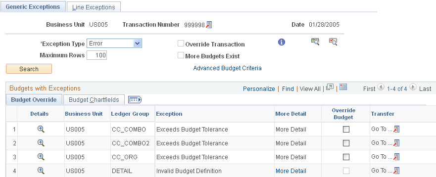

Use the Generic Exceptions page (KK_XCP_HDR_GEN) to view budget checking errors or warning messages for third-party transactions.
Users who have authority can override the budget exceptions on this page.
Navigation:
Commitment Control, Third Party Transactions, Generic Transaction Entry, Generic Exceptions
Click View Related Links, Go to Transaction Exceptions on the Commitment Control, Budget Exceptions, and Budget Checking Status pages.
This example illustrates the fields and controls on the Generic Exceptions page.

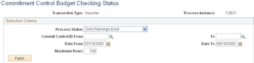

Use the Commitment Control Budget Checking Status page (KK_XCP_INQ_INSTANC) to review the budget checking status of source transactions for a single run of the Budget Processor.
You can access the Transaction Header Exceptions page for the transaction, as well as transaction inquiry, entry, and adjustment pages where you can view and change the transaction.
Navigation:
This example illustrates the fields and controls on the Commitment Control Budget Checking Status page.
Field or Control |
Description |
Process Status |
Select a Budget Checking Process Status. |
Commit Control ID From and To |
Select Commitment Control IDs to refine the status check. |
Commit Control Date |
Enter Commitment Control Date that encompass the status check. |
