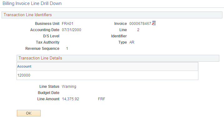

Use the Billing Invoice Line Drill Down page (KK_DRL_BI1_SEC) to view line details for source transactions with budget exceptions.
Navigation:
Click the Details icon on the Exception Details page for a specific transaction line.
This example illustrates the fields and controls on the Billing Invoice Line Drill Down page. You can find definitions for the fields and controls later on this page.
Transaction Line Identifiers
| Field or Control | Description |
| Transaction Line Identifiers | This group box provides information to identify the source transaction. |
| D/S Level (discount/surcharge level) | The discount or surcharge level number is applied to this line. |
| Tax Authority | Any tax authority agency that is empowered to set taxes against this bill. |
| Identifier | The discount/surcharge identifier |
| Revenue Sequence Number | The sequence number of the distribution line. |
| Type | The account entry type. |
Transaction Line Details
| Transaction Line Details | This group box displays the details for the line. It displays the ChartField name, value, and description for any of the ChartFields depending on the budget. |
Note: The ChartFields may or may not match the budget ChartFields, as the Budget Checking process translates the transaction ChartFields into the corresponding budget ChartFields by using the control budget definition.
| Line Status | The budget checking line status. Values are: E (error): The entry failed to pass budget checking. N (not checked): The Budget Checking process has not processed the entry or the invoice has been changed and not budget checked again. Exception data may be inaccurate. Budget check the transaction again to update the exceptions V (valid): The entry passed budget checking and the process updated the control budget ledger. W (warning): The Budget Checking process issued a warning, but also updated the control budget ledger. |
| Budget Date | The budget date for the distribution line in the invoice. |
| Line Amount | If the transaction amount and the base amount are different, both amounts appear. |
