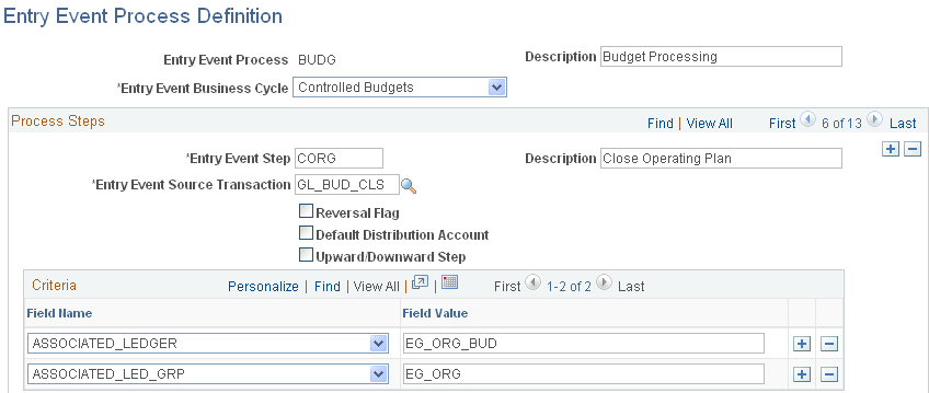

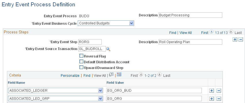

Set up the entry event process BUDG with two entry event steps based on the entry event source transactions:
GL_BUD_CLS for step CORG
GL_BUDROLL for step RORG
Associate the appropriate ledger group and ledger.

Note: Refer to the sample Entry Event Process Definition pages (Set Up Financials/Supply Chain, Common Definitions, Entry Event, Process, Entry Event Process Definition)
This example illustrates the fields and controls on the Entry Event Process Definition page - budget close step. You can find definitions for the fields and controls later on this page.
This example illustrates the fields and controls on the Entry Event Process Definition page - roll forward step. You can find definitions for the fields and controls later on this page.
