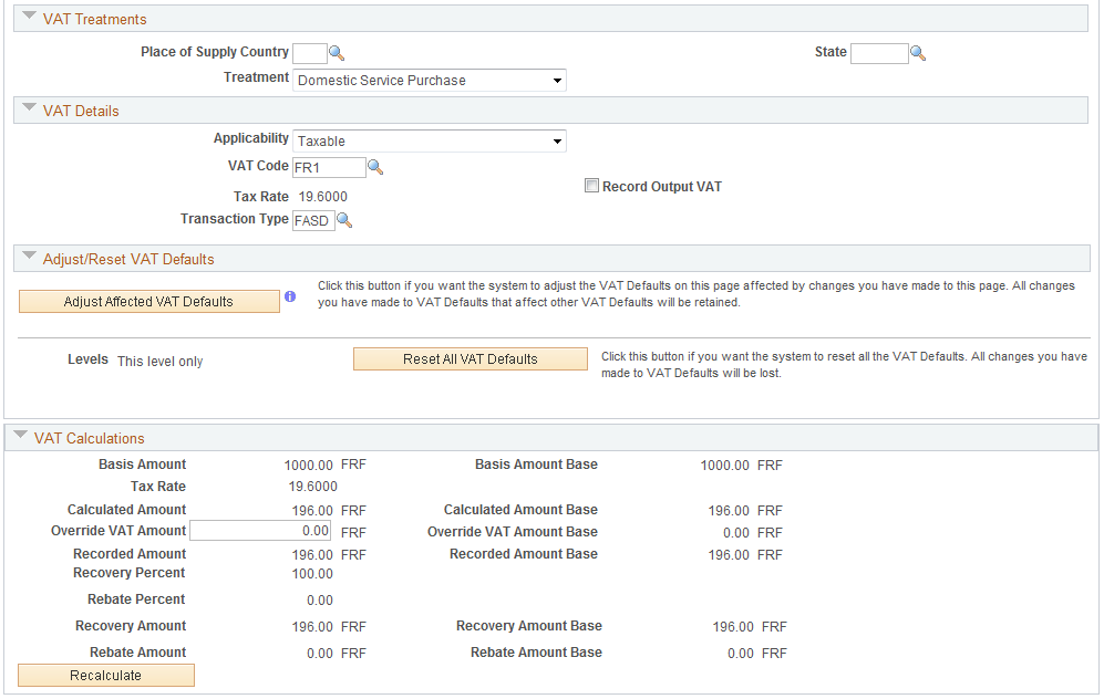

This example illustrates the fields and controls on the Treasury VAT Processing page (2 of 2). You can find definitions for the fields and controls later on this page.

Place of Supply Country |
Displays the country that is the supplier of record for the service. |
State |
Select a state within the defined Place of Supply Country. If the Place of Supply Country tracks VAT by state, then VAT default values may be defined at the state level. |
Treatment |
VAT treatment determines which default values should be applied, and also controls, to some extent, the availability of some VAT-related fields. See VAT Defaults. Select from the following:
VAT Details
Field or Control |
Description |
Applicability |
Displays a default value derived from the accounting template. You can override the values in this field. See Taxable Status and VAT Rates.
VAT Code |
Displays the default value derived from the appropriate VAT defaulting hierarchy depending on the defined Treatment and/or defined Applicability. You can override the values in this field. When you click the Recalculate button, the system uses the VAT defaulting hierarchy to update fields in the Calculations group box. |
Record Output |
The default comes from the accounting template. You can edit this field. Select this option to record and report one or more types of output VAT (Output, Output Intermediate, Output for Purchases) on transactions containing this VAT driver value. |
Transaction Type |
Displays the assigned VAT transaction type. VAT transaction types classify and categorize transactions at a more detailed level for both VAT reporting and accounting. |
See VAT Reporting and Accounting.
Adjust or Reset VAT Defaults
Adjusting or resetting VAT defaults will only affect the fields within this VAT Defaults group box:
Adjust Affected VAT Defaults
If you changed any fields on this page, these changes may impact VAT defaults on this page. For accuracy and consistency, click this button if you want the system to adjust the VAT defaults that are affected by your changes. All changes you have made to VAT Defaults on this page that affect other VAT Defaults on this page will be retained.
Click the i (information) button to list the fields that will be adjusted.
Note: PeopleSoft recommends that you always click the Adjust Affected VAT Defaults button after changing any defaults on the VAT page.
Levels
The levels affected when you click the Reset All VAT Defaults button may be different depending the application you are working with and the type of VAT page you are working on.
Select the level:
All lower levels
Select this field value to reset all VAT defaults at lower levels for this page.
Note: Reset completely redetermines the VAT defaults. This does not necessarily mean they will be reset to their original values. For example, the user may not have changed any VAT default values, but if a VAT driver field was changed, pressing Reset will redetermine all defaults based on the new driver value.
This and all lower levels
Select this field value to reset all VAT defaults on this VAT page and at any lower levels of this page.
This level only
Select this field value to reset all VAT defaults on this VAT page.
Click this button if you want the system to reset the VAT defaults based the Levels value you selected. Any changes you have previously made to VAT defaults will be lost.
VAT Calculations
Except for Entered Amount, all fields in this section are display only and the Recalculate function populates them.
Field or Control |
Description |
Basis Amount |
Displays the VAT basis amount in transaction currency. |
Basis Amount Base |
Displays the VAT basis amount in the base currency. |
Tax Rate |
Displays the VAT tax rate. |
Calculated Amount |
Displays the calculated VAT amount in the transaction currency. |
Calculated Amount Base |
Displays the calculated VAT amount in base currency. The system uses the transaction currency for the entered VAT amount, based on the exchange rate that is applicable to the transaction. |
Override VAT Amount |
Enter the override amount to recalculate the VAT amount. This amount displays in the transaction currency. |
Displays the recalculated override VAT amount in the base currency. |
Recorded Amount |
Displays the transaction currency amount stored in the system VAT tables. |
Recorded Amount Base |
Displays the base currency amount stored in the system VAT tables. |
Recovery Percent |
Displays a system-calculated value, based on the selected Use Type. |
Rebate Percent |
Displays a system-calculated value, based on the selected VAT Use Type. |
Recovery Amount |
Displays the VAT recovery amount in the transaction currency. |
Recovery Amount Base |
Displays the VAT recovery amount in the base currency |
Rebate Amount |
Displays the calculated VAT rebate amount in the transaction currency. |
Rebate Amount Base |
Displays the calculated VAT rebate amount in the base currency. |
See VAT Recoverability.
