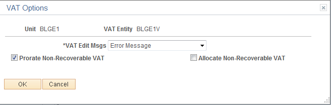

Use the Treasury - VAT Options page (TRV_BU_UNIT_OPT_TR) to define specific VAT processing options for a Treasury business unit.
Navigation:
Click Treasury VAT Options on the Treasury Options page.
This example illustrates the fields and controls on the Treasury - VAT Options page. You can find definitions for the fields and controls later on this page.
Field or Control |
Description |
VAT Edit Msgs (VAT edit messages) |
VAT edit messages are used to indicate if VAT tolerance messages are errors, warnings, or not displayed. This is a business unit-only default and applies directly to a transaction.
Prorate Non-Recoverable VAT |
Select this check box to record non-recoverable VAT amounts to an expense account. |
Allocate Non-Recoverable VAT |
Select this check box to allocate non-recoverable VAT using ChartField Inheritance logic. |
Note: You can select either to allocate or prorate nonrecoverable VAT transactions, but you cannot select both check boxes.
