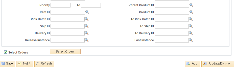

This example illustrates the fields and controls on the Undo Fulfillment Request process page (1 or 2). You can find definitions for the fields and controls later on this page.
This example illustrates the fields and controls on the Undo Fulfillment Request process page (2 or 2). You can find definitions for the fields and controls later on this page.

Select Orders
The Order Release Selection group box can limit your selection to a subset of the orders meeting the selection criteria. Click the Select Orders button to retrieve all orders that match the search criteria entered above on this Undo Fulfillment Request process page, then you can select individual orders to be processed. Click the Order No link to access detailed information for each order displayed in this group box; only demand lines that meet the selection criteria are displayed on this detailed page.
When you save this process page after selecting individual orders in the Order Release Selection group box, the Undo Fulfillment run control will process only the available demand lines of these individual orders. If you do not select individual orders in the Order Release Selection group box, the run control processes all demand lines that meet the selection criteria above.
You have the flexibility to exit and reenter the Undo Fulfillment Request process page without reselecting orders. When you click the Select Orders button, the system retrieves any previously selected orders in addition to those matching the current search criteria.
