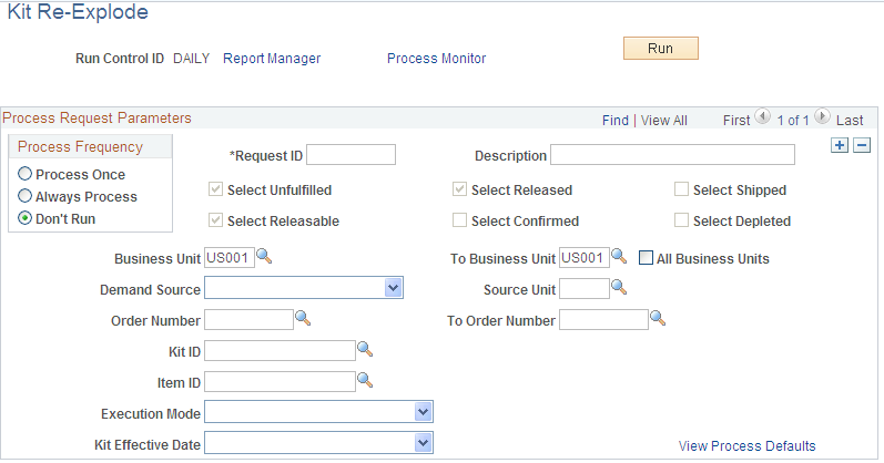

Use the Kit Re-Explode page (RUN_IN_FULFILL_XPL) to run the Kit Re-Explode process (IN_KIT_EXPL) to review and change any differences between the product kit on an order and the product kit definition.
This process enables you to change the order to match the current definition of the product kit.

This example illustrates the fields and controls on the Kit Re-Explode process page. You can find definitions for the fields and controls later on this page.
Field or Control |
Description |
Select Unfulfilled, Select Releasable, Select Released, Select Confirmed, Select Shipped, and Select Depleted |
Select one or more fulfillment states of the kit component demand lines. When selecting fulfillment states, keep in mind that this process works with the complete product kit. For example, if the user only checks the Select Unfulfilled check box, then the Kit Re-Explode process performs a second pass and brings in all kit component demand lines that are siblings of those demand lines matching the selection criteria, even if the demand lines are not in the unfulfilled state. The process re-explodes the product kit only if all the kit component demand lines have the selected fulfillment states. For example, if a product kit includes demand lines within the unfulfilled and releasable states, yet you have only selected the Select Unfulfilled check box here, then the system does not re-explode the product kit. The default selections in these check boxes are defined on the From States tab on the Setup Fulfillment-Fulfillment Task Options page (inventory business unit level) or the Fulfillment Engine Options component (SetID level). The selection is further limited by restrictions placed on the Demand Change Configuration component for the Batch Kit Re-Explode row. |
Business Unit and To Business Unit |
Enter the Inventory business unit or range of units for the demand lines to be processed. |
Demand Source and Source Unit |
Enter the source of the order and the business unit of the originating PeopleSoft application in order to limit the demand lines selected to one source. For example, entering OM and US001 limits the selection to sales order demand lines created in the PeopleSoft Order Management business unit US001. |
Order Number and To Order Number |
Enter the order number or a range of order numbers to limit the selection to specific orders. These fields can only be used if you have also populated the Business Unit, Demand Source, and Source Unit fields. When the run control record is saved, the Order Number and To Order Number fields are checked to make sure that they are valid for the entered Business Unit, To Business Unit, Demand Source, and Source Unit fields. The order number fields are not checked against the fulfillment state check boxes; Select Unfulfilled, Select Releasable, and so on. |
Kit ID |
Enter a product kit ID to limit the selection to demand lines containing components of this Kit ID. |
Item ID |
Enter the inventory item ID of one component of the product kit and the system selects all demand lines containing this component and any other components to the same product kit. If the item ID belongs to multiple kits, then all product kits are considered. |
Execution Mode |
Choose the action to be performed by the Kit Re-Explode process. The option are:
Kit Effective Date |
Select the date of the component kit demand lines to be compared to the date range (effective date and obsolete date) on the Product Kit Summary page. The demand line dates are:
View Process Defaults |
Select this link to view the defaults established for the Kit Re-Explode process. The Execution Mode and Kit Effective Date fields on this process page can only be changed if the Allow Kit Re-Explode Overrides check box has been selected on the Setup Fulfillment-Fulfillment Task Options page (inventory business unit level) or the Fulfillment Engine Options component (SetID level). |

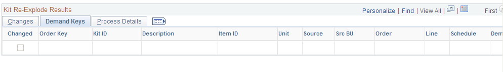

The Demand Keys tab identifies the exact demand lines to be changed.
The inventory unit, demand source, source business unit, order number, line number, schedule number, demand line number, and the item ID are displayed.

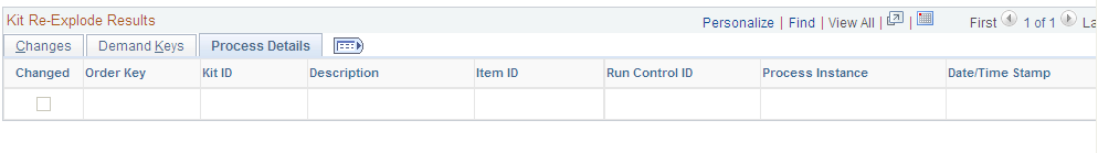

The Process Details tab displays the run control and process instance of the Kit Re-Explode process that has produced these results, as well as the date and time that the process was run.

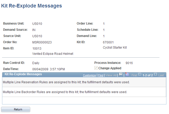

Use the Kit Re-Explode Messages page (IN_KIT_EXPL_MSG) to view the messages that detail the actions of the Kit Re-Explode process by demand line.
Navigation:
Select the Messages link on the Kit Re-Explode Results page.
This example illustrates the fields and controls on the Kit Re-Explode Messages page. You can find definitions for the fields and controls later on this page.
The Kit Re-Explode Messages page enables you to see, for each demand line, the reasons for the Kit Re-Explode action performed or just reported by the process. This page enables you to evaluate the detailed changes on each demand line.
Field or Control |
Description |
Run Control ID, Process Instance, and Date/Time |
Displays the run control ID, process instance, and the date and time of the Kit Re-Explode process that produced these results. |
Change Applied |
Displays if the change was applied to the demand line. If this check box is selected, then the Kit Re-Explode process has changed the demand line based on the reasons detailed on this page. If this check box is clear, then the Kit Re-Explode process has not changed the demand line and is just reporting. The demand line might not be changed because:
Kit Re-Explode Messages group box |
This group box displays the reasons for the Kit Re-Explode action on this demand line. Messages include:

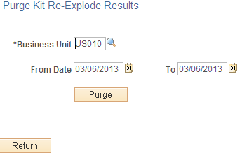

Use the Purge Kit Re-Explode Results page (IN_KIT_EXPL_PUR) to select to purge report data generated by the Kit Re-Explode process.
Navigation:
Select the Purge Kit Re-Explode Results link on the Kit Re-Explode Results page.
This example illustrates the fields and controls on the Purge Kit Re-Explode Results page. You can find definitions for the fields and controls later on this page.
Based on inventory business unit and process date range, erase Kit Re-Explode report data that is no longer needed.

Business Unit |
Enter the Inventory business unit. This is a required entry. |
From Date and To |
Enter the data range to select the reports to purge. This date is the system date of the process instance that generated the report data. |
Purge |
Click to erase the report data based on the business unit and date range entered. When you click the Purge button, a secondary page asked you to confirm or cancel the purge. |
