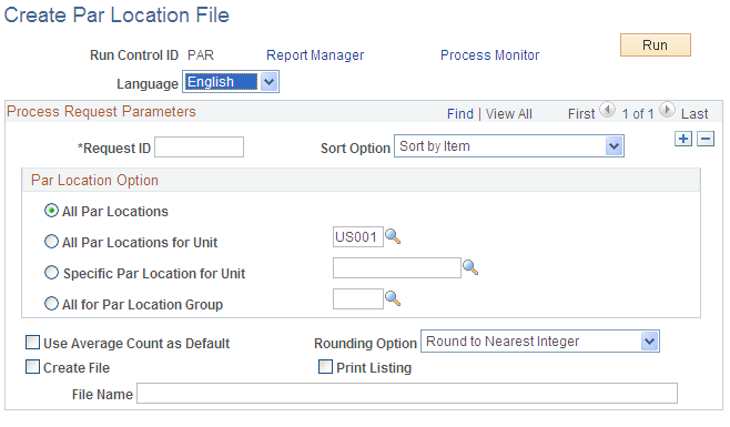

To define par location files, use the Create Par Location File (RUN_INS9053) component.
Use the Create Par Location File page (RUN_INS9053) to generate printed reports or downloadable files of par location items and compartments.
This process is used by the manual counting method and the file-based counting method.
Navigation:
This example illustrates the fields and controls on the Create Par Location File process page. You can find definitions for the fields and controls later on this page.
This task is required if you are using the file-based counting method to count par locations; it is optional for the manual counting method. The Par Location File Creation process (IN_CART_DNL and INS9053) sequences par locations alphanumerical and sequences items within each par location according to the sort option that you specified on the run control page. The IN_CART_DNL process produces the flat file; the INS9053 process retrieves the Par Location Count sheet.
Field or Control |
Description |
Use Average Count as Default |
Select to use the average count quantity as the default quantity on the printed report or downloaded file. |
Rounding Option |
If you selected Use Average Count as Default, indicate how the average usage should be rounded if it is a decimal quantity. |
Create File |
Select to create a file to download to electronic data collection devices. |
Print Listing |
Select to print the Par Location Count Listing report, which lists the attributes of each compartment in the specified par locations. You can use this report for manual counts. |
Note: Before running the Par Location File Creation process, use PeopleSoft Application Designer to verify that the file layout conforms to any ChartField configuration that is completed in PeopleSoft.

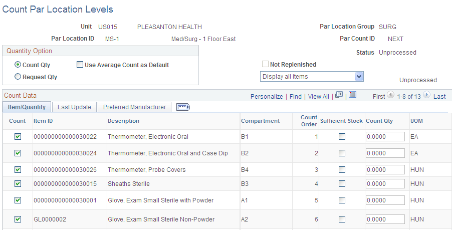

To enter count results for the manual counting method, use the Count Par Location Levels (CART_COUNT_INV) component.
Use the Count Par Location Levels page (CART_COUNT_INV) to enter results of manual par location counts.
This page is used by the manual counting method.
Navigation:
This example illustrates the fields and controls on the Count Par Location Levels page. You can find definitions for the fields and controls later on this page.
The Par Count ID field indicates if the system is creating a new count or updating an existing count. When the value of the Par Count ID field is NEXT, then a new count is created at save time. Counts with a status of In Process are not modifiable unless the Par Replenishment process changes the status to Error.
To enter the results of a new manual count in the PeopleSoft database:
Select the options in the Quantity Option group box to indicate that the quantities to be entered are the quantities counted (default) or the quantities requested.
Provide a default count quantity for each item based on its average usage, by selecting Use Average Count as Default and indicate how the quantity should be rounded.
You can override the average count on an item-by-item basis. If you leave this field blank, all item quantities are set to zero. (This is the system default.)
Indicate whether you want to display all items that are stored in the location, only items that are included in the current count, or only items that are not yet included in the current count.
For each item-compartment combination, enter the count quantity or request quantity (depending upon the quantity option), or indicate that you have sufficient stock on hand.
If you select the Sufficient Stock check box for an item, the quantity requested is zero, and the item is not replenished. If the item requires a count, the Sufficient Stock field is unavailable for entry. If you do not want to include the item in this count, deselect the Count check box.
Note: For nonstock items that are stored in multiple compartments, use a single item-compartment line to enter the total quantity for the par location. To prevent the creation of multiple requisitions, either mark all other compartment lines for the item as sufficiently stocked or enter the par quantity. (Because the Create Par Replenishment Requests process decrements the quantity ordered for each line to account for on-order quantity on any previously-generated requisitions for the item, multiple requisitions prevent the par location from receiving sufficient quantity to stock all compartments at par levels.)
Once you have run the Create Par Replenishment Requests process on this new count, you can review and correct errors, when you click the Error Detail link to access the Par Location Count Error log component.

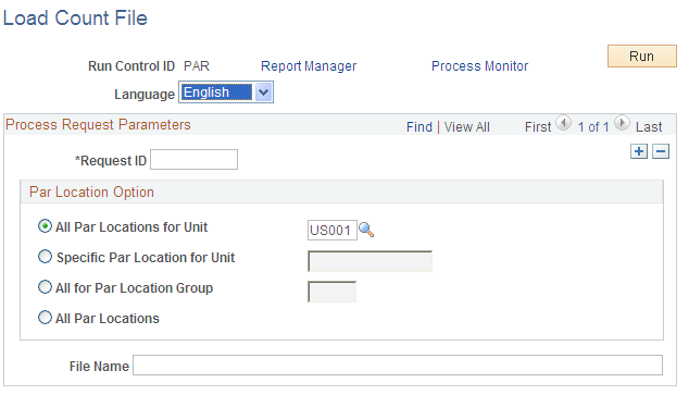

To electronically upload count data for the file-based counting method, use the Load Count File (RUN_INS9052) component.
Use the Load Count File page (RUN_INS9052) to upload count data that was collected using mobile devices.
This process is only used by the file-based counting method.
Navigation:
This example illustrates the fields and controls on the Load Count File process page. You can find definitions for the fields and controls later on this page.
Enter parameters for the Load Count File process (IN_CART_UPL), which loads data into the PeopleSoft Inventory par location count table (CART_CT_INF_INV). You can view the uploaded data on the Par Location Count inquiry page.
Remember, the Create Par Location File process creates the initial file that is downloaded to the mobile devices.
Note: Before running the Load Count File process, verify that the file layout conforms to the ChartField configuration in the PeopleSoft system.
