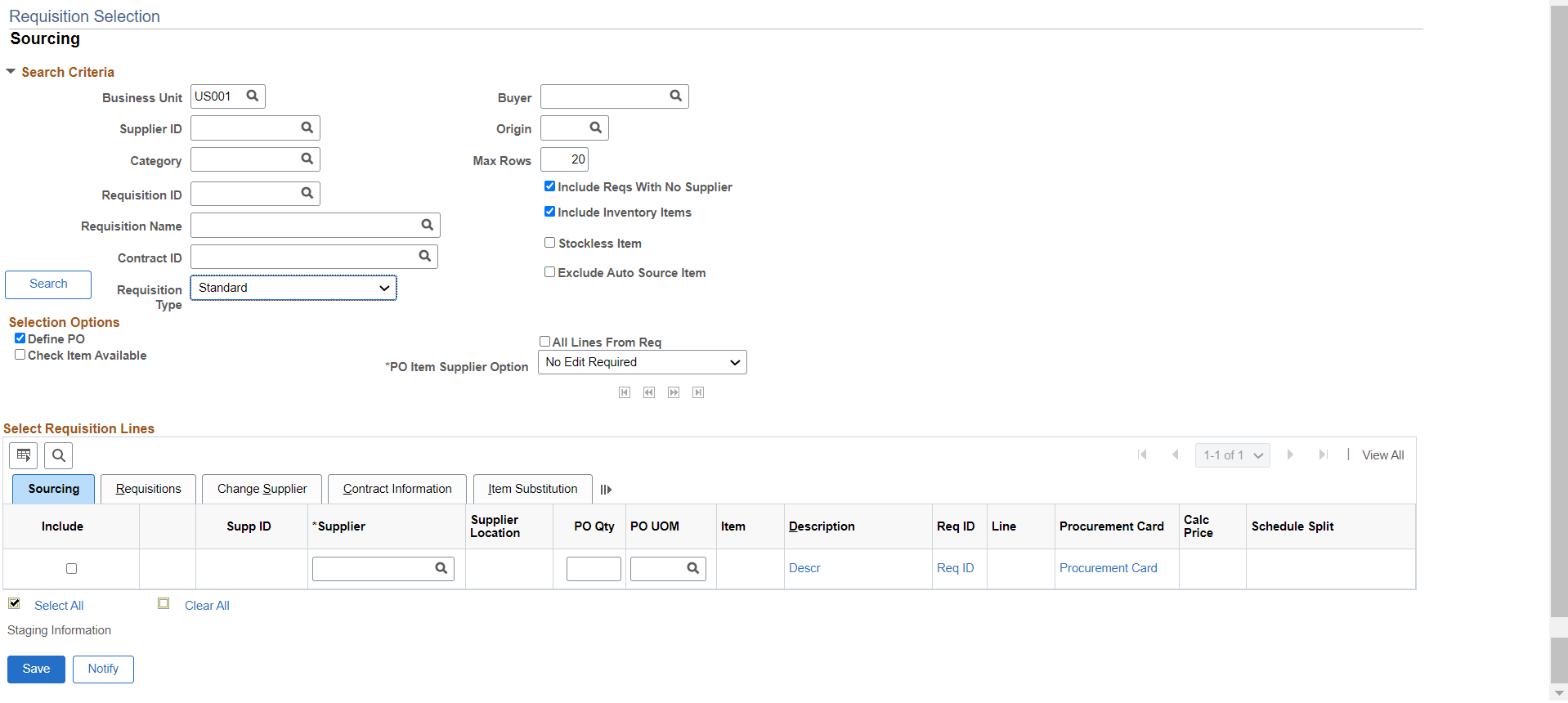

Use the Requisition Selection - Sourcing page (PO_REQ_SOURCE) to enter search criteria and source requisitions to purchase orders or inventory demand.
Navigation:
This example illustrates the fields and controls on the Requisition Selection - Sourcing page. You can find definitions for the fields and controls later on this page.
Search Criteria

Search |
Click to search for the requisitions that match the criteria you entered. The system populates the Select Requisition Lines grid with requisitions that match the criteria you enter. To perform another search, change the criteria and click the Search button again. |

Sourcing
Select the Sourcing tab.
Field or Control |
Description |
Include |
Select to include the requisition line for sourcing. After you select a requisition line, it becomes unavailable for entry. To make any further changes to the requisition line, clear the check box, make the change, then select it again. |
Supplier ID |
Select the supplier that you want to use on the purchase order. The system stores the last supplier ID, whether entered or loaded from a requisition line. If you include a line without specifying a supplier ID, the system uses the last entered supplier ID as the default. If you include a line without specifying a supplier ID and the stored supplier ID is blank, the system issues an error message. You cannot change the supplier when a contract is specified. |
Supplier Location |
Select the supplier location used for ordering and determining the pricing location. The priority location appears by default from the item and shipto or from the item supplier. |
PO Qty (purchase order quantity) |
Displays the purchase order quantity. The quantity appears as a default value from the requisition line. You can enter a purchase order quantity that exceeds the original requisition open quantity (oversourcing). You can also enter a quantity that is below the original requisition open quantity (partial sourcing), but only when all the requisition schedules for the line are charged by quantity. Partial sourcing and oversourcing is possible only when the Define PO check box is selected. |
PO UOM (purchase order unit of measure) |
Displays the UOM that you want to use on the purchase order. The UOM appears by default from the requisition line. If you are working with an ad hoc item, you can enter any UOM. If there is an item ID on the line, available UOMs are those in the INV_ITEM_UOM table. |
Click the View Related Links button to view details about the item. You can then select to view the item's availability or substitute items for the item. |
Identifies the item substitute is available |
Description |
Click to view a description of the item. |
Req ID(requisition ID) |
Displays the requisition ID to which this requisition line belongs. Click the link to access additional requisition details. |
Line # (line number) |
Displays the originating requisition line number. |
Procurement Card |
Displays the actual value of the procurement card assigned to the requisition or if no procurement card was assigned to the requisition as of yet it will display Procurement Card. Click the linked procurement card value to access the Requisition Selection - Procurement Card Information page. Use this page to override the current procurement card, view the current procurement card information or to assign a procurement card. |
Calc Price (calculate price) |
Indicates whether the PO Calculations process should recalculate the price or use the price from the requisition. If set to Y (yes), the PO Calculations process recalculates the price. If set to N (no), the PO Calculations process uses the price from the requisition. This option is set to Y and cannot be changed when using an item ID and a contract is specified. Note: If set to N, the PO Calculations process does not search for an available contract. |
Schedule Split |
Indicates that the quantity had been partially sourced. |
Staging Information |
Click to access the Staging Information page. The page displays staging information for the requisitions that you selected for staging. |
Check for Contract |
Click to have the system search for and use appropriate contracts on manually entered purchase orders. This enables you to receive contract prices for requisition items and to more accurately track budgets, pre-encumberance balances and control contract leakage and can be established at the business unit level. This button appears when you have selected to automatically default a contract onto a requisition. Select the Default Contract on Req check box on the Business Unit Options page. When you click the Check for Contract button, the system searches for manually entered purchase orders and requisitions and ensures that the correct contract is selected for use with the requisition. After locating possible contracts, the system copies them to transaction lines. The contract check takes place when the Supplier, Quantity, UOM, ShipTo, Item, or Item Description fields are created or changed. You can override contracts that have been selected by the system using the requisition header. |
