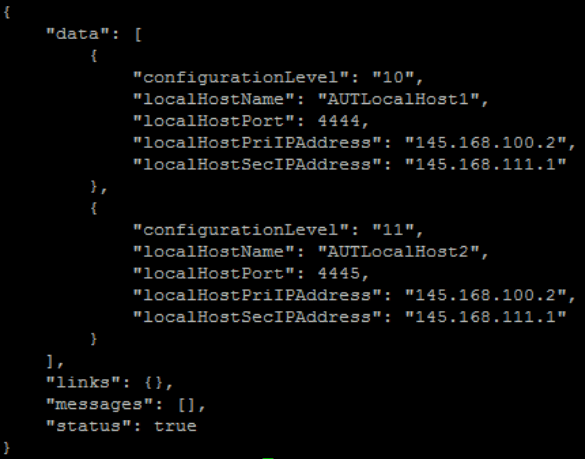

  46. To verify the vSTP MP local nodes info:
    1. Log in to the SOAM VIP server console as admusr.
    2. Run the following command [admusr@SOAM1 ~]$ mmiclient.py /vstp/localhosts
    3. Verify if the output is similar to the following output.
      Figure 4-1 Output
      Output

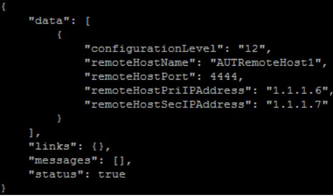

  47. To verify the vSTP MP remote nodes info:
    2. Run the following command:
      [admusr@SOAM1 ~]$ mmiclient.py /vstp/remotehosts
    3. Verify if the output is similar to the following output:
      Figure 4-2 Output
      Output

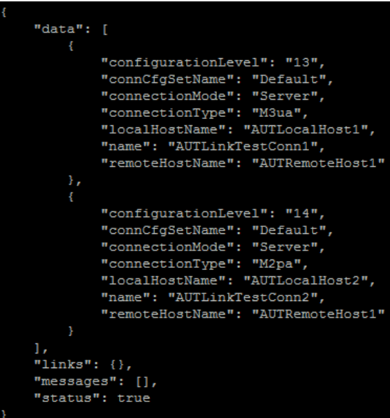

  48. To verify the vSTP MP connections info:
      [admusr@SOAM1 ~]$ mmiclient.py /vstp/connections
      Figure 4-3 Output
      Output

  39. To verify the vSTP MP Local nodes info:
    1. Log in to the SOAM VIP Server console as admusr.
    3. Verify the output similar to the below output.
      Figure 4-4 Output
      Output
  40. To verify the vSTP MP remote nodes info:
    3. Verify the output similar to the below output:
      Figure 4-5 Output
      Output
  41. To verify the vSTP MP Connections info:
    3. Verify if the output is similar to the below output:
      Figure 4-6 Output
      Output

  29. To verify the vSTP MP local nodes info:
    3. Verify if the output is similar to the below output.
      Figure 4-7 Output
      Output
  30. To verify the vSTP MP remote nodes info:
      Figure 4-8 Output
      Output
  31. To verify the vSTP MP Connections info:
      Figure 4-9 Output

  24. To verify the vSTP MP local nodes info:
      Figure 4-10 Output
      Output
  25. To verify the vSTP MP Remote nodes info:
      Figure 4-11 Output
      Output
  26. To verify the vSTP MP Connections info:
      Figure 4-12 Output
      Output
