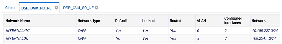

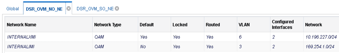

  3. In NOAM GUI, create the NOAM network element using the XML file.
    1. Navigate to Configuration, and then Networking, and then Networks.
    2. Click Browse and type the pathname of the NOAM network XML file.
    3. Click Upload File to upload the XML file. See the examples in Sample Network Element and Hardware Profiles and configure the NOAM network element.
    4. Once the data has been uploaded, you should see a tabs display with the name of your network element. Click on this tab which describes the individual networks that are now configured.
      Configured Network

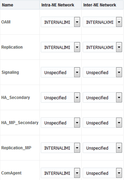

  4. In NOAM GUI, map services to networks.
    1. Navigate to Configuration, and then Networking, and then Services.
    2. Click Edit and set the services as shown in the table below:
      Table 5-1 Network Services
      Name Intra-NE Network Inter-NE Network
      OAM <IMI Network> <XMI Network>
      Replication <IMI Network> <XMI Network>
      Signaling Unspecified Unspecified
      HA_Secondary Unspecified Unspecified
      HA_MP_Secondary Unspecified Unspecified
      Replication_MP <IMI Network> Unspecified
      ComAgent <IMI Network> Unspecified
      For example, if your IMI network is named IMI and your XMI network is named XMI, then your services configuration should look like the following:
      XMI
    3. Click OK to apply the Service-to-Network selections. Dismiss any possible popup notifications.

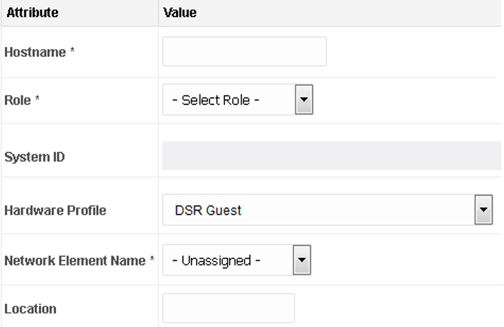

    3. Fill in the fields as follows:
      Hostname: <Hostname>
      Role: NETWORK OAM&P
      System ID: <Site System ID>
      Hardware Profile: DSR Guest
      Network Element Name: [Select NE from drop-down list]
      The network interface fields are now available with selection choices based on the chosen hardware profile and network element.

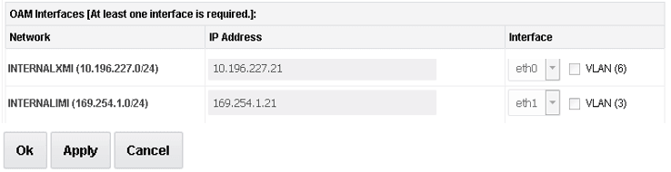

    4. Fill in the server IP addresses for the XMI network. Select ethX for the interface. Leave the VLAN checkbox unchecked.
    5. Fill in the server IP addresses for the IMI network. Select ethX for the interface. Leave the VLAN checkbox unchecked.

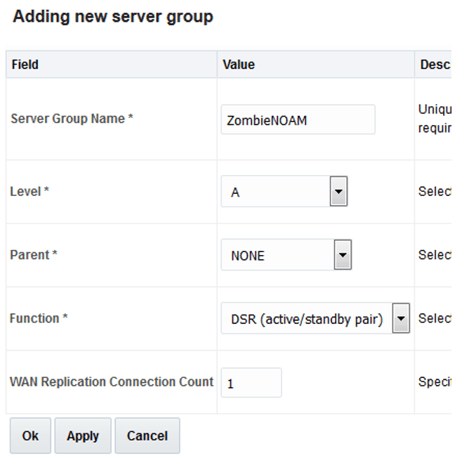

  2. In NOAM GUI, enter NOAM server group data.
    1. Navigate to Configuration, and then Server Groups.
    2. Click Insert and fill in the following fields:
      Server Group Name: [Enter Server Group Name]
      Level: A
      Parent: None
      Function: DSR (Active/Standby Pair)
      WAN Replication Connection Count:Use Default Value
      Add New Server Group
    3. Click OK when all fields are filled.

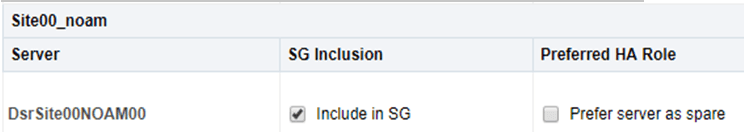

  3. In NOAM GUI, edit the NOAM server group.
    2. Select the new server group and click Edit.
      Select the network element that represents the NOAM.
      NE for NOAM

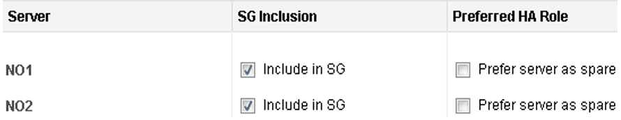

    3. In the portion of the screen that lists the servers for the server group, find the NOAM server being configured. Mark the Include in SG checkbox.
    4. Leave the other box unchecked.
    5. Click OK.

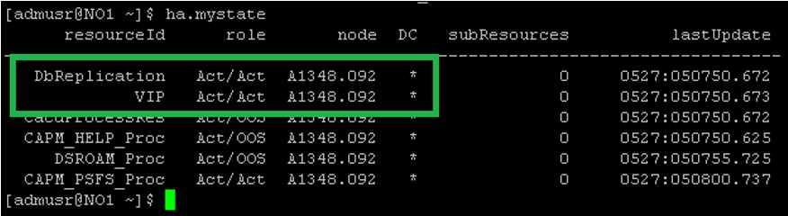

  4. In NOAM server, verify NOAM VM role.
    From console window of the first NOAM VM, run the ha.mystate command to verify the DbReplication and VIP items under the resourceId column has a value of Active under the role column.
    You may have to wait a few minutes for it to be in that state.
    Example:

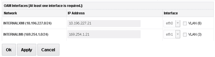

    4. Fill in the server IP addresses for the XMI network. Select ethX for the interface. Leave the VLAN checkbox unmarked.
    5. Fill in the server IP addresses for the IMI network. Select ethX for the interface. Leave the VLAN checkbox unmarked.

  1. In NOAM GUI, edit the NOAM Server Group Data.
    1. From the GUI session on the first NOAM server, navigate to Configuration, and then Server Groups.
    2. Select the NOAM server group and click Edit.
    3. Add the second NOAM server to the server group by marking the Include in SG checkbox for the second NOAM server. Then, click Apply.
      Second NOAM

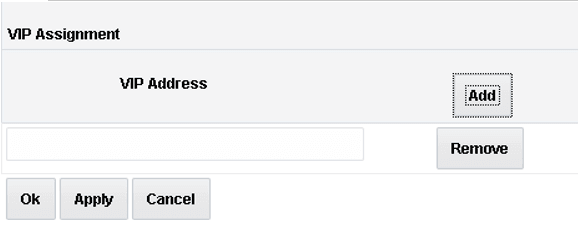

    4. Click Add to add a NOAM VIP. Type the VIP Address and click OK.
      NOAM VIP

    4. Once the data has been uploaded, you should see tabs appear with the name of your network element. Click on the tab, which describes the individual networks that are now configured.
      Configured Networks

    1. Navigate to Configuration, and then Servers.
    2. Click Insert to insert the new NOAM server into servers table (the first or server).
      Role: NETWORK OAM&P
      Network Element Name: [Select NE from list]
      Level: A
      Parent: None

    1. Navigate to Main Menu, and then Configuration, and then Servers.
    2. Click Insert to insert the new NOAM server into servers table (the first or second server).
      Role: NETWORK OAM&P
      Network Element Name: [Choose NE from list]

  1. In primary NOAM VIP GUI, edit the DR NOAM server group data.
    1. From the GUI session on the primary NOAM server, navigate to Configuration, and then Server Groups.
    4. Click Add to add an NOAM VIP. Type the VIP Address and click OK.
      VIP
      Hostname: <SO1-Hostname>
      Role: SYSTEM OAM

  1. In primary NOAM VIP GUI, enter SOAM server group data.
    1. From the GUI session on the NOAM VIP address, navigate to Configuration, and then Server Groups.
    2. Click Insert and add the SOAM server group name along with the values for the following fields:
      Level: B
      Parent: [Select the NOAM Server Group]
      WAN Replication Connection Count: Use Default Value
      For DSR mated sites, repeat this step for additional SOAM server groups where the preferred SOAM spares may be entered before the active/standby SOAMs.

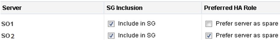

  2. In primary NOAM VIP GUI, edit the SOAM server group and add VIP.
    2. Select the new SOAM server group and click Edit.
    3. Add both SOAM servers to the server group primary site by marking the Include in SG checkbox.
    4. Click Apply.
  3. In primary NOAM VIP GUI, add the SOAM VIP.
    3. Click Add to add a SOAM VIP. Type the VIP Address and click OK.

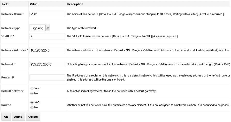

  3. In primary NOAM VIP GUI, add signaling networks.
    The following screen displays.
    Signaling Network
    1. Type the Network Name, Network Type, VLAN ID, Network Address, Netmask, and Router IP that matches the signaling network.
      Even if the network does not use VLAN tagging, you should type the correct VLAN ID here as indicated by the NAPD.
      1. Select Signaling for Network Type.
      2. Select No for Default Network.
      3. Select Yes for Routable.
    2. If you are finished adding signaling networks, click OK. To save this signaling network and repeat this step to enter additional signaling networks, click Apply .

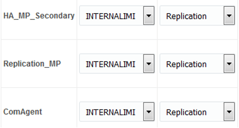

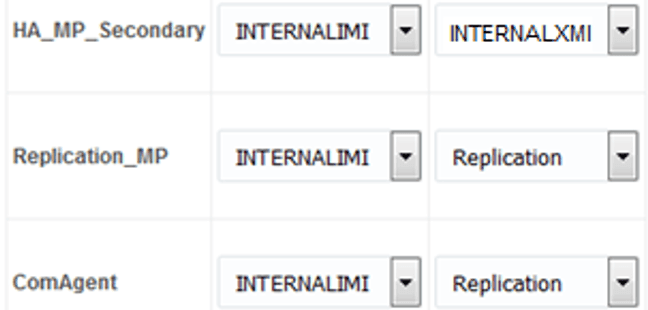

  6. In primary NOAM VIP GUI, perform additional service to networks mapping.
    Run this step only if you are defining a separate, dedicated network for SBR replication. This is only applicable to PCA.
    2. Click Edit.
    3. Set the services using one of the following scenarios.
      • If the dual-path HA configuration is required:
        For HA_MP_Secondary, Oracle recommends the inter-NE network is set as the XMI network and intra-NE network is set as the IMI network. If the primary interface (Replication_MP) SBR DB Replication Network interface goes down, use the secondary network for sharing HA status to reduce the likelihood of a split brain. This leads to DSR mate isolation from the active SBR and results in traffic loss until SBR DB Replication Network is down.
        Table 5-7 Replication Network
        HA_MP_Secondary <IMI Network> <XMI Network>
        Replication_MP <IMI Network> <SBR DB Replication Network>
        ComAgent <IMI Network> <SBR DB Replication Network>
        HA
      • If the dual-path HA configuration is not required:
        The intra-NE network is set as the IMI network and inter-NE network is set as the PCA replication network (configured in step 5. This may lead to a split database scenario in case the SBR DB Replication Network interface goes down. Due to this, an active SBR server in each site is in effect.
        Table 5-8 Replication Network
        HA_MP_Secondary <IMI Network> <SBR DB Replication Network>
        HA
    4. Click OK to apply the Service-to-Network selections.

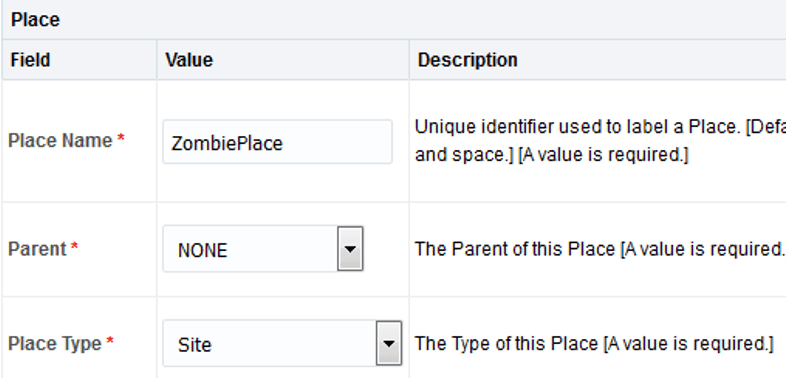

  1. In primary NOAM VIP GUI, configure places.
    1. Establish a GUI session on the NOAM by using the XMI VIP address. Login as the guiadmin user.
    2. Navigate to Configuration, and then Networking, and then Places.
    3. Click Insert.
    4. Fill in the fields as follows:
      Place
      Place Name:<Site Name>
      Parent: NONE
      Place Type: Site
    5. Repeat this step for each of the PCA or DCA Places (Sites) in the network.
      See the Terminology section for more information on Sites & Places.

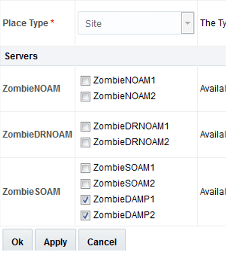

  2. In NOAM VIP GUI, assign MP server to places.
    1. Select the place configured in step 1 and click Edit.
      Edit place
    2. Mark all the checkboxes for PCA/DCA DA-MP and SBR servers that are assigned to this place.
    3. Repeat this step for all other DA-MP or SBR servers you wish to assign to places.
      All DA-MPs and SBR servers must be added to the Site Place that corresponds to the physical location of the server.

  1. In primary NOAM VIP GUI, enter MP Server Group Data applicable to all C level servers (DAMP, IPFE, VSTP, SBRs).
    2. Click Insert and fill out the following fields:
      Server Group Name:[Server Group Name]
      Level: C
      Parent: [SOAM Server Group That is Parent To this MP]
      Function: Select the Proper Function for this MP Server Group:
      Table 5-10 MP Server Group

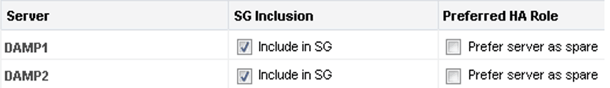

  3. In primary NOAM VIP GUI, edit the MP server groups to include MPs.
    1. Navigate to Configuration, and then Server Groups, select a server group that you just created, and click Edit.
    2. Select the network element representing the MP server group you wish to edit.
    3. Mark the Include in SG checkbox for every MP server you wish to include in this server group. Leave other checkboxes blank.
      SG
      Each IPFE and vSTP-MP server should be in its own server group.
    4. Click OK.
  4. In primary NOAM VIP GUI, edit the MP server group and add preferred spares for site redundancy. This is an optional step, applicable only to PCA.
    If two-site redundancy for the Policy and Charging SBR Server Group is wanted, add a MP server that is physically located in a separate site (location) to the server group by marking the Include in SG checkbox and also mark the Preferred Spare checkbox.
    SG
    If three-site redundancy for the SBR MP server group is wanted, add two SBR MP servers that are both physically located in separate sites (location) to the server group by marking the Include in SG and Preferred Spare checkboxes for both servers.
    • The preferred spare servers should be different sites from the original server. There should be servers from three separate sites (locations).
    • There must first be non-preferred spare present in the server group before adding the preferred spare.
    For more information about site redundancy for Policy and Charging SBR Server Groups, see the Terminology section.
    Click OK to save.

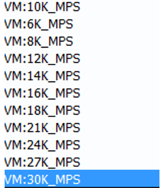

  7. In SOAM VIP GUI, assign profiles to DA-MPs from SOAM GUI.
    1. Log in to the GUI of the active SOAM server as the guiadmin user.
    2. From the SO GUI, navigate to Diameter Common, and then MPs, and then Profiles Assignments.
    3. For each MP, select the proper profile assignment based on the MP’s type and the function it serves:
      MP type
    4. When finished, click Assign.
