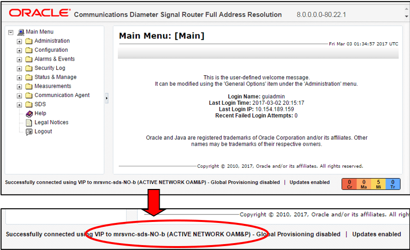

- Verify that the message shown across the bottom of the panel
indicates that the browser is using the VIP to
connect to the ACTIVE NETWORK
OAM&P.

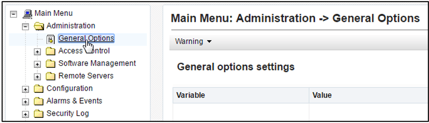

- Go to Main Menu, and then Administration, and then General Options.

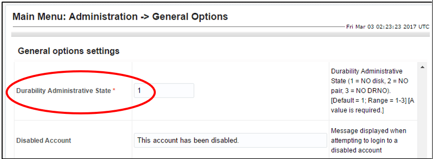

- Verify the value for Durability Administrative
State.If performing this procedure in response to a network isolated Primary NOAM (outage), modify the Durability Administrative State value to 1 (if necessary).

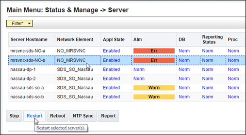

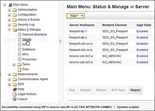

Click OK. - Go to Main Menu, and then Status & Manage, and then Server and identify the hostname of the Primary
Active NOAM server from the banner message at the bottom of
the browser window.
Based on the information recorded in this step, perform the next steps on the newly promoted Primary NOAM Active Server (Site_2). - Select the Server Hostname (highlighted once selected) and

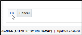

click Restart.
Click Ok, in the pop-up confirmation box.Note:
