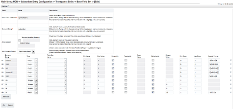

  5. From an active NOAM, add subscribers in UDR.
    1. Add the required fields for the EIR subscriber profile according to
      List Field name Type Value Range Default Value
      White List WL INT 0-1 1
      Gray List GL INT 0-1 0
      Black List BL INT 0-1 0
      Software Version SV INT 0-1 99
      The EIR profile fields should look similar to Figure 4-1.
      Figure 4-1 EIR Subscriber Screen
      img/eir-subscriber-screen.png
