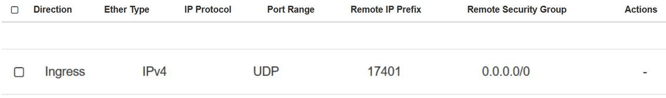

tcpdump -i eth1 -n "host <server-A>-imi or <server-B>-imi and port 17401 and udp"For example:
tcpdump -i eth1 -n "host noam00-17badf67-imi or noam01-17badf67-imi and port 17401 and udp" - If ping request or response packets are not coming
from any server, then add security group rule ingress (response) or egress (request)
to that instance.
The following image shows Ingress response:
Figure 23-1 Ingress Response
- Check the ping packets again after adding the rule
and ensure that
imirequest and response packets are received from each servers, by running the following command:tcpdump -i eth1 -n "<server-A>-imi or <server-B>-imi and port 17401 and udp" - Now restart the cmha process on the node where the
alarms are present, by running the following command:
pm.set off cmha && sleep 5 && pm.set on cmhaNote:
If the Node is HA Active, then restarting cmha will cause switch over.
