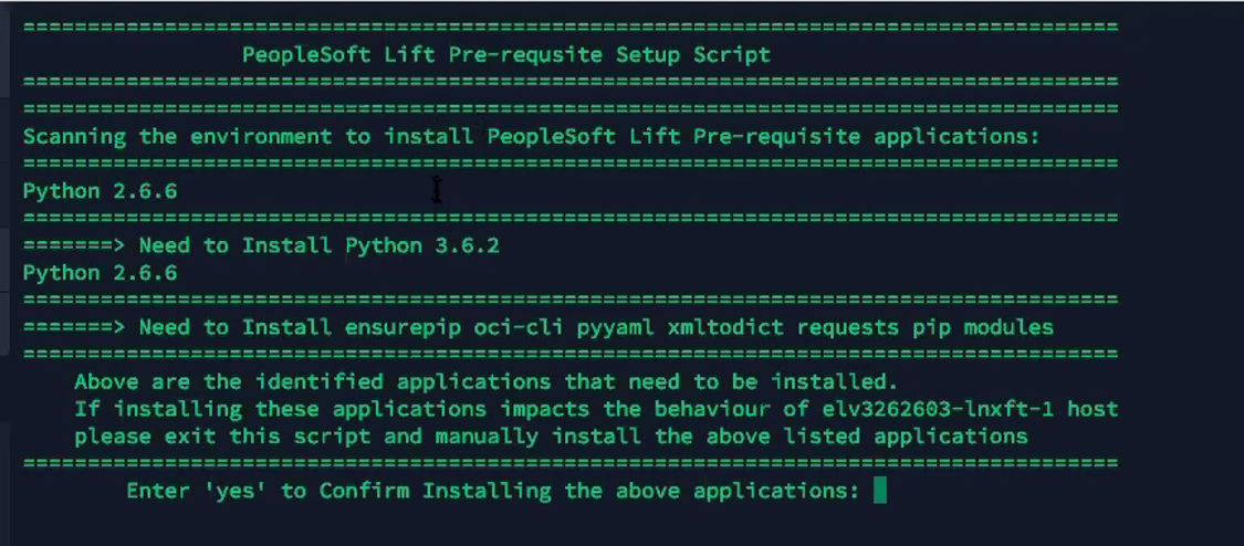

Application environment (answer no at above prompt)
The system will scan the environment and indicate the applications that need to be installed.

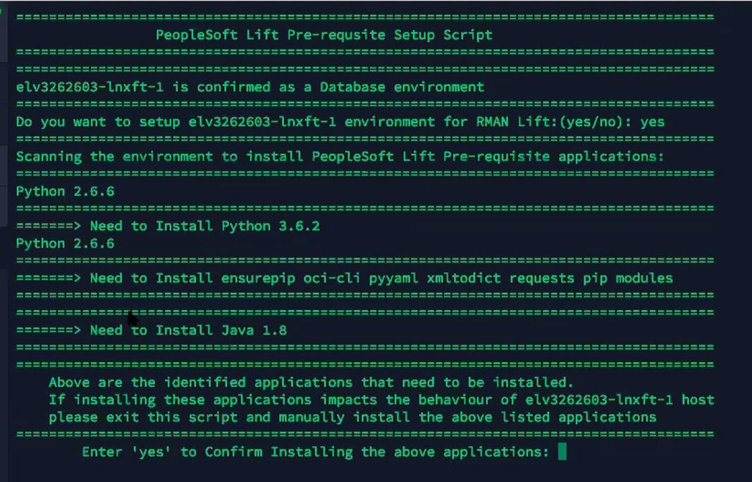

Database environment (answer yes at above prompt)
This example illustrates applications that are required for a database lift.
To confirm installing the applications, enter yes at the prompt.
Enter 'yes' to Confirm Installing the above applications:
Warning! If installing the applications impacts the behavior of your environment, then enter no. You will need to install the applications manually.
During installation of the prerequisite applications the utility will prompt for user confirmation, in order to continue installing certain dependencies. Not installing dependencies may result in Lift failure.

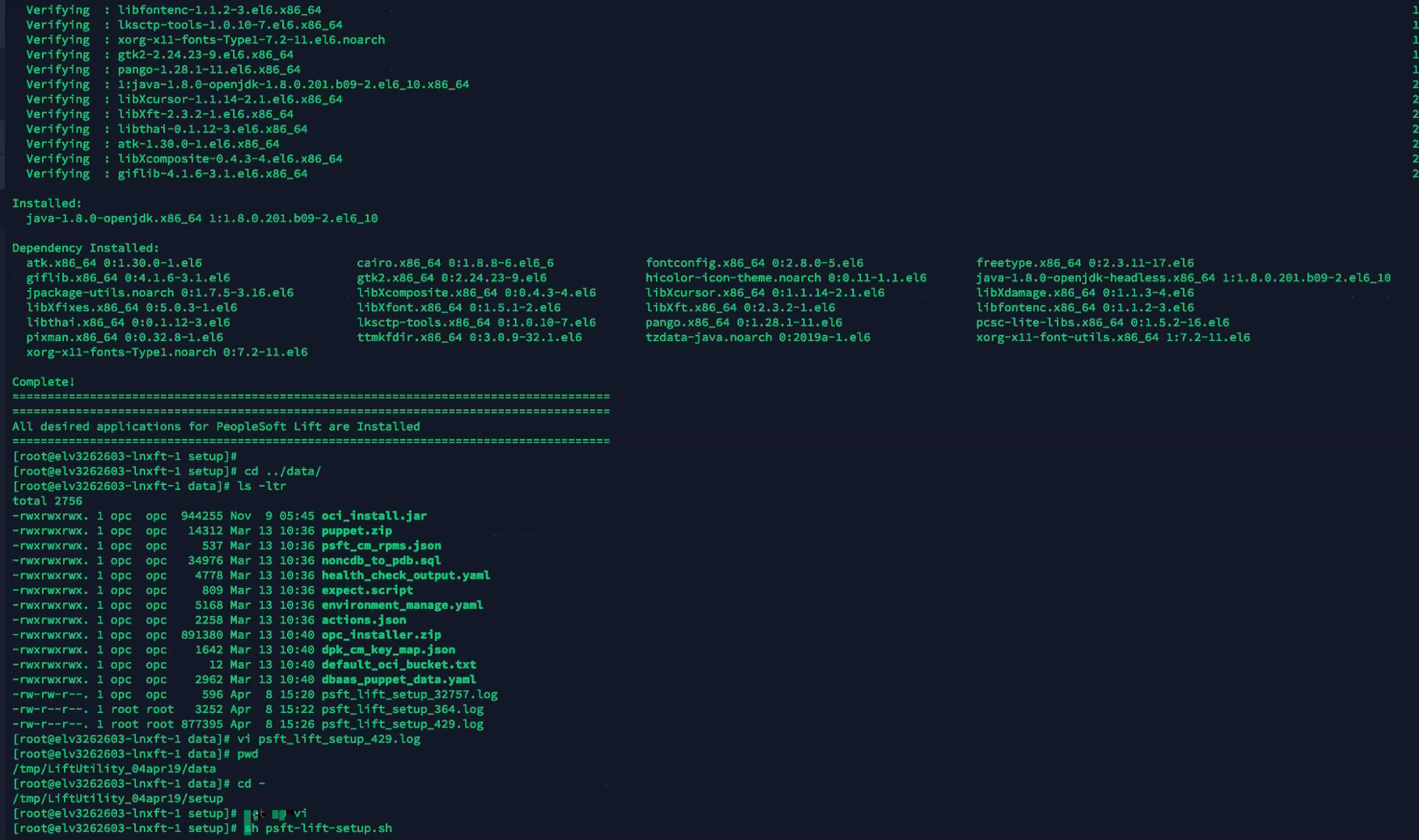

When all the applications are successfully installed, you will get a message “Complete!”.
This example illustrates all desired applications for PeopleSoft Lift are installed.
You can list the files and view the logs that were created for the install. The logs located at <Lift_Utility>/data/psft_lift_setup_<PID>.log
