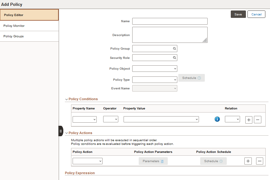

To add a policy:
Select the Orchestration Manager tile.
Click the Add Policy button.
Define and save the policy on the Policy Editor page.
This example illustrates the fields and controls on the Add Policy page.
Field or Control |
Description |
Name |
Enter a name for the policy. |
Description |
Enter a description for the policy. |
Policy Group |
Select an existing policy group. Policy groups are used to group policies together. The policy does not need to belong to a group. |
Security Role |
Select the security role that can edit the policy. |
Policy Type |
Select the policy type.
Schedule |
This button is available when the policy type is Schedule. Select to set the policy schedule. |
Policy Object |
A Policy object exposes properties and actions, which are used by the Policy editor to set policy conditions and action for the policy. Built-in policy objects are:
Event Name |
If Policy Type is Event and Policy Object is Environment, select one of these Event Names.
If Policy Type is Event and Policy Object is Repository Artifact, select one of these Event Names:
Policy Expression |
When you save a policy, this field displays a statement representing your choices. This field also displays error messages in case of incorrect choices. |

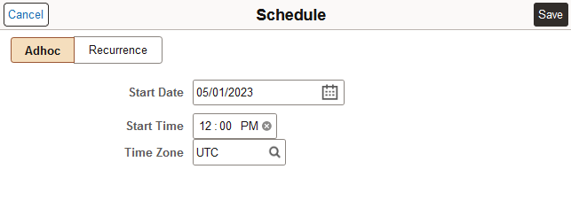

Adhoc
Select Adhoc if you want to schedule the policy for a specific data and time.
This example illustrates the fields and controls on the Schedule page for an Adhoc policy schedule.
Field or Control |
Description |
Start Date |
Select the start date. |
Start Time |
Enter the start time. |
Time Zone |
Select the time zone. |

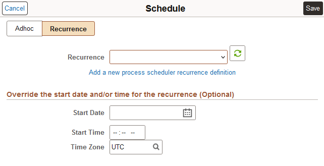

Recurrence
Select Recurrence if you want the policy to be run on a recurring schedule.
This example illustrates the fields and controls on the Schedule page for a Recurrence policy schedule.
Field or Control |
Description |
Recurrence |
Select an existing Process Scheduler recurrence schedule. |
Add a new process scheduler recurrence definition |
Select this link if you want to add a new recurrence definition. This link will open the Process Scheduler Recurrence Definition page. |
Start Date |
Optionally, you can enter a start date for this recurrence. |
Start Time |
Optionally, you can enter a start time for this recurrence. |
Time Zone |
Optionally, you can enter a time zone for this recurrence. |
See the product documentation PeopleTools: Process Scheduler, Defining Recurrence Definitions.

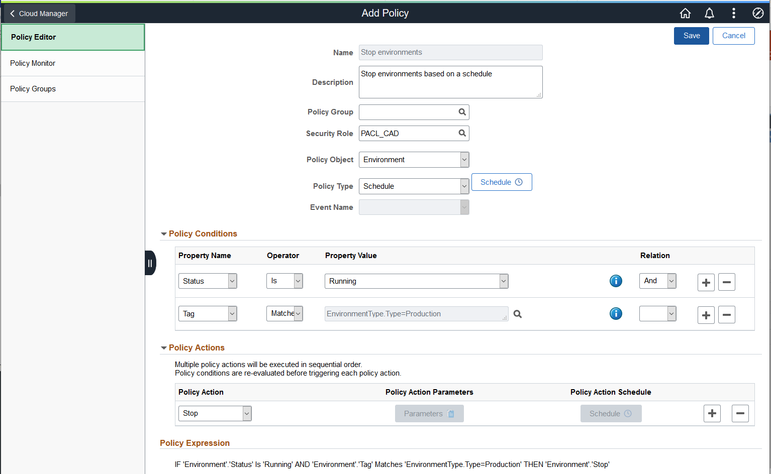

Environment policies can be based on a schedule or an event. Policies where the Policy Object is Environment, the Policy Type is Event, and the Event names are ScaleUp and ScaleDown, are used for auto scaling. See Setting Up Auto Scaling.
This example illustrates the fields and controls on the Add Policy page where the Object Type is Environment.

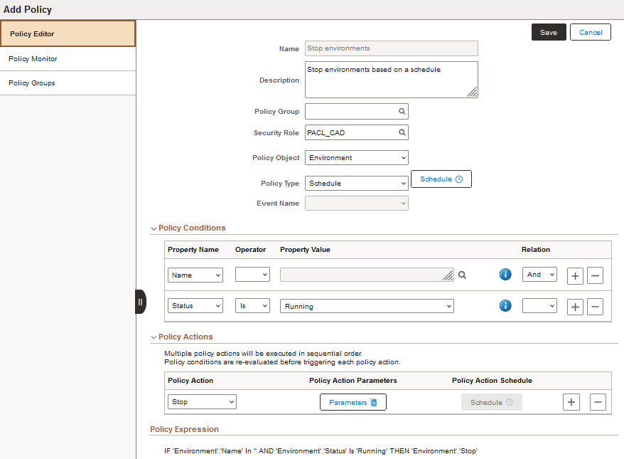

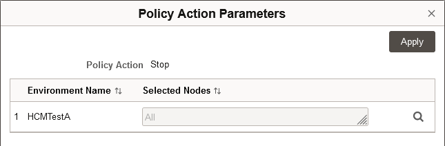

Starting and Stopping Individual Nodes
To apply the Start/Stop Policy Action on individual nodes from an environment:
Select Name as the first Property Name on the Policy Conditions section.
Select the Operator.
Select the environments where you want to start or stop individual nodes from Property Value drop-down.
Select Start or Stop from the Policy Action drop-down. Using the + button you can create multiple policy actions, which are run in sequence.
Note: To start a node, the environment that contains the node must be in Running state.
Click Parameters button on the Policy Action Parameters field. Policy Action Parameters dialog box appears. The environments you selected are listed.
Select the desired nodes from the listed environments. The default value is All on the Selected Nodes field. If you keep the default value, it becomes an environment start/stop policy action.
Click the lookup icon to select other nodes.
This example illustrates the fields and controls on Policy Action Parameters dialog box when Stop policy action is selected.
If the Policy Type is selected as Event, select the Policy Action Schedule to schedule the policy action.
Click Save. The policy for starting or stopping nodes is successfully added.

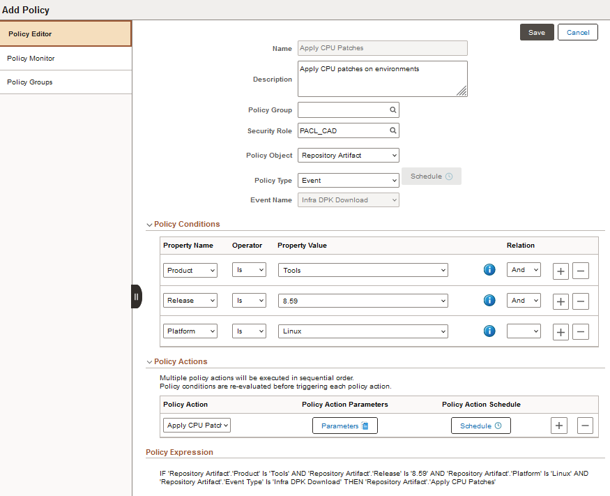

When you select Repository Artifact, the only Policy Type is Event. An event-based policy can be triggered by the event or the policy action can be scheduled for a specific time or recurrence.
Repository Artifact events are:
Patch Download
Infra DPK Download
PUM DPK Download
By default when you create a policy for a repository artifact, the policy is triggered when the artifact is downloaded. Use the scheduling option to delay running the event.
Important! You must not apply Infra DPK Download event-based policies directly. It is recommended to apply such policies by setting a schedule for the policy action.
Infrastructure DPK Download example:
You do not want to disrupt the environments during normal business hours when the download takes place.
Set a schedule to run the apply on the weekend.
If Infrastructure DPK gets downloaded in the middle of a week, CPU patches will be applied on the environments only during the weekend.
This example illustrates the fields and controls on the Add Policy page where the Object Type is Repository Artifact.

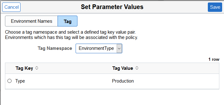

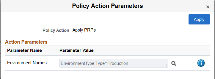

Setting Parameters When Selecting Environments for Policy Actions
The required parameters vary depending upon the Policy Actions. For actions such as Start, Stop, Apply PRP, or Apply CPU, you must select an environment for the policy to work on. To set the parameters:
Click the Parameters button for the Policy Action.
Click the Lookup icon.
You can select an environment based on Environment Name or Tag.
For an environment, click the Lookup icon and select the environment.
For a Tag, select a Tag Namespace from the drop-down list, and then select a tag.
This is an example of the Set Parameter Values page when Tag is selected.
Click Save.
The policy action parameter value is updated.
This is an example of the Policy Action Parameters page
Click Apply to save the parameters.

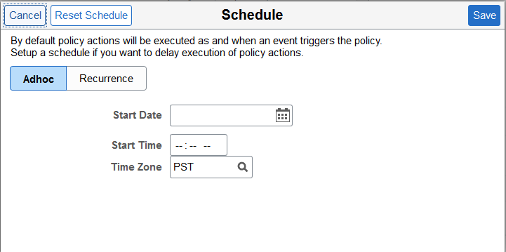

Scheduling Event Based Policy
Select the Schedule button to schedule the policy for a specific time or recurrence.
Setting a schedule for an event based policy is completely optional. By default an event based policy will run in real time as and when the event occurs. Add a schedule for an event based policy only when needed.
This example illustrates the fields and controls on the Schedule page.
Select Adhoc or Recurrence to schedule the policy. Use the Reset Schedule to reset the schedule.

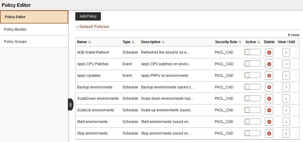

All defined policies are available and grouped by policy group.
You can edit the delivered default policies for your requirements and save them to a new name, or use them as examples to create new policies.
The Default Policies section shows policies that are not associated with a policy group.
This example illustrates the fields and controls on the Policy Editor page. You can find definitions for the fields and controls later on this page.
Field or Control |
Description |
Active |
Enable the switch to activate or inactivate a policy. When a policy is active the switch displays a check mark. Once a policy is inactivated, it will be suspended and will not be run. |
Delete |
Use the Delete icon to remove a policy. |
View/Edit |
Click the icon (>) to view or edit a policy. The user must belong to the security role assigned to the policy in order to edit the policy. If the user does not belong to the security role, the user can view the policy, but can not edit it. |
