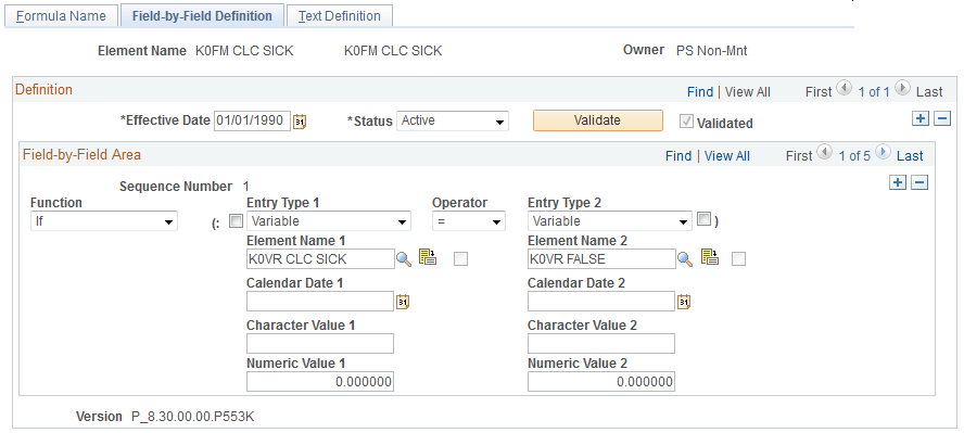

Use the Field-by-Field Definition page (GP_FORMULA2_V2) to define formulas for use in calculations.
View formula definitions.
Navigation:
This example illustrates the fields and controls on the Field-by-Field Definition page.
Building Your Formula
Build your formula in the Field-by-Field Area group box, specifying one operation or result in each row.

Example: Setting Up a Formula
Using the formula element, you can create elements using mathematical and logical operands, rules, and mathematical formulas.
In this example, you need a simple formula to forecast whether there is sufficient entitlement to cover an absence event. The requirements are as follows:
If the system element, DAY COUNT UNP (day count unpaid) is greater than zero, return a value of NOT ELIGIBLE.
Otherwise, return a value of ELIGIBLE.
Start by turning the calculation into a mathematical formula. In this example, K0FM PTO ELIGIBLE is the name of the formula that you are defining.
If DAY COUNT UNP > 0, then
'NOT ELIGIBLE' >> K0FM PTO ELIGIBLE
else
'ELIGIBLE' >> K0FM PTO ELIGIBLE
Endif
Formulas can often be expressed in multiple ways. To streamline processing, use the simplest version that requires the least processing.
After turning the calculation into a mathematical formula, you enter the formula into the system. If you haven't defined the element and entered the basic descriptions, do so on the Formula Name page. Then, on the Field-by-Field Definition page, define the formula, line by line.
This table shows how you enter your forecasting formula:
Sequence Number |
Function |
Entry Type 1 / Element 1 or value |
Operator |
Entry Type 2 / Element 1 or value |
Assign To Type/ Assign To Element |
1 |
If |
SystemElem /DAY COUNT UNP |
Numeric / 0 |
2 |
Then |
Character / NOT ELIGIBLE |
Formula / K0FM PTO ELIGIBLE |
3 |
Else |
Character / ELIGIBLE |
4 |
Endif |
Note: Every If statement must end with an Endif.
Each element name must be associated with an appropriate entry type. For example, on the first line, Element Name 1 (DAY COUNT UNP) is associated with the entry type System Element.

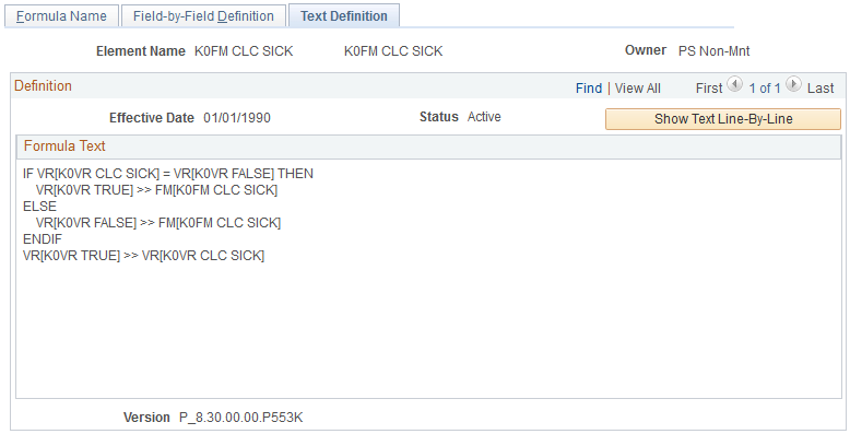

Use the Text Definition page (GP_FORMULA2_V2) to view your formula and confirm that it's correct.
Navigation:
This example illustrates the fields and controls on the Text Definition page.
Use the Text Definition page to view the formula that you created on the Formula - Field-by-Field Definition page. If something isn't correct, return to the Field-by-Field Definition page and adjust the formula.

Show Text Line-By-Line |
Click to view the text of the formula that you created on the Formula - Field-by-Field Definition page, as it was entered, line-by line. This view can be useful when troubleshooting a formula with errors. Any errors created by SaveEdit will be noted within the text as well as by an error message at the bottom of the page. Note: In the line-by-line view each line is prefixed by its row/line number and the error location is updated to reflect the number of the line displayed in the formula text. |
