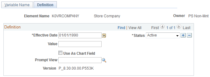

Use the Variables - Definition page (GP_VARIABLE) to define the value of a variable according to the format specified on the Variable Name page.
Navigation:
This example illustrates the fields and controls on the Variables - Definition page.
Field or Control |
Description |
Value |
Enter the value to assign to this variable. The type of value that you assign depends on the format type that you designated on the Variable Name page. |
