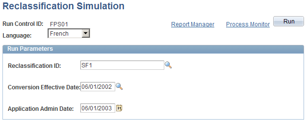

Use the Reclassification Simulation page (RUNCTL_FPA700) to run the reclassification simulation process.
Navigation:
This example illustrates the fields and controls on the Reclassification Simulation page. You can find definitions for the fields and controls later on this page.
Field or Control  |
Description  |
Reclassification ID  |
 Enter the reclassification ID to use for the process.  |
Conversion Effective Date  |
 Select the conversion effective date. The process compares the reclassification criteria against the employee's data on this date to determine whether to reclassify the employee.  |
Application Admin. Date (application administration date)  |
 Enter the application administration date. If an employee does not meet the reclassification criteria on the conversion effective date, the process checks to see if the employee meets the reclassification criteria by this date.  |
