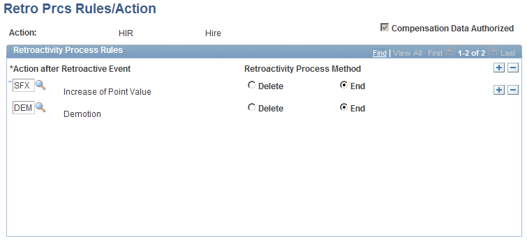

Use the Retro Prcs Rules/Action (retroactive process rules/action) page (FPMACTPRTY_PNL) to set up the system to delete an action or end the retroactivity process after a retroactive event.
Navigation:
This example illustrates the fields and controls on the Retro Prcs Rules/Action page. You can find definitions for the fields and controls later on this page.
When deleting retroactive events, the events to be deleted and the events that end the process are listed on a single action: the SUP Retroactive Delete action. This action uses a specific code to manage retroactive deletes so that one retroactivity process is applied to all deleted actions.

Field or Control  |
Description  |
Action  |
 The action that is inserted or deleted in the employee record that generates retroactivity.  |
Action after Retroactive Event  |
 Enter the action that is encountered in Career data with an effective date that is greater than the effective date of the retroactive event.  |
Retroactivity Process Method  |
 Define the retroactive process method for each action: Delete: The process deletes events that occur after the retroactive event but before the career reconstitution. These are principally step increment or reclassification actions that the system can restore. End: The event ends the retroactivity process and the career reconstitution without deleting the retroactive event. Select this option for events the system cannot restore, such as grade promotions. See Understanding Retroactivity in Manage French Public Sector.  |
