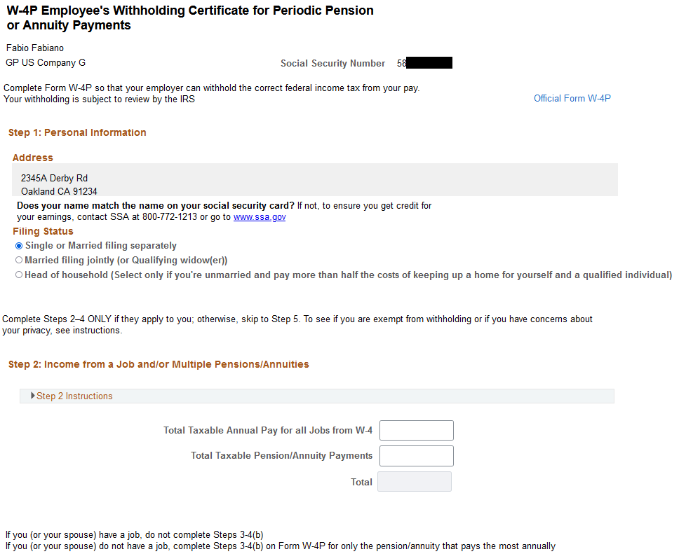

W-4P Employee's Withholding Certificate for Periodic Pension or Annuity Payments Page |
GPUS_W4_DATA |
Maintain W-4P tax information. |

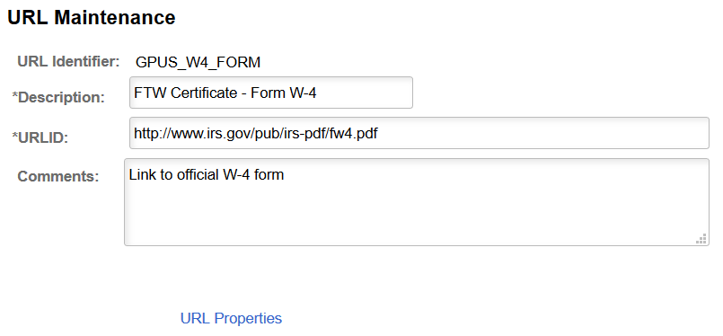

URL_TABLE |
Maintain the URLs for links that access official tax forms on third-party servers. |

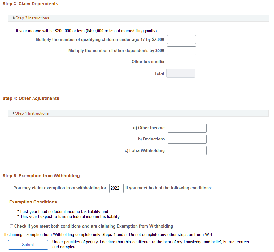

Global Payroll for United States supports these Form W-4 versions:
W-4 - 2020 or Later: For payees who are either hired, or wish to make withholding adjustments on or after January 1, 2020.
With Form W-4 (2020), allowances are no longer used to calculate federal income tax withholding.
W-4P - 2022 or Later: For payees (with the 1099-R tax report type selected on the Maintain Tax Profile USA Page) who are either hired, or wish to make withholding adjustments on or after January 1, 2022.
With Form W-4P (2022), Withholding Certificate for Periodic Pension or Annuity Payments, allowances are no longer used to calculate federal income tax withholding.
For payments made on or after January 1, 2022, payees should complete Form W-4P in order to have the correct amount of federal tax from periodic pension, annuity, profit-sharing and stock bonus plan, or individual retirement arrangement (IRA) payments.
W-4 - 2019 or Earlier: For payees who completed Form W-4 before year 2020 and do not wish to make changes.

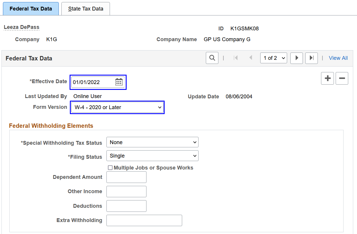

Example: Updating Federal and State Tax Data Effective 01/01/2022 or Later
In this example, a payee requests an update to the federal and state tax data, effective 01/01/2022. The payee is currently set up with federal form version W-4 - 2019 or Earlier.
To update the tax data for this payee, insert a new row effective 01/01/2022. In this row, change the federal form version to W-4 - 2020 or Later. Complete the other fields as indicated on the Form W-4 2020. Make the changes to the state tax page as needed.
This example displays the new Form W-4 version selection when updating the federal and state tax data for a payee on or after January 1, 2020 (January 1, 2022 in this example) on the Federal Tax Data page.

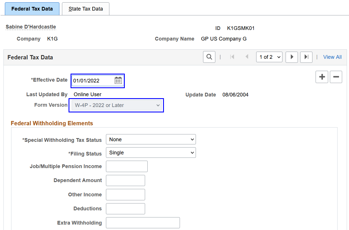

In this example, a payee with the 1099-R tax reporting type requests an update to the federal and state tax data, effective 01/01/2022. The payee is currently set up with federal form version W-4 - 2019 or Earlier.
To update the tax data for this payee, insert a new row effective 01/01/2022. In this row, the federal form version is set to W-4P - 2022 or Later automatically, which is the only applicable value. Complete the other fields as indicated on the Form W-4P 2022. Make the changes to the state tax page as needed.
This example displays the new Form W-4 version selection when updating the federal and state tax data for a payee on or after January 1, 2022 on the Federal Tax Data page.

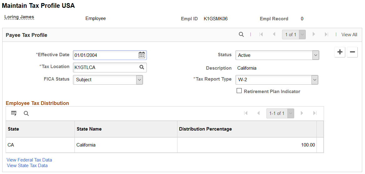

Use the Maintain Tax Profile USA page (GPUS_EE_TAX) to create and maintain payee tax profiles.
Navigation:
This example illustrates the fields and controls on the Maintain Tax Profile USA page.
Field or Control |
Description |
Tax Location |
Enter a tax location for the payee. The system populates the fields in the Employee Tax Distribution group box with the state and distribution percentage associated with the tax location that you select. If the payee belongs to a department with which you associated a tax location using the Department Table USA page, the system automatically populates this field. Note: When you save this page, the Federal and State Tax Data pages are populated. You can then access these pages to update or modify the data. See Department USA Page. |
FICA Status (Federal Insurance Contribution Act status) |
By default, the value of this field is based on the FICA Status Employee option selected on the Company Federal Tax Data USA page. You can override the default value by selecting: Subject: For payees subject to both OASDI and Medicare taxes. Exempt: For payees exempt from OASDI and Medicare taxes. Medicare Only: For payees subject to Medicare taxes only. |
Tax Report Type |
Select the report type that indicates which year-end form the system uses to report annual earnings and taxes. The system also uses this value to determine the Form W-4 version applicable to the payee. Specially, if the selected tax report type is W-2, both W-4 versions are available for selection when a new tax data row is added. If the selected tax report type is 1099-R, the W-4P version is used. |

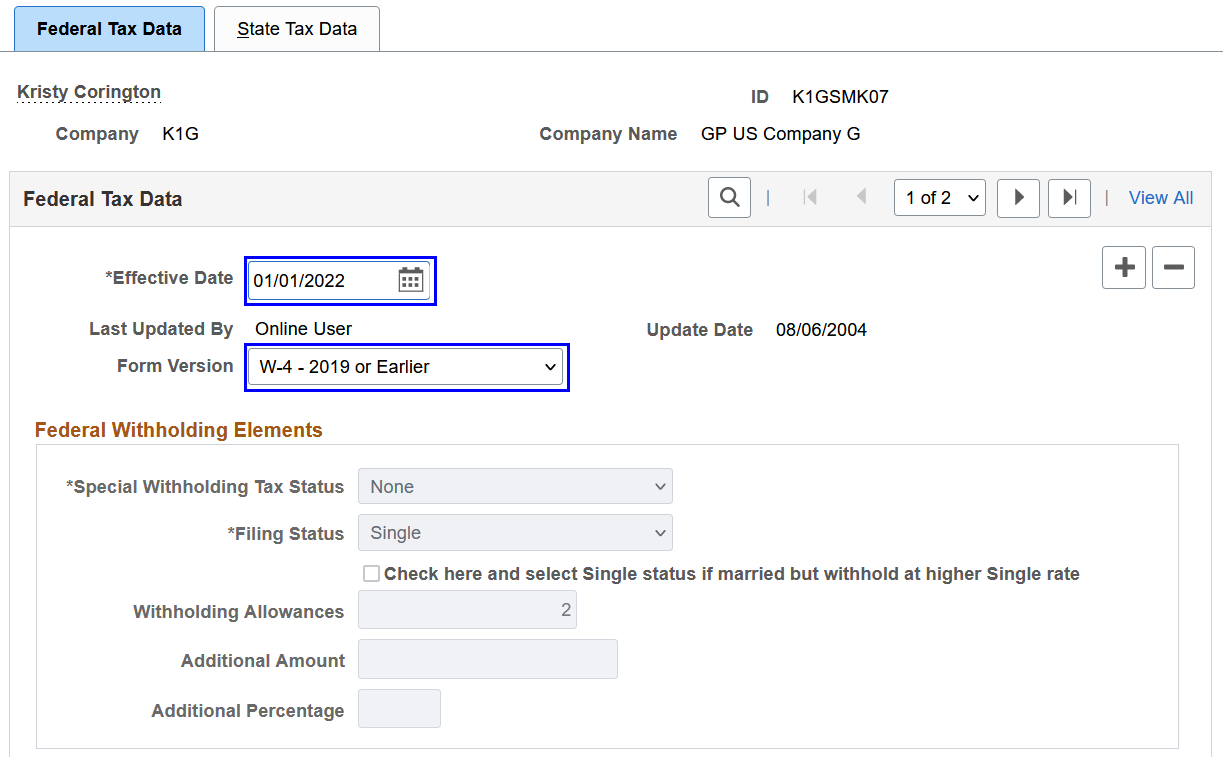

Use the Federal Tax Data page (GPUS_FWT_EE) to maintain federal tax information for individual payees.
Navigation:
This example illustrates the fields and controls on the Federal Tax Data page (1 of 2).
This example illustrates the fields and controls on the Federal Tax Data page (2 of 2).
Field or Control |
Description |
Effective Date |
Note that the effective date on the Federal Tax Data page is not used to calculate federal income tax withholding. For example, a payee submitted a state W-4 that added a new row to employee tax data in 2020, but did not fill out a new Form W-4 for 2020 (no changes on the Federal Tax Data page for the same row). In this scenario, the system uses the old formula for 2019 to calculate federal income tax withholding. If you wish to use the W-4 version for 2020 or later, enter an effective date that is on or after January 1, 2020, and select the W-4 - 2020 or Later version of Form W-4. |
Last Updated By and Update Date |
Indicates whether the payee’s federal tax data was last updated by an online system user, or by the payee in Employee Self-Service. The date of the most recent update appears. |
Form Version
Select the appropriate Form W-4 version in the Form Version field. The system determines the federal tax calculation to use to calculate the payee’s federal income tax withholding based on the version you select.
Field or Control |
Description |
W-4 - 2020 or Later |
Select (or displays as the only available value) when creating or inserting an employee tax data record that will include new or changed federal tax data from Federal Form W-4. The system calculates tax based on the Form W-4 2020 elections. This option became effective as of 01/01/2020. |
W-4 - 2019 or Earlier |
Leave this option unchanged (if it already exists) when creating or inserting an employee tax data record that will include only new or changed state tax data for a payee who has not yet submitted Federal Form W-4 for tax year 2020 or later (or Form W-4P for tax year 2022 or later). The system calculates tax based on the prior Form W-4, in which allowances are part of the calculation. |
W-4P - 2022 or Later |
Displays as the only value when creating or inserting an employee tax data record that will include new or changed federal tax data from Federal Form W-4P. Effective on or after 01/01/2022, this is the only option applicable to payees with the 1099-R tax report type. |

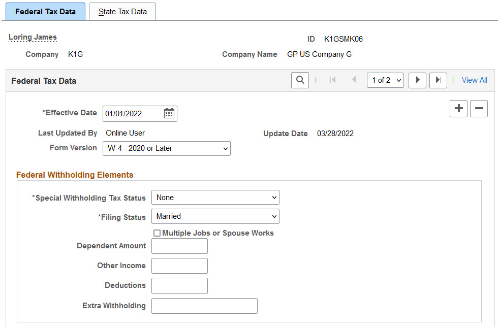

Federal Withholding Elements
Field or Control |
Description |
Special Withholding Tax Status |
Specify the payee’s special withholding tax status. The system calculates the withholding tax based on the value you select here and other factors.
Filing Status |
Select the appropriate tax status for federal withholding taxes (FWT) as indicated on the payee's completed Form W-4 or Form W-4P in line 1(c). Values are: Head of Household. This value appears when W-4 - 2020 or Later or W-4P - 2022 or Later is selected. Married Single The selected filing status cannot change when a lock-in letter is on file. |
These fields appear when either the W-4 - 2020 or Later or W-4P - 2022 or Later option is selected.
Field or Control |
Description |
Multiple Jobs or Spouse Works |
Select if the check box in line 2 (c) of the payee’s Form W-4 is selected. This field appears for form version W-4 - 2020 or Later. It becomes editable when the Special Withholding Tax Status field is set to None. The system selects this field automatically when a lock-in letter is on file and the withholding rate is Higher withholding rate. Do not clear this field unless you select Standard withholding rate. |
Job/Multiple Pension Income |
Enter the total job and multiple pension income amount in line 2(b)(iii) of the payee's Form W-4P. It can be a positive or negative amount. This field appears for form version W-4P - 2022 or Later. |
Dependent Amount |
Enter the dependent amount in line 3 of the payee’s Form W-4 or Form W-4P. The line 3 amount may include other tax credits indicated by the payee. This field becomes editable when the Special Withholding Tax Status field is set to None. When a lock-in letter is on file, the dependent amount can only be equal to or less than the value in the Annual Withholding Reductions field (lock-in letter). |
Other Income |
Enter the other income amount in line 4(a) of the payee’s Form W-4 or Form W-4P. This field becomes editable when the Special Withholding Tax Status field is set to None. When a lock-in letter is on file, the other income amount can only be equal to or greater than the value in the Other Income field (lock-in letter). |
Deductions |
Enter the deduction amount in line 4(b) of the payee’s Form W-4 or Form W-4P. This field becomes editable when the Special Withholding Tax Status field is set to None. When a lock-in letter is on file, the deductions amount can only be equal to or less than the value in the Deductions field (lock-in letter). |
Extra Withholding |
Enter the extra withholding amount in line 4(c) of the payee’s Form W-4 or Form W-4P. This field becomes editable when the Special Withholding Tax Status field is not set to No taxable gross; no tax taken. Leave the amount as $0 if the selected special withholding tax status is Maintain taxable gross; no FWT. If federal income tax should not be withheld, do not enter an amount for extra withholding. When a lock-in letter is on file, the extra withholding amount can only be equal to or greater than the value in the Additional Amount field (lock-in letter). |

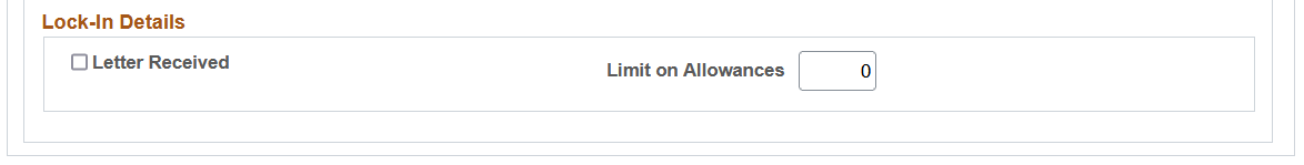

Lock-In Details
Use the Lock-In Details group box to process lock-in letters from the IRS that limit employee withholding allowances.
This section does not apply to the W-4P - 2022 or Later form version.
Field or Control |
Description |
Letter Received |
Select this check box if a letter has been received from the Internal Revenue Service (IRS) specifying the allowances a payee is allowed to take. When selected, the system generates a message, stating that the Lock-in Letter Received status will be set to Y for the current row and all other federal data rows with a higher effective date than the current row. When the W-4 - 2020 or Later option is selected, the system generates another message, indicating that federal withholding elements will be changed to the values specified in the Lock-in Details section. |
This field appears when the W-4 - 2019 or Earlier option is selected.
Field or Control |
Description |
Limit On Allowances |
Enter the maximum number of allowances possible. The value that you enter in the Withholding Allowances field cannot exceed the value that you enter in this field. |
These fields appear when both the W-4 - 2020 or Later and Letter Received options are selected.
Use these fields to specify the withholding status, withholding rate and any annual reductions to withholding or additional amount to withhold per pay period. These values will be available in the lock-in letters to employers.
Federal withholding elements will be changed to the values specified in these fields.

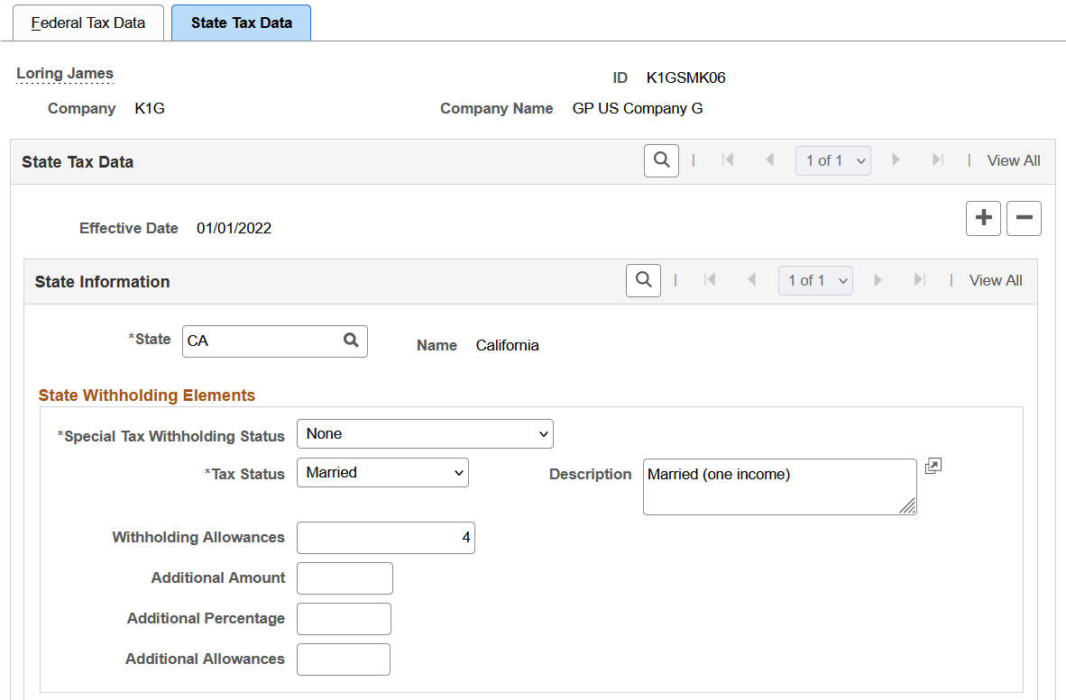

Use the State Tax Data page (GPUS_SWT_EE) to maintain state tax information for individual payees.
Navigation:
This example illustrates the fields and controls on the State Tax Data page.
This example illustrates the fields and controls on the State Tax Data page (2 of 2).
State Information
Field or Control |
Description |
State |
Enter the state for which you are entering tax data. Normally, the system populates this field automatically based on the tax location selected on the Payee Tax Profile page. |
Colorado-Specific Page Element
Field or Control |
Description |
Form DR 0004 Received |
Select if the payee submitted Form DR 0004. When selected, the Annual Allowance Based On field appears, and these fields become unavailable for edit: Special Tax Withholding Status (set to None), Tax Status (set to N/A), and Description (set to Not Applicable). |
Oregon-Specific Page Element
Field or Control |
Description |
Do not withhold Oregon Statewide Transit Tax |
Select this check box if you do not wish to withhold Oregon Statewide Transit Tax from payments that are made to the payee. For example, if the payee is an Oregon resident who works outside of the state, the out-of-state employer can, as a courtesy, withhold transit tax for the payee but it is not required. If the withholding is disabled, it is the payee's responsibility to pay the tax while filing for personal income tax return. Note: Retirees are exempted from the Oregon Statewide Transit Tax. No tax will be withheld from payments to individuals with the 1099-R tax report type selected on the Maintain Tax Profile USA Page. |
State Withholding Elements
Use these fields to enter state-specific withholding information.
Field or Control |
Description |
Special Tax Withholding Status |
None. Select if the payee has no special tax status. With this option, the system calculates SWT based on the payee's taxable gross, marital status, and withholding allowances. If you select this option and specify an additional amount or percentage, the system calculates taxes based on the information in the tax table and withholds the additional withholding amount indicated. No taxable gross; no tax taken. Select to disable the tracking of state taxable gross balance for the payee. Maintain taxable gross; no SWT. Select to override the normal tax calculation with the additional amount or percentage indicated. The system determines taxable gross for SWT using the individual earnings paid to the payee. The tax withheld becomes either a flat amount or a percentage of the state taxable wages. |
Tax Status and Description |
Select the appropriate tax status for SWT. The description for the status is displayed after the selection. Note: This field is has a value of N/A (not applicable) for states that do not use marital status for tax calculation. |
Withholding Allowances |
Enter the number of allowances that the payee claims for SWT. This number should match the number on the payee's state withholding allowance certificate. This field applies to many but not all states. |
Additional Amount |
Enter an additional flat amount to withhold. The effect of this field depends on the option that you select in the Special Tax Withholding Status field. |
Additional Percentage |
Enter an additional percentage to withhold. The system calculates the additional withholding using a percentage of the payee's taxable wages. |
Additional Allowances |
(CA, IL, IN, GA, PR, and VA) Enter any additional allowance that the payee claims for SWT. (VA) This field is applicable if the specified tax status is not 65/Blind. |
Arizona-Specific Page Element
Field or Control |
Description |
Withholding Percent |
Enter the percentage of taxable gross that constitutes the Arizona state withholding. |

Lock-In Details
Field or Control |
Description |
Letter Received |
Select if you received a letter from the state taxing authority that specifies the number of allowances that the payee can claim. |
Limit on Allowances |
Enter the maximum number of allowances that the payee can claim. The value that you enter in the Withholding Allowances field is not allowed to exceed this number. |
Use the W-4 Employee's Withholding Certificate page (GPUS_W4_DATA) to maintain W-4 tax information.
Navigation:
This example illustrates the fields and controls on the W-4 Employee's Withholding Certificate page (1 of 2).
This example illustrates the fields and controls on the W-4 Employee's Withholding Certificate page (2 of 2).
This self-service page enables payees to update their Federal W-4 tax information. They can change their filing status, dependents, other income, and other current elections. If they want to view or print a copy of the official Form W-4, they can select the Official Form W-4 link to access the form in PDF format. They may also access the official Social Security website.
Note: Both links go to a third-party server. Therefore, you must use the URL Maintenance Page to update the link periodically to make sure it is still valid.
Use the W-4P Employee's Withholding Certificate for Periodic Pension or Annuity Payments page (GPUS_W4_DATA) to maintain W-4P tax information.
Navigation:
This example illustrates the fields and controls on the W-4P Employee's Withholding Certificate for Periodic Pension or Annuity Payments page (1 of 2).
This example illustrates the fields and controls on the W-4P Employee's Withholding Certificate for Periodic Pension or Annuity Payments page (2 of 2).
This self-service page enables payees with the 1099-R tax report type to update their Federal W-4P tax information. They can change their filing status, dependents, other income, and other current elections. If they want to view or print a copy of the official Form W-4P, they can select the Official Form W-4P link to access the form in PDF format. They may also access the official Social Security website.
Use the URL Maintenance page (URL_TABLE) to maintain the URLs for links that access official tax forms on third-party servers.
Navigation:
This example illustrates the fields and controls on the URL Maintenance page.
Use this page to maintain the URL accessed by the Official Form W-4 link on the W-4 Tax Information self-service page. The URL identifier for the link is GPUS_W4_FORM. Make changes to the URL field to update the link.
