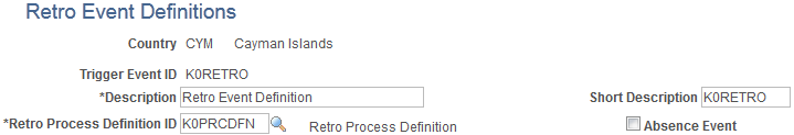

Map retro processes to trigger event IDs.
Use the Retro Event Definition page to associate the retro process you defined in step 2 with a trigger event ID. The event ID tells the system how to process data changes to the records or fields you make sensitive to retroactive data changes in step 5 (see below).

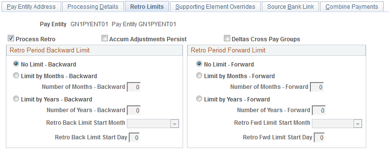

Determine which pay entities allow retroactive processing.

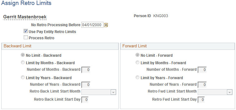

Use the Pay Entity Retro Limits page to enable retroactive processing of calendars in a pay entity.
Specify backward and forward limits.
There are two pages on which you can set backward and forward limits:
Use the Pay Entity Retro Limits page to establish default backward and forward limits for retro processing (optional). This tells the system how far back in time to go to recalculate closed calendars that are associated with a pay entity, and how long after a payee becomes inactive he/she is eligible for retro processing.
If necessary, override the default backward and forward limits for specific payees using the Assign Retro Limits page.

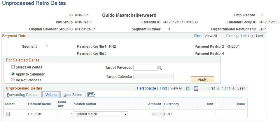

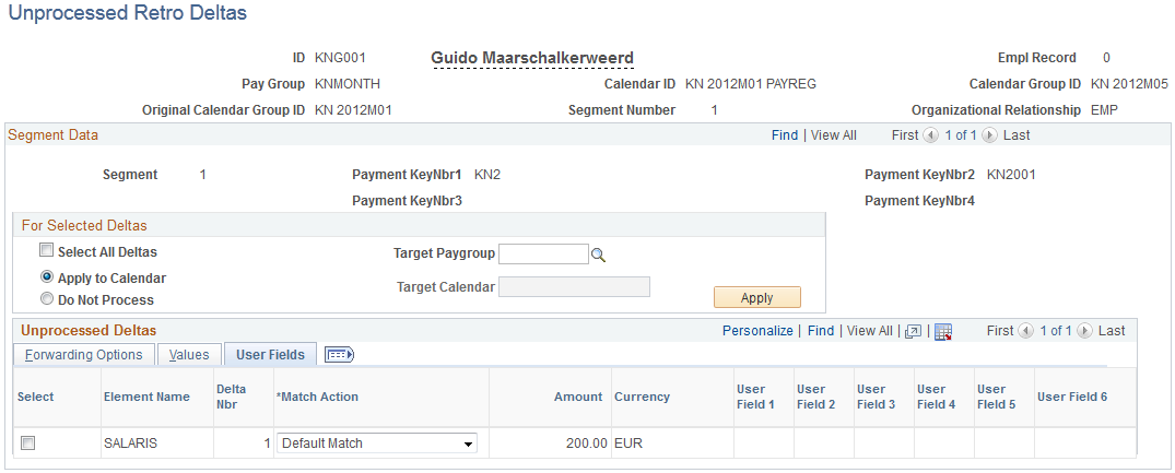

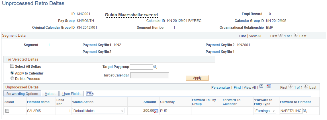

Manage unprocessed retro deltas.
During forwarding retro—or when using corrective retro with forwarding exceptions—the system forwards deltas from the recalculated calendar as adjustments to the current calendar when certain conditions (matching criteria) have been met. If forwarded retro deltas cannot be processed because the default matching criteria are not met, you can manually direct the deltas to an appropriate calendar by using the Unprocessed Retro Deltas page.

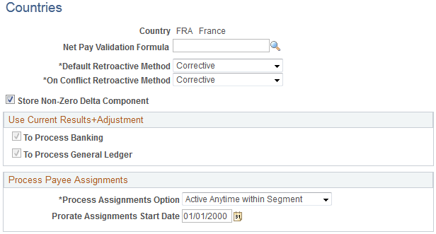

Use the Countries page (GP_COUNTRY) to define a default retro method at the country level.
Navigation:
This example illustrates the fields and controls on the Countries page.
See Countries Page.
Selecting the Corrective Method for Default Retroactive Processing
If you select Corrective as the Default Retroactive Method, the system completes the following steps when retroactive processing occurs:
The system recalculates the elements of the pay run that are defined to be recalculated during retroactive processing.
Recalculated values for the elements of the pay run replace the previous calculations.
The system updates balance and segment accumulators in the recalculated period.
The system computes retro deltas and stores them in the recalculated period.
The system computes the retroactive adjustment for elements of the pay run that are defined as forwarding element overrides (on the Retroactive Process Overrides page).
The banking process determines if any differences exist between the net pay from the prior calculation and the recalculation. Banking processes the differences.
The system executes a full reversal of the prior calculation results and posts the recalculated results to General Ledger.

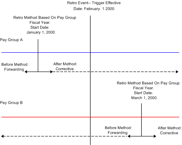

Understanding the On Conflict Retro Method
Retro conflicts occur when the system receives contradictory instructions about how to process retro. This can occur when:
An employee is associated with more than one pay group or pay entity.
The retro Method Based On dates defined for these pay groups or pay entities call for different retro methods to be used to process different calendars with the same period ID during the same calculation period.
For example, imagine that you assign an employee to Pay Group A. The fiscal year (the retro Method Based On date) begins on January 1, 2000. For the same employee in Pay Group B, the fiscal year begins on 1 March 2000. Assume that a retro event reported in March causes the February pay period to be recalculated and that the method you've defined for processing this event varies by Pay Group Fiscal Year (in both pay groups the Before Method is Forwarding and the After Method is Corrective).
This graphic shows an example of the on conflict retro method.
To recalculate the February pay period, Pay Group A uses corrective retro, while Pay Group B uses forwarding retro. The same event calls for the use of conflicting retro methods for processing the same period, even though the process definition is the same (the method is forwarding before the Pay Group Fiscal Year and corrective after the Pay Group Fiscal Year). To avoid this conflict, select a retro conflict method on the Countries page.
Note: The system creates a Pay Process Stat record for each payee for each calendar, including retro. When you specify a retro conflict method, you ensure that consecutive Pay Process Stat records with the same period ID are processed using a single retro method.

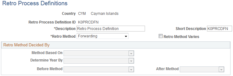

Use the Retro Process Definition page (GP_RTO_PRC_DEFN) to define a retro process.
Navigation:
This example illustrates the fields and controls on the Retro Process Definition page.
Field or Control |
Description |
Retro Process Definition ID (retroactive process definition ID) |
Identifies the retro process you are defining. |
Retro Method |
The value of this field defaults from the Countries page. You can override it. |

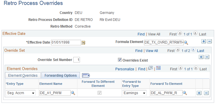

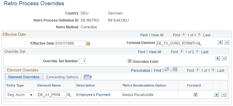

Use the Retro Process Overrides page (GP_RTO_OVR_DEFN) to .
Specify the elements that are to be forwarded when the standard retro method is forwarding.
Define overrides to the standard corrective retro method.
Override the Retro Recalculation Option defined on the earning and deduction definition pages.
Navigation:
This example illustrates the fields and controls on the Retro Process Overrides.
Understanding Rules for Forwarding Elements and Defining Overrides to Corrective Retro
If your retro method is forwarding, you must individually select elements to be forwarded on the Retro Process Overrides page. Global Payroll does not assume that every element in a process list should be forwarded—even when the retro method is forwarding.
If your default method is corrective, but you want certain elements to be forwarded, you must specify the elements you want forwarded on the Retro Process Overrides page.
Defining Elements to Be Forwarded (when the retro method is forwarding):
If your default retro method is forwarding:
Specify each element that is to be forwarded (on the Retro Process Overrides page).
The only types of elements that can be forwarded are earnings, deductions and accumulators. (Only deltas from segment accumulators can be forwarded.)
If an element is an earning or a deduction, you can either forward the value of the element's retro delta to the same element, or define a separate "Forward To Element" to receive this value.
When you forward the delta for an earning, the "Forward To Element" can be an earning or a deduction.
When you forward the delta for a deduction, the "Forward To Element" can be an earning or a deduction.
If you forward a segment accumulator, you cannot forward it to the same element (or even a different accumulator) because a segment accumulator can be forwarded only to an earning or a deduction.
If the forwarded element contains components and is forwarded to a different element, the component adjustments will be applied only if the "Forward To Element" calculation rule is the same. For example, if the element is defined as Percent of Base and the "Forward To Element" is defined as a Percent of Base, then the differences for the amount and the base are forwarded. If the "Forward To Element" does not obey the same rule, then only the adjustment amount is forwarded.
Note: With forwarding retro, you can define balance accumulators to behave in a corrective manner at the accumulator definition level and on the Earning/Deduction Accumulators pages.
Defining Overrides to Corrective Retro:
If your default retro method is corrective, but you want to forward the delta for a specific element (that is, you want to override the default method for this element):
You must forward the retro delta to a different element by designating a "Forward To Element" on the Retro Process Overrides page. This element receives the value of the element's retro delta in the current period. However, you must have already defined the element on one of the element definition pages.
Note: You cannot forward a retro delta to the same element if your method is corrective.
When you are forwarding the delta for either an earning or a deduction, the "Forward To Element" can be either an earning or a deduction.
When you are forwarding the delta for an accumulator (only segment accumulators can be forwarded), the "Forward To Element" must be an earning or a deduction (it cannot be another accumulator).
If the forwarded element contains components and is forwarded to a different element, the component adjustments are applied only if the "Forward To Element" calculation rule is the same. For example, if both the element and the "Forward To Element" are defined as Percent of Base, then the differences for the amount and the base are forwarded. If the "Forward To Element" does not follow the same rule, then only the adjustment amount is forwarded.
If you forward the Net Pay element, banking will not reverse the net pay element from the prior calculation, nor will it insert the new recalculated net pay entry.

Element Overrides
Select the Retro Process Overrides - Element Overrides tab.
Field or Control |
Description |
Entry Type |
Enter the type of element for which you want to override the default retro method. Values are: Deduction Earnings Seg. Accm (segment accumulator): Only segment accumulators are listed in the Element Name column. |
Element Name |
Select the elements for which you want to define overrides. The elements listed are those that you defined on the earning and deduction definition pages. |
Retro Recalculation Option |
Indicate whether you want the element to be recalculated during retroactive processing. Values are: Always Recalculate: Recalculates the element during retro. Do Not Recalculate: Does not recalculate the element during retro. Use Element Definition (the default): Tells the system to go to the element definition to determine whether to recalculate the element. |
Forward |
This check box is selected if your method is forwarding, and you enter elements for forwarding in the Entry Type and Element Name fields. The forwarded element is forwarded to itself unless you select the Forward to Different Element check box. This check box is also selected for segment accumulators and cannot be changed. (Segment accumulators must be forwarded to a different earning or deduction.) |
Forwarding Options
Select the Retro Process Overrides - Forwarding Options tab.
This example illustrates the fields and controls on the Retro Process Overrides - Forwarding Options tab.
Field or Control |
Description |
Forward to Different Element |
Select to forward the value of an element to a different element in the current period.
Forward to Entry Type |
This is the type of element that is to receive the value of the original element in the current period when you select Forward to Different Element. Values are Deduction and Earnings. |
Forward to Element |
Select the name of the "Forwarded To" element that will receive the value of the original element. |
Example: Corrective Retro—with Forwarding Exceptions
Scenario:
Earning 1 rate changes from 10 to 12; effective date in period 1; notified in period 2.
Deduction 1 is defined not to be recalculated during retro processing.
Segment accumulator for Earning 1 + Earning 2 is forwarded to Earning 2 in the current period.
Additional element definitions:
Earning 1 = Hours worked × Pay Rate.
Deduction 1 = 10% of Segment Accumulator.
Deduction 2 = 20% of Earning 1.
Segment Accumulator = Earning 1 + Earning 2.

Use the Retro Event Definition page (GP_RTO_EVT) to associate a triggering event (a change in critical data) with one of the processes that you defined on the Retro Process Definition page.
Navigation:
This example illustrates the fields and controls on the Retro Event Definition page.
The mechanism that is used to track online data changes that should trigger retroactive processing is called a trigger. In Global Payroll, you set up triggers by identifying the records and fields that should trigger retroactive processing in response to data changes, and by defining the retro process definition to use to process these changes:
On the Retro Event Definition page, associate each of the retro processes defined on the Retro Process Definition page with a trigger event ID.
On the Trigger Definitions page, identify the records and fields that should trigger retroactive processing when data is modified or updated retroactively.
On the Trigger Definitions and Trigger Definitions - Field Values pages, associate the records and fields identified in step 2 with one of the trigger event IDs you defined in step 1. Because each ID is linked to a process definition, the system can automatically apply the correct retro process when one of these records of fields is modified or updated.
Note: Because the Trigger Definitions and Trigger Definitions - Field Values pages are documented in the topic "Setting Up Triggers," this topic describes only the use of the Retro Event Definition page.
See Setting Up Trigger Definitions.
Field or Control |
Description |
Country |
This display-only field is populated based on the country that you selected on the search page. |
Trigger Event ID |
This display-only field is populated based on the trigger event ID that you selected on the search page. Link each trigger event ID to one of the processes you defined on the Retro Process Definition page. |
Retro Process Definition ID |
Select a process that you defined on the Retro Process Definition page to link to the trigger event ID. Note: Different countries can process the same event differently. |
Absence Event |
Select to avoid processing calendars unnecessarily when the trigger event ID is for an absence event only. When you select this option, processing starts with the first absence calendar that qualifies after checking retro limits and ignores the initial payroll calendar. For example, suppose that company A runs the payroll process once a month using a calendar group composed of two calendars. The first calendar is for payroll, and the second one is for absence. This order is always maintained. Assume that the month of January has been processed. The payroll calendar is processed for January, while the absence calendar is processed in January to feed the February payroll calendar. The current period is February. Changes are made to January absence data. The system generates retro triggers for absence back to January that point to a retro event ID for which the Absence Event indicator is set to yes. When the payroll is processed for February, retroactive processing goes back to January. The first and only calendar that is recalculated is the absence calendar. The payroll calendar is ignored for retro processing. Note: Absence balance accumulators should always be updated (replaced) at the end of each payroll calculation period. This means that when the default method is forwarding, you must define the absence balance accumulator behavior as "Use Corrective" when you set up accumulators on the accumulator definition pages. Note: The effect of selecting this check box depends on the processing order of the calendars for a particular period, the relationship between absence and payroll calendars, and which absence related trigger definitions you are using as well as the retro events they point to. |
Use the Retro Limits page (GP_PYENT_RETRO) to .
Define the backward and forward limits for retro processing at the pay entity level.
Override pay group matching criteria for unprocessed retro deltas.
Enable the retention of accumulator balances during retro processing.
Navigation:
This example illustrates the fields and controls on the Retro Limits page.
After you have defined a retro method and the events that trigger retro processing, you must specify the backward and forward limits for retro processing at the pay entity level. This tells the system how far back in time to go to recalculate closed calendars, and how long a payee is eligible for retroactive processing after being inactivated or terminated.
Note: You can override backward and forward limits you define at the pay entity level using the Pay Entities - Retro Limits Assignment page at the payee level.
Retro Period Backward Limit
Use the fields in this group box to limit the number of calendar periods that Global Payroll can reprocess going into the past.
To determine how far back to go, the system compares the backward limit defined on the Retro Limits page to the retro trigger effective date. If the trigger effective date comes before the backward limit date, the system uses the backward limit date to determine the first retro period. If the backward limit date comes before the trigger effective date, the system uses the trigger date to determine the first retro period to process.
Field or Control |
Description |
Process Retro |
Select to enable retroactive processing at the pay entity level. You can override your selection at the payee level. |
Accum Adjustments Persist(accumulator adjustments persist) |
Select to retain adjustments to accumulator balances when retroactive processing causes an accumulator to be recalculated in a prior period. This option may be needed because Global Payroll does not automatically include adjustment amounts when recalculating accumulator balances. For example, if you select this check box and reprocess a prior period in which an accumulator with a value of 1000 received an adjustment of 100, the system computes the incoming balance as the sum of the original accumulator and the user-entered adjustment, and returns a value of 1100. Otherwise, the system ignores the adjustment and returns a balance of 1000. Note: The preferred approach to managing accumulator balances is to correct the elements (earnings, deductions, entitlements, or takes) that contribute to the accumulator, rather than to adjust the accumulator directly. This is because other accumulators that store period-to-date amounts or other values based on the calculation of the same elements will not be automatically updated, possibly resulting in calculation or reporting errors. Note: To adjust accumulator balances, use the Adjust Accumulator Balance page. |
Deltas Cross Pay Groups |
By default, this check box is deselected and the system applies standard matching criteria to determine whether to forward retro deltas when the retro method if forwarding. In other words, the system forwards retro deltas only if:
To override the requirement that the pay group of the forwarded deltas match the pay group of the current calendar, select the Deltas Cross Pay Groups check box. The system will then automatically forward deltas to non-matching pay groups. Note: If you do not select Deltas Cross Pay Groups and a retro delta cannot be forwarded due to a pay group mismatch, you can manually select the pay group to which to forward the delta on the Unprocessed Retro Deltas page. Similarly, if a delta cannot be forwarded because the run type of the delta does not match the run type of the current calendar (or you have not added the current calendar run type to the list of valid run types on the Run Types page), you can manually forward the retro delta to a calendar with the correct run type on the Unprocessed Retro Deltas page. Note: The only matching criteria you can override are pay group and run type matching criteria. You cannot override pay entity matching or process order timestamp criteria: if the pay entities do not match or the process order timestamp of the retro deltas does not precedes the process order timestamp of the current Pay Process Stat record, you cannot forward deltas either automatically or manually. |
No Limit - Backward |
If you select this option, retro processing begins with the first period that includes the trigger effective date and goes forward. Note: Selecting this option does not mean that there are no limits to how far back you can go. The No Retro Processing Before date limits how far back in time you can go to process retroactivity. |
Limit by Months - Backward and Number of Months - Backward |
To define a limit in months, select this option and enter the number of months that the system can calculate into the past. The system determines the maximum number of months to go back starting from the begin date of the first calendar in the current calendar group for the payee. |
Limit by Years - Backward and Number of Years - Backward |
To define a limit in years, select this option and enter the number of years that the system can calculate into the past. The limit year, in conjunction with the Retro Back Limit Start Month and Retro Back Limit Start Day fields, determines how far back the system can go when processing retroactivity. For example, if Number of Years - Backward is 2, Retro Back Limit Start Month is 06 (June), Retro Back Limit Start Day is 01, and the current period begin date is April 1, 1999, then the backward limit is June 1, 1997. The system allows retroactivity 2 years from the current period begin date, but not prior to June 1 of that year. |
Retro Back Limit Start Month |
Select the calendar month to use as the backward limit. |
Retro Back Limit Start Day |
Select the day to use as the backward limit. |

Retro Period Forward Limit
Use the fields in this group box to specify the amount of time that retroactive data can continue to be processed after a payee is terminated or becomes inactive.
Field or Control |
Description |
Process Retro |
This field determines whether the pay entity allows retroactivity to be processed. You can override your selection at the payee level. |
No Limit - Forward |
If you select this option, retroactive data can be processed indefinitely for inactive payees belonging to this pay entity. Although eligible for retro processing, the inactive payee is still restricted by the backward limits. |
Limit by Months - Forward and Number of Months - Forward |
To define the forward limit in months, select this option and enter the number of months to continue calculating retroactivity after a payee becomes inactive. The system determines the maximum number of months using the Inactive date of the last active job. |
Limit by Years - Forward and Number of Years - Forward |
To define the forward limit in years, select this option and enter the number of years beyond the inactive date to process retro. The year, in conjunction with the Retro Fwd Limit Start Month and Retro Fwd Limit Start Day, determines how long after the inactive date the system allows retroactive processing. |
Retro Fwd Limit Start Month (retro forward limit start month) |
Enter the calendar month to use as the forward limit in conjunction with the year in the Number of Years - Forward field. |
Retro Fwd Limit Start Day (retro forward limit start day) |
Enter the day to use as the forward limit in conjunction with the year and month entered in the Number of Years - Forward and Retro Fwd Limit Start Month fields. For example, if the Number of Years is 2, the Retro Fwd Limit Start Month is 06 (June), the Retro Fwd Limit Start Day is 01, and the termination date is January 1, 1999, the limit for processing retroactivity would be June 1, 2001. In this example, the system knows to allow retroactivity for 2 years from the Inactive date, but not after June 1 of that year. |
Example 1: Using months criteria to determine the first retro period to recalculate (calendar period does not exceed forward limit).
Inactive Date |
Current Calendar Period |
Forward Limit |
Eligible for Retro Processing? |
January 1, 1999 |
June 1, 1999 - June 30, 1999 |
12 months (January 31, 2000) |
Yes |
Global Payroll determines the forward limit by going forward 12 months from the inactive date. The current calendar period does not exceed the forward limit, so retro processing can occur. The retro triggers are compared to the backward limits to continue the process.
Example 2: Using months criteria to determine the first retro period to recalculate (calendar period exceeds forward limit).
Inactive Date |
Forward Limit |
January 31, 1999 |
3 months (April 30, 1999) |
No |
Global Payroll determines the forward limit by going forward 3 months from the inactive date. The current calendar period (in this example) exceeds the forward limit, so retro processing cannot occur. The retro triggers are ignored and marked as used.
Use the Assign Retro Limits page (GP_PYE_RTO_LIM) to override, at the payee level, the backward and forward limits for retro processing that you established at the pay entity level on the Retro Limits page.
Navigation:
This example illustrates the fields and controls on the Assign Retro Limits page.
Note: The fields on this page are almost identical to those on the Retro Limits page. To view definitions of the shared fields, return to the section on the Retro Limits page. In this topic we discuss only the fields that are unique to the Assign Retro Limits page.
Field or Control |
Description |
No Retro Processing Before |
This is the date when Global Payroll begins processing a payee. It is set by the system, but you can override it. The system cannot process retroactivity for a payee prior to this date. If a payee has multiple jobs, be sure that this date is correct and supports all jobs. Note: This field initially uses the payee's hire date as a default value, but subsequent changes to a payee's hire date do not result in an automatic update of this field. You must update this field manually if you want it to match the new hire date. |
Use Pay Entity Retro Limits |
Select to use the retro limits that are defined for the pay entity to which the payee belongs. When this check box is selected, the system uses the values from the pay entity definition, and all other fields on this page, other than No Retro Processing Before, are unavailable for data entry. When this check box is deselected, the Process Retro check box becomes available for data entry, and the system uses the values entered at the payee level, rather than those that were entered at the pay entity level. |
Process Retro |
Select if you want retroactivity to be processed. If you select this check box, the fields in the Backward Limit and Forward Limit group boxes become available for data entry. |
Use the Unprocessed Retro Deltas page (GP_UDELTA) to manage unprocessed retro deltas.
Navigation:
This example illustrates the fields and controls on the Unprocessed Retro Deltas page.
Matching Criteria: Managing Unprocessed Retro Deltas
During forwarding retro—or when using corrective retro with forwarding exceptions—the system automatically forwards adjustments from the recalculated calendar to the current calendar when the following matching criteria have been met:
For each EmplID (employee ID)/Empl Record (employee record number) combination:
The pay group of the deltas that are to be forwarded matches the pay group of the current calendar.
Note: You can override this requirement by selecting the Deltas Cross Pay Groups option on the Retro Limits page. If you do this, the system automatically brings retro deltas into the current period even if the pay group associated with the deltas does not match the payee's current pay group. However, all other matching criteria must still be met.
See Retro Limits Page.
The pay entity of the deltas that are to be forwarded matches the pay entity of the current calendar.
The run type of the deltas that are to be forwarded matches the run type of the current calendar.
Note: You can override this requirement by entering additional run types in the Retro Adjustments Sources group box on the Run Types page. If you do this, the system automatically brings retro deltas into the current period for those run types that have been associated with the payee's current run type. However, all other matching criteria must still be met.
The process order timestamp of the retro deltas precedes the process order timestamp of the current Pay Process Stat record.
If these conditions are not met, you can use the Unprocessed Retro Deltas page to manually forward adjustments to the appropriate target calendar from the source calendar that generated the retro deltas. On this page you:
Specify the calendar ID and pay group of the target calendar (the target pay group must have the same pay entity as the source calendar).
Redirect the deltas to another element (optional).
Mark the deltas as do not process (if you do not want them to be forwarded at all).
Example: Manually Forwarding Retro Deltas
Suppose that a payee moves from pay group A to pay group B at the beginning of the current period, and that previous periods must be recalculated due to retroactivity. The current calendar for pay group B no longer matches the original calendar from which adjustments are being retrieved (pay group A). In situations like this—when pay groups no longer match—you must tell the system where to forward (target) the retro deltas.
Segment Data
The fields in the Segment Data group box enable you to identify the source pay group, calendar ID, calendar group ID, and payment keys of the unprocessed retro deltas.
Field or Control |
Description |
Pay Group |
Pay group that is associated with the payroll run from which the unprocessed retro deltas originated. |
Calendar ID |
Calendar that is associated with the payroll run from which the unprocessed retro deltas originated. |
Calendar Group ID |
Calendar group that is associated with the payroll run from which the unprocessed retro deltas originated. |
Payment Key#1 . . . Payment Key#4 |
Values of payment keys 1 through 4. |
For Selected Deltas
In this group box, specify an action for unprocessed retro deltas.
Field or Control |
Description |
Select All Deltas |
Select this check box and click the Apply button to select all rows of deltas in the Unprocessed Deltas group box. Then deselect the check box for any row that you do not want to be included after you select the Apply to Calendar option. |
Apply to Calendar, Target Pay Group, and Target Calendar |
If you select Apply to Calendar, the retro delta is pulled into the Target Pay Group and Target Calendar you enter in the fields to the right. This action overrides normal calendar matching. In the Target Pay Group field, select the target calendar pay group for the retro deltas. You can select from the pay groups that have the same pay entity as the source calendar. In the Target Calendar field, select the target calendar ID for the deltas. You can select from the open calendars associated with the targeted pay group. |
Do Not Process |
When you select this option, the unprocessed retro deltas are not pulled into any calendar as a retro adjustment. Once saved by the user, these deltas are marked as processed and no longer appear on the page. |
Apply |
When you click Apply, all the retro deltas in the Unprocessed Deltas group box are selected. The Match Action field in the Unprocessed Retro group box will be populated with the action that you specify in the For Selected Deltas group box. |
Common Page Elements
Field or Control |
Description |
Select |
Select (or deselect) any retro delta in this column. |
Delta Number |
Used to identify individual retro deltas for each earning or deduction within a segment. For example, if you have three retro delta instances for Earning 1 (E1) and two retro delta instances for Earning 2 (E2), the delta numbers assigned to E1 would be 1, 2, and 3, and for E2 they would be 1 and 2. |
Match Action |
Select the action to take on the unprocessed retro deltas. Values are Default Match, Apply to Calendar, and Do Not Process. |
Amount |
Displays the amount of the delta for the element. |
Currency |
Displays the currency of the delta for the element. |
Forwarding Options
Select the Unprocessed Retro Deltas - Forwarding Options tab.
Field or Control |
Description |
Forward to Pay Group |
Displays the pay group values that have the same pay entity as the source calendar. Select the pay group to which you want to target the deltas. |
Forward to Calendar |
Displays the open calendars that are associated with the selected pay group. Select the calendar to which you want to target the deltas. |
Values are Earnings and Deductions. |
Forward to Element Name |
This field displays values based on the entry type selected in the previous field. Here you can redirect the deltas to a different element. |
Values

User Fields
Select the Unprocessed Retro Deltas - User Fields tab.
This example illustrates the fields and controls on the Unprocessed Retro Deltas - User Fields tab.
This tab displays the user fields defined for each element.
