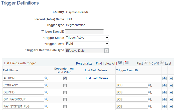

Use the Trigger Definitions page (GP_TRGR_SETUP) to define iterative, segmentation, and retroactive triggers.
To create a retroactive or segmentation trigger, first define the appropriate event ID on the Retro Event Definition page or Segmentation Event Definition page.
Navigation:
This example illustrates the fields and controls on the Trigger Definitions page.
Note: The fields on this page vary depending on the type of trigger you are creating and the values you select.

Trigger Level |
Select Record if you want the system to generate a trigger in response to a change to any field in the record; select Field if you want the system to generate a trigger in response to changes to a specific field or group of fields in the record. If you select Field, you must list the fields that you want to make sensitive to data changes in the Field column in the List Fields With Trigger group box. You can further restrict the data changes that generate triggers by selecting the Dependent on Field Value Action check box for a specific field, clicking the List Field Values link, and specifying the values that should result in trigger generation. Note: When you define segmentation triggers for the GP_PYE_OVRD record, the system automatically sets the Trigger Level to Field. |
Trigger Event ID |
For retro and segmentation triggers, specify the trigger event ID at the record level, the field level, or the field value level:
Note: Iterative triggers don't have trigger event definitions, because their only function is to process a payee in the current open calendar; therefore, the defined event is always the same. |
Primary Event ID |
Enter one of the event IDs defined on the Retro Event Definition page. The primary event ID functions as the default event ID when the trigger level is Field and the changed, added, or deleted row that triggers retro processing is the first row in the buffer (that is, a prior row cannot be found). In this case, the system generates a retroactive trigger using the primary retroactive event ID. Note: The Primary Event ID field appears only when the trigger type is Retro and the trigger level is Field. |
Trigger Effective Date Type |
This field displays one of the following values, based on the record specified in the Record (Table) Name field: Effective Date Begin-End Date Fixed Date Only retro triggers can have a Trigger Effective Date Type of Fixed Date. To generate retro triggers with a fixed trigger effective date, you must pass the date as a parameter to the generic PeopleCode function Generate_Triggers. The system generates only one trigger regardless of the number of data changes. Note: When you define segmentation triggers for the GP_PYE_OVRD record, the system automatically sets the Trigger Effective Date Type to Begin-End Date. |
List Fields with Trigger
If you select Field in the Trigger Level field, the List Fields With Trigger group box becomes available.
Field or Control |
Description |
Field Name |
Enter the name of the field that you want to make sensitive to data changes. Note: When you define segmentation triggers for the GP_PYE_OVRD record, the system automatically sets the Field Name to PIN_NUM. |
Dependent on Field Value |
Select this check box to indicate that the fields that you've defined as sensitive to data changes are dependent on specific field values. In this case, only changes to the values you specify on the Trigger Definition - Field Values page will trigger a system action. This enables you to limit the kinds of changes that cause iterative, retroactive, or segmentation processing. When you define Segmentation triggers for the GP_PYE_OVRD record, the system automatically selects the Dependent on Field Value option. |
List Field Values |
This link becomes available when you select the Dependent on Field Value check box. Click to access the Trigger Definitions - Field Values page, where you can list the field values that trigger an action. |
Trigger Event ID |
This field is required when the trigger level is Field and Dependent on Field Value is cleared. Based on the type of trigger you are defining, enter an event ID that you defined on either the Retro Event Definition page or the Segmentation Event Definition page. Note: This field is not used with iterative triggers. |

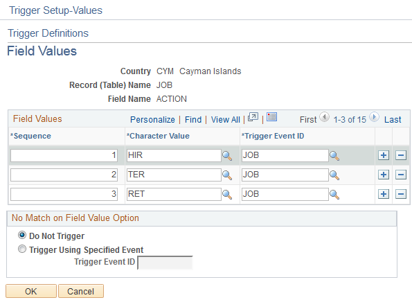

Use the Trigger Definitions - Field Values page (GP_TRGR_SETUP_SEC) to indicate which field values initiate actions.
Navigation:
Click the List Field Values link on the Trigger Definitions page.
This example illustrates the fields and controls on the Trigger Definitions – Field Values page.
Field Values
Field or Control |
Description |
Sequence |
Enter a sequence number, which the system needs to uniquely identify the field values and distinguish them from other rows of data that you might set up. |
Numeric Value |
If the record and field combination stores numeric values, this field is available for entry. Enter the value that triggers a system action. |
Character Value |
If the record and field combination stores character values, this field is available for entry. Enter the value that triggers a system action. |
Date Value |
If the record and field combination stores date values, this field is available for entry. Enter the value that triggers a system action. |
Trigger Event ID |
This field is required when the trigger level is Field and Dependent on Field Value is selected. Based on the type of trigger you are defining, enter an event ID that you defined on either the Retro Event Definition page or the Segmentation Event Definition page. Note: This field is not used with iterative triggers. |
Offset Days |
This field is available only when the trigger type is Retro. Enter a positive or negative number to increase or decrease the retro trigger effective date in relation to the date of a field value change. For example, if you enter -1 in the Offset Days field for one of the values listed in the Field Values group box, and you retroactively enter that value into the database with an effective date of January 1, 2000, the system automatically adjusts the trigger effective date to December 31, 1999 (one day earlier). The system then processes pay periods going back to December 1999 rather than January 2000. |
Entry Type |
This field is available only when the trigger type is Segmentation and the record for which you are defining the trigger is GP_PYE_OVRD. Select Earnings to define an earning to trigger segmentation when it is assigned to a payee on the Element Assignment by Payee or Payee Assignment by Element components and the assignment begin date comes after the pay period begin date, and/or the assignment end date comes before the pay period end date. Select Deduction to define a deduction to trigger segmentation when it is assigned to a payee on the Element Assignment by Payee or Payee Assignment by Element components and the assignment begin date comes after the pay period begin date, and/or the assignment end date comes before the pay period end date. |
Element |
This field is available only when the trigger type is Segmentation and the record for which you are defining the trigger is GP_PYE_OVRD. Specify the earning or deduction (depending on the entry type specified above) that should trigger segmentation when it is assigned to the payee. |
Trigger Option |
This field is available only when the trigger type is Segmentation and the record for which you are defining the trigger is GP_PYE_OVRD. Valid values are:
No Match on Field Value Option
Use the fields in this group box to specify a default trigger event ID to use when a change to a field involves values other than those listed on the Trigger Definitions – Field Values page. Use these fields only if you want these other values to trigger iterative, retro, or segmentation processing.
Field or Control |
Description |
Do Not Trigger |
This option is selected by default because the system assumes that triggers should be generated only when there is a match between values actually entered in the database and the field values that you identify on the Trigger Definitions – Field Values page. |
Trigger |
When you select this option, the Trigger Event ID field becomes available for entry. |
Trigger Event ID |
Enter a default trigger event ID to use to process field values that are not linked to a trigger event ID on the Trigger Definitions – Field Values page. |
