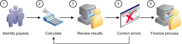

This illustration shows the payroll and absence processing steps.
Here are the steps for running a payroll run or an absence run (use the Payroll/Absence Run Control page for steps 1, 2, and 5):
Identify payees (Identify phase).
The payroll cycle begins when you run a process that identifies all payees that are to be processed.
Perform calculations (Calculate phase).
This phase computes each payee's gross and net earnings (for a payroll run) or absence take or entitlement units (for an absence run).
Review results.
If the system encounters problems during the Calculate phase—for example, invalid element definitions or payee eligibility problems—it places the payee in error. You can use various pages to review summary results, errors, and warning messages.
Correct any errors and recalculate.
To correct errors, you may need to update the Positive Input pages or make changes to the data in other applications that are integrated with Global Payroll, such as HR or Time and Labor. You can then run the Calculate phase again to process only the payees that need to be recalculated.
Finalize the run.
When you're satisfied with the processing results, run the Finalize phase to close the calendar group ID.

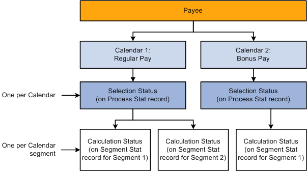

Status codes and process indicators play an important role in payroll and absence processing. Status codes help you monitor and interpret the processing results; process indicators enable you to manually enter processing instructions for specific payees. This topic focuses on how the codes are created and how to interpret them.
Status Codes
The system creates two sets of status codes as it identifies each payee for processing:
One selection status code for each payee for each calendar, which it stores on the Process Stat (process status) record. During the first run of the Identify phase, each payee's selection status is set to Active or Inactive to explain why the payee was identified for processing. With each iteration of the Calculate phase, the system updates the status to explain why the payee was included in or excluded from processing.
The system keeps a record of excluded payees only if they were suspended or canceled. If the payee simply no longer qualifies for selection (for example, the payee is assigned to a different pay group), the system does not record this, and the payee's process and status records are deleted.
One calculation status code for each payee, per calendar segment, which is stored on the Segment Stat record. If a calendar has no period segmentation, a payee has one calculation status. Calculation status tells you the most recent action that has been completed for the segment, for example, identified, calculated, in error, or frozen. Before you run the Calculate phase for the first time, the status code for each identified payee is Identified.
This diagram shows how the system creates status codes when it identifies payees for processing.
