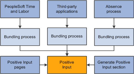

Positive input can come from various sources. You can:
Manually enter data through the positive input pages.
Receive data from Time and Labor, the Manage Variable Compensation business process in HR, or third-party applications.
Run the Absence Take process (GP_PAYE) to convert paid and unpaid absences into positive input.
Include a generate positive input section in your process list, causing the system to create positive input for a different pay calendar.
With one exception, manual entries override positive input generated by other sources. (Manual entries with an action type of Add do not override automated entries.) If a payee has system-generated entries from multiple sources, such as Time and Labor and the Absence Take process, but no manual entries, the system processes all automated entries during the pay run.
You can edit positive input only if it was entered into the system manually. To add, delete, or correct a system-generated entry, enter positive input that overrides the system-generated entry; if the data was generated by another application, correct the source records and retransmit the data.

This diagram illustrates the sources of positive input and bundling.

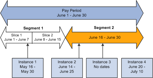

When a calendar pay period has period or element segmentation, positive input isn't prorated. It's assigned to a single segment or slice, based on the instance's end date:
If the end date falls before the calendar period begin date, the instance is assigned to the pay period's first segment or slice (see Instance 1 in the diagram).
If the end date falls in the pay period, the instance is assigned to the segment or slice in which the end date falls (see Instance 2).
When no end date is specified, the instance is assigned to the pay period's last segment or slice.
It's assumed that the end dates for the instance and the calendar are identical (see Instance 3). There is one exception: you can enter Do Not Process instructions to prevent the element's resolution. If you enter this instruction with no end date, the element isn't resolved in any slice or segment.
If the end date falls after the pay period end date, the instance isn't processed (see Instance 4).
This diagram illustrates instances assigned to segments and slices by end date
