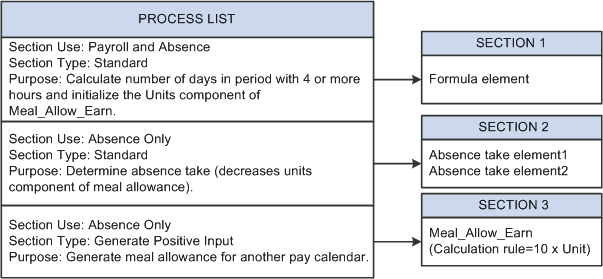

Generate Positive Input Section Example
Your organization's policy is to pay a daily meal allowance to payees who work four or more hours in a day, and you've created an earning element called Meal_Allow_Earn, with a calculation rule of Unit × Rate.
This example shows how your process list might be defined (the generate positive input section is the last in the process list).
The system resolves the formula element in section 1, initializing the units component of Meal_Allow_Earn with the number of days in the period when the payee is scheduled to work four or more hours. The system moves to section 2, where it resolves the absence take elements, thereby decreasing the meal allowance units by the number of days that the payee was absent on days the payee was scheduled to work four or more hours. Assume that the units component resolves to 1 (day)—the payee was scheduled to work five hours and did so. Finally the system reaches section 3, the generate positive input section, containing the meal allowance earning element. Because the units component of the earning element was populated in sections 1 and 2, the system generates a row of positive input as listed in the following table:

If a take element (parent element) is mapped to another take element (child element):
The child element is processed immediately after the parent element for the day being processed.
List the child element after the parent element on the process list. The system proceeds to the next day, only after processing all generated and manually entered take elements for that day.
Child elements that are not included in the section where the parent element is being processed are not processed until the system resolves the section that lists the child element.
Note: Mapping refers to linking one take to another by completing the Mapped to Element field on the Absence Take - Day Formula page or the Take with Other Absence field on the Absence Take - Negative Balances page.
