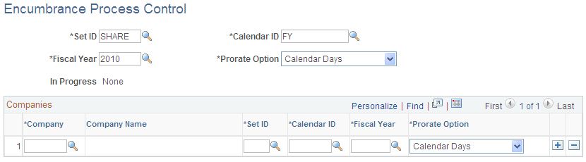

Use the Encumbrance Process Control page (HP_ENCUMBER_CTL) to define processing parameters for real-time budget checking.
Navigation:
This example illustrates the fields and controls on the Encumbrance Process Control page.
Field or Control |
Description |
Set ID |
This is the default SetID that the system uses to look up the journal template. This SetID is for the General Ledger business unit. |
Calendar ID |
Enter the default detail calendar to use for companies other than the ones that you specifically list in the Companies grid. The available calendar IDs are governed by the SetID that you select. Detail calendars define the number of accounting periods in a fiscal year and the starting and end dates for each period. See Understanding Detail Calendars, Reviewing Detail Calendars and Budget Periods. |
Fiscal Year |
Enter the fiscal year to use for encumbrance calculations during real-time budget checking. The available choices are governed by the SetID and Calendar ID that you select. Also, when determining whether to enter a default funding end date in an encumbrance definition, the system looks at the department budget settings (specifically, the Funding End Date Defaults from Funding Source check box) for the fiscal year that you enter here. This use of the Fiscal Year field applies regardless of whether real-time budget checking is used. Note: To activate funding end date defaulting for encumbrance definitions, you must define a fiscal year on the Encumbrance Process Control page. |
Prorate Option |
If you are prorating encumbrances across accounting periods, you can prorate using calendar or work days. Indicate if the encumbrance prorate option is Calendar Days or Work Days. |
