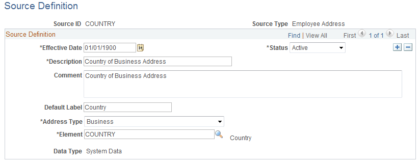

Use the Source Definition page (ADDRESS Source Type) (WCS_SO_ADDRESS) to define sources that are base on address information.
Navigation:
Select ADDRESS as the source type on the Define Sources search page.
This example illustrates the fields and controls on the Source Definition page - ADDRESS source type.
You can create a source that refers to any address type (home, work, mailing, and so on) and any field (address line, city, state, country) in the address.
Field or Control |
Description |
Address Type |
Select the type of address. |
Element |
Select the field that will define this source. |

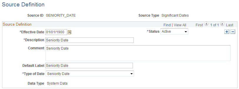

Use the Source Definition page (DATES Source Type) (WCS_SO_DATES) to define sources that are based on dates.
Navigation:
Select DATES as the source type on the Define Sources search page.
This example illustrates the fields and controls on the Source Definition page - DATES source type.
Field or Control |
Description |
Type of Date |
Select the date type for this matrix. Values are:

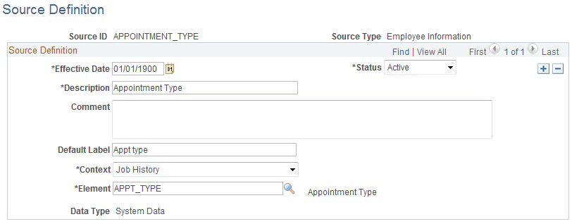

Use the Source Definition page (EMPINFO Source Type) (WCS_SO_EMPL) to define sources that are based on employee information.
Navigation:
Select EMPINFO as the source type on the Define Sources search page.
This example illustrates the fields and controls on the Source Definition page - EMPINFO source type.
Field or Control |
Description |
Context |
Select a value. The system will allow you to select an element that is available through one of these contexts. This is the list of contexts, along with sample list of elements that are available within each context:
Element |
Select the field that will define this source. The prompt list is based on the selected context. |

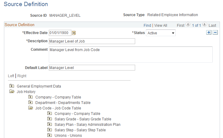

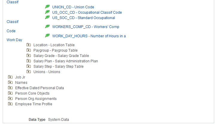

Use the Source Definition page (EMPRELATED Source Type) (WCS_SO_RELATED) to define sources that are based on related employee information.
Navigation:
Select EMPRELATED as the source type on the Define Sources search page.
This example illustrates the fields and controls on the Source Definition page - EMPRELATED source type (1 of 2).
This example illustrates the fields and controls on the Source Definition page - EMPRELATED source type (2 of 2).
Click the folder icon in the tree to open the appropriate related table and then select the appropriate element by clicking the leaf node.
This tree allows you to derive a value from any table related to worker's Job record using the EmplID as a starting point. For example, if you want to use the Manager Level of the worker's Job Code as the source, you can link to it by opening the JOBCODE folder and clicking the Manager Level leaf node. You can use this source type to create source IDs for fields that are not available as system-defined source IDs.

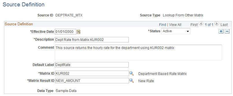

Use the Source Definition page (MATRIX Source Type) (WCS_SO_OTHER_LKUP) to define sources that are based on a matrix.
Navigation:
Select MATRIX as the source type on the Define Sources search page.
This example illustrates the fields and controls on the Source Definition page - MATRIX source type.
With this source, the system evaluates the key for the input dynamically by referring to another matrix and using one of the results from that matrix as the key value.
See Inputs Page.
Field or Control |
Description |
Matrix ID |
Select from the list of available matrices. |
Matrix Result ID |
Select the result ID (output) from the matrix that will be used as the source ID. |
Example: Health Benefits Rates Using a MATRIX Type Source ID
Suppose you are creating a matrix to determine health benefit allowance amounts. However, you want to base the health benefits on standard hourly rates for each department. If the hourly rates are below a certain amounts, then you will give health benefits. The matrix may look like this example:
Standard Hourly Rate |
Health Benefit Rate |
10–12 |
4 |
13–15 |
3 |
16–20 |
2 |
21–100 |
0 |
In this case, you need a way to dynamically get hourly rates for the worker's department. A source of type Matrix is useful in this case. In the previous example, you define a source that will return the rate for the worker's department. You specify which matrix has department rates and which result ID from that matrix is the rate value.
In the health benefits table, the Std Hourly Rate would be defined using the DEPTRATE_MTX source ID.

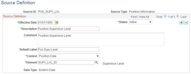

Use the Source Definition page (POSINFO Source Type) (WCS_SO_EMPL) to define sources that are based on position information.
Navigation:
Select POSINFO as the source type on the Define Sources search page.
This example illustrates the fields and controls on the Source Definition page - POSINFO source type.
Field or Control |
Description |
Element |

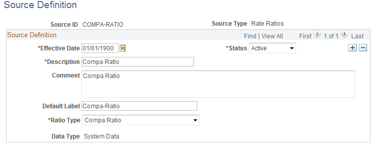

Use the Source Definition page (RATIOS Source Type) (WCS_SO_RATIO) to define sources that are based on ratios.
Navigation:
Select RATIOS as the source type on the Define Sources search page.
This example illustrates the fields and controls on the Source Definition page - RATIOS source type.
The system will calculate the appropriate ratio for the worker dynamically at runtime. The system uses the salary ranges based on the effective date of the transaction.
Field or Control |
Description |
Ratio Type |
Select one of these values:

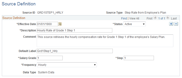

Use the Source Definition page (STEPRATE Source Type) (WCS_SO_STEP_RATE) to define sources that are based on salary grade step rates.
Navigation:
Select STEPRATE as the source type on the Define Sources search page.
This example illustrates the fields and controls on the Source Definition page - STEPRATE source type.
This source returns the standard compensation rate for a given grade and step within the worker's salary administration plan. This type of source can be used to create rate matrices where the rates are dependent upon or related to rates on one or more grades and steps in the worker's salary administration plan.
Field or Control |
Description |
Salary Grade |
Enter the grade (from the worker's salary plan) to which this source will refer. |
Step |
Enter the step within that grade whose rate you want to use as the source. |
Frequency |
Select the frequency with which you want the rate returned from these values: Annual, Daily, Hourly, or Monthly. |

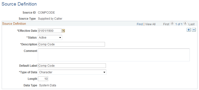

Use the Source Definition page (SUPPLIED Source Type) (WCS_SO_SUPPLIED) to define sources that are based on supplied information.
Navigation:
Select SUPPLIED as the source type on the Define Sources search page.
This example illustrates the fields and controls on the Source Definition page - SUPPLIED source type.
Use this type of source when the component that will use the matrix will pass the appropriate Input value (for the worker) directly, so that there is no lookup to any table to derive the value.
Field or Control |
Description |
Type of Data |
Select from these values:

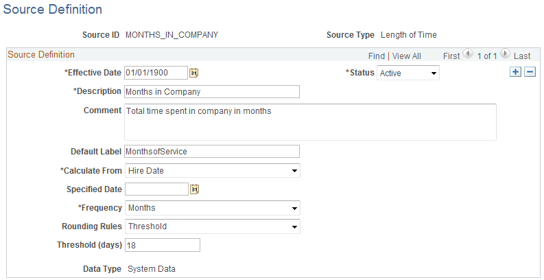

Use the Source Definition page (TIMESPAN Source Type) (WCS_SO_TIME) to define sources that are based on the length of time.
Navigation:
Select TIMESPAN as the source type on the Define Sources search page.
This example illustrates the fields and controls on the Source Definition page - TIMESPAN source type.
This source allows you to define as input the length of time elapsed between current (as of) date and a specified reference date. For example, if you want to create a rate matrix that will include pay rates based on how long the worker has been in the company, in that job, or in that grade, then you define a source of this type.
Field or Control |
Description |
Calculate From |
Select the type of date from which you want the length of time to be calculated. The available dates are:
Specified Date |
Enter the specific calendar date from which you want the length of time to be calculated. Important! The Specified Date and Calculate From options are mutually exclusive. If you enter a specified date, you cannot select a date in the Calculated From field. If you select a date in the Calculated From field, you cannot enter a specified date. |
Frequency |
Select the frequency with which you want the length of time to be calculated. You can select Hours, Days, Weeks, or Months. |
Rounding Rules |
Select a value that will represent the type of rounding to be applied to the timespan.
Threshold (Days) |
Enter the number of days to be used with the Rounding Rules field. |
