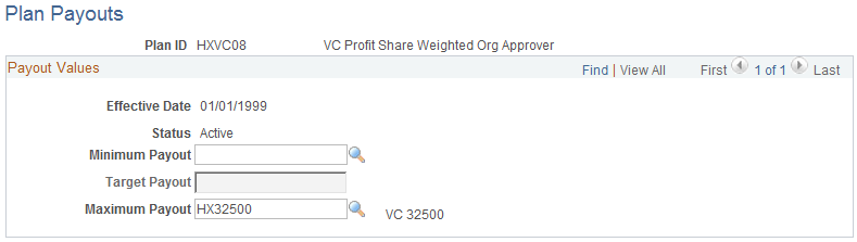

Use the Plan Payouts page (VC_PAYOUT) to assign payout formulas at the minimum and maximum levels under the plan.
Plans that use matrix goals or ad hoc membership are not available. Use this page if the Plan Member Rule is Empl VC Record.
Navigation:
This example illustrates the fields and controls on the Plan Payouts page.
Payout Values
To establish a payout, select a payout formula from the available options. The system prompts you with values from the Payout Formula table (VC_PAYFORM_TBL). All payout fields are unavailable for entry if awards have been approved, manually altered, or sent for payout or distribution for the period during which the effective date falls.
The system applies the payout to all members of the plan.
Availability of Fields
Depending on the Plan Member Rule, some fields are unavailable for entry and some fields are optional, as summarized in this table:
Field |
Empl VC Record |
Ad Hoc Award |
Minimum Payout |
Optional field. |
Field unavailable for entry. |
Target Payout |
Field unavailable for entry. Set the target payout at the worker level on the Individual's Payout page. |
Field unavailable for entry. Enter the award at the worker level directly on the Allocate Awards page. |
Maximum Payout |
Optional field. |

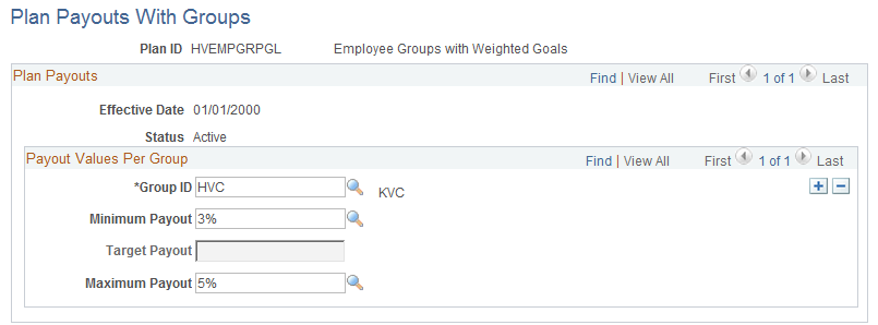

Use the Plan Payouts With Groups page (VC_PAYOUT_WG) to assign payout formulas at the target, minimum, and maximum levels under the plan.
Plans that use matrix goals are not available.
Navigation:
This example illustrates the fields and controls on the Plan Payouts With Groups page.
Field or Control |
Description |
Group ID |
Select an ID from the available options, which are groups in the VC Tree that you specified for the plan. The default group ID is the root group of the tree. Set the payouts for the highest group to which it applies. The system automatically applies the payout to all child groups in the tree unless a specific payout formula is applied to a child group. |
Payout Values Per Group
To establish a payout, select a payout formula from the available options. The system prompts you with values from the Payout Formula table (VC_PAYFORM_TBL). No payout fields are available for entry if awards have been approved or sent for payout or distribution for the period during which the effective date falls.
The system applies the payout to all members of the selected group and its child groups if you do not define payouts at lower levels on the tree.
Field |
Empl VC Record with Groups |
Define Tree/Group |
Minimum Payout |
Optional field. |
Optional field. |
Target Payout |
Required field except when the plan uses matrix goals. |
Maximum Payout |
Optional field. |
Optional field. |
