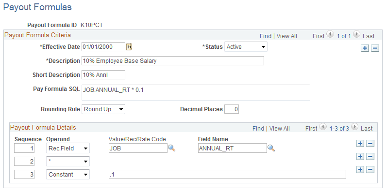

This example illustrates the fields and controls on the Payout Formulas page.

Payout Formula Example
To define a payout formula of 1 percent of the worker's job annual rate, select the Job record, the Annual Rate field name (on the Job record), the operator *, and the constant .01. Place the formula in parentheses so that the final formula in the Pay Formula SQL field is (JOB.ANNUAL_RT * 0.01).
