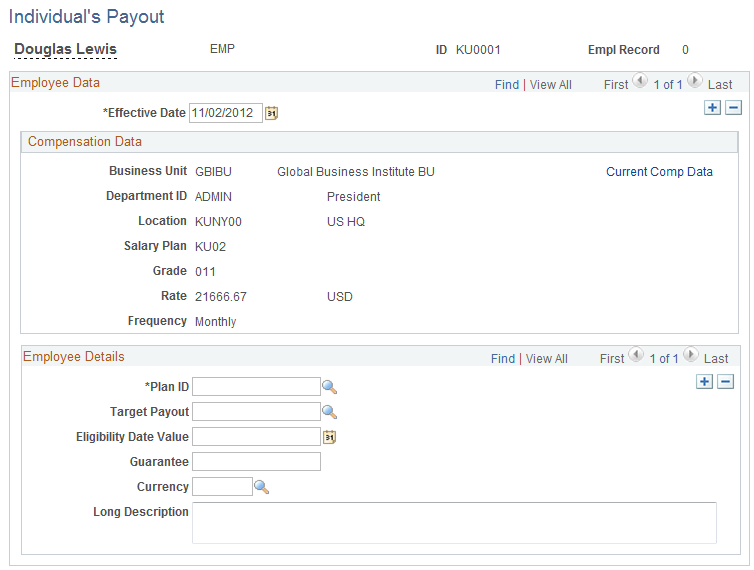

Use the Individual's Payout page (VC_EE_VCOMP) to .perform one of these actions:
Add or delete plan members for plans that specify Empl VC Record (without groups) as the plan member rule.
Assign or update a target payout formula or guarantee.
Specify the plan eligibility date if the VC plan does not use groups.
Navigation:
This example illustrates the fields and controls on the Individual's Payout page.
For plans that specify Employee Variable Compensation Record (without groups) as the plan member rule, use this page to add or delete plan members or to change a member's target payout or guarantee at any time in the life of the plan.
Compensation Data
All data displayed in the Compensation Data group box is supplied as the default from the worker's Job record as of the effective date that you entered on this page. This data is for information only.

Plan ID |
Select a valid ID. The system displays the description of the plan. Only plans that define Employee Variable Compensation Record (with or without groups) as the plan member rule appear in the list. If the plan that you select in this field has expired (that is, the end date of the plan ID on the VC plan table is prior to the current date), the remaining fields on the page are unavailable for entry. |
Target Payout |
Select a target payout for the worker. You are prompted with values from the Pay Formula table. The system displays the description of the formula that you select. If you do not select a value here, when you save the page, the system issues a warning and specifies the plan ID for which no target payout formula was entered. |
Eligibility Date Value |
Enter the date on which the worker becomes eligible for a payout from the VC plan ID that you selected. The system enters the VC plan start date from the VC Plan table as the default. The Determine Eligibility/Proration process calculates plan eligibility and proration as of this date for plans that do not use groups. The system does not use this date for eligibility processing if the plan uses groups. |
Guarantee |
Enter an amount that is guaranteed for the worker under this VC plan ID. This is an optional field. The amount appears for your information on the Allocate Awards page, where you can adjust the calculated award as required. |
