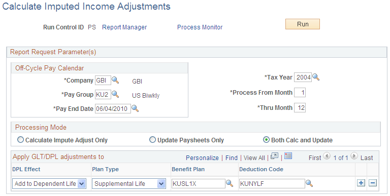

(USA, USF) Use the Calculate Imputed Income Adjustments page (RUNCTL_IMP_CALC) to calculate imputed income adjustments and update paysheets with the adjustment amounts.
Navigation:
This example illustrates the fields and controls on the Calculate Imputed Income Adjustments page.
Field or Control |
Description |
Process From Month and Thru Month |
Enter a numerical value for the first and last months in the date range. (Ordinarily, this is 1 through 12—January through December). |
Processing Mode
Field or Control |
Description |
Calculate Impute Adjust Only (calculate imputed adjustment only) |
Calculates imputed income for the selected period and creates transaction files, but does not load the transactions into paysheets. |
Update Paysheets Only |
Loads calculated imputed income transactions that are created in a previous run into paysheets as one-time deductions. |
Both Calc and Update |
Calculates imputed income and creates transaction files, then loads the transactions into paysheets as one-time deductions. Use these options as follows:
Apply GTL/DPL adjustments to
Use this group box to designate the deduction codes to which you want the system to apply the imputed income transactions when it loads the transactions into paysheets.
Field or Control |
Description |
DPL Effect (dependent life effect) |
Select the type of adjustment. You must have one row for Add to DPL (add to dependent life) and one row for Add to GTL (add to group-term life). Note: Under ordinary circumstances, the run control has only two rows in the Apply GTL/DPL adjustments to (apply group-term life/dependent life adjustments to) group box. Even if some employees have more than one GTL or DPL plan, the process applies their adjustments to a single plan—one for GTL and one for DPL. |
Deduction Code |
Deduction codes must be valid for all employees in the run. |
Important! This COBOL process takes one or two minutes to process each employee. If you have many employees, the process could take hours or even a full day.
