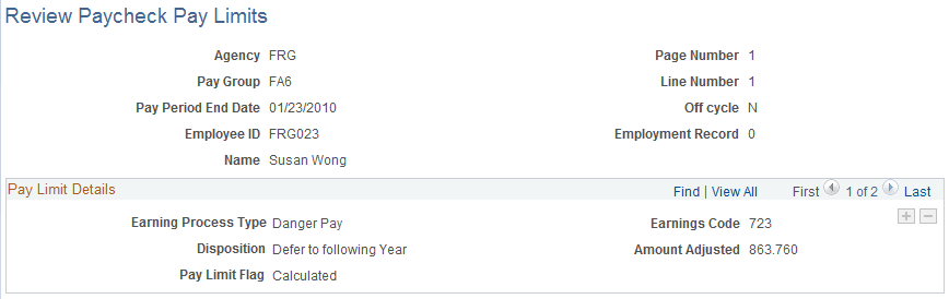

GVT_PAY_LIMITS |
(USF) View the results and status of pay limits transactions. This page is display-only. |

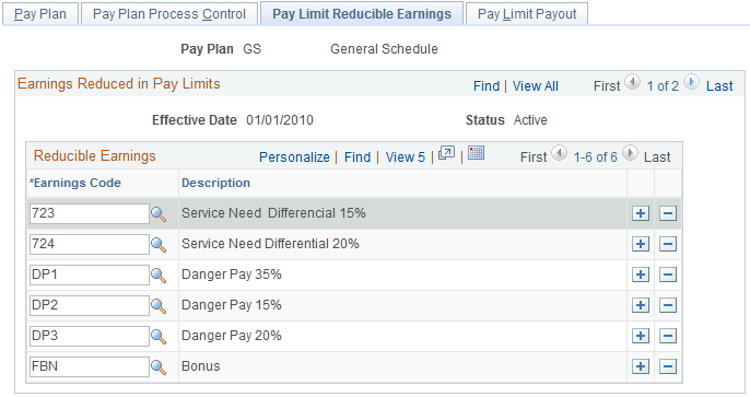

GVT_EARN_RE_USF |
(USF) Define earnings that can be reduced when pay limits/caps are reached. If earnings are not defined here, earnings over the limits will not be reduced. |

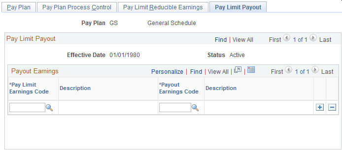

GVT_EARN_PO_USF |
(USF) Assign a Payout Earnings Code to each Pay Limit Earnings Code within a pay plan to facilitate the payout of earnings during the first pay period of a calendar year, and for termination payouts. |

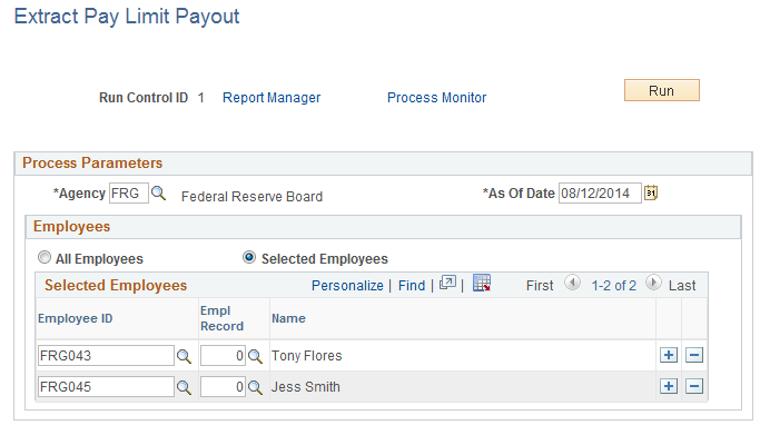

GVT_LIMIT_PAYOUT |
(USF) Extract a terminated employee’s lifetime balances prior to loading payout earnings to paysheets. |

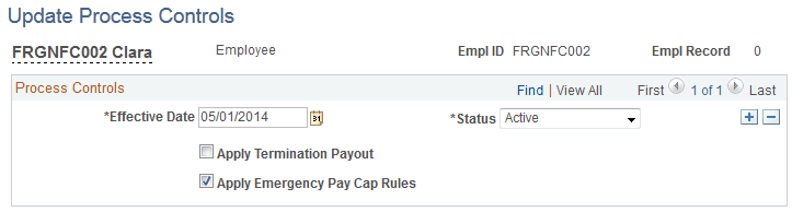

GVT_EE_PY_PROC |
(USF) Apply termination payout rules or emergency pay cap rules to override the Premium Pay (bi-weekly) pay cap limit at the employee level. |

When a pay limit is reached, the system reduces the reducible earnings subject to that pay limit by the amount exceeding the pay limit. (It does not reduce it from all earnings that the employee is paid.) These earnings are set up on the Pay Limit Reducible Earnings Page of the USF Pay Plan component.
Danger Pay
Danger Pay is applied during pay calculation. The Pay Calculation COBOL SQL process (PSPPYRUN) calculates the sum of the employee’s Danger Pay process type earnings, and compares it to the percentage specified on the Pay Plan Table USF. If the danger pay earnings exceed the maximum percentage per pay period, the system does the following:
Reduces earnings if earnings are defined on the Pay Limit Reducible Earnings page of the Pay Plan Table USF component.

In addition, Pay Confirmation searches for a match between the earnings code on the pay line and the payout earnings code on the employee’s Pay Plan Table USF. If the process finds a match, it reduces the pay limit balances of the pay limit earnings code by the amount of the payout earnings code.
For example, the payout earnings code PO1 (Payout for Danger Pay) is mapped to pay limit earnings code DP1 (Danger Pay). The employee has $2,000.00 MTD (month-to-date), $5,000.00 QTD (quarter-to-date), $20,000.00 YTD (year-to-date), and $50,000.00 of lifetime balances in the current balance period. $50,000.00 of PO1 earnings is paid out to the employee who has resigned. The resulting DP1 pay limit balances and PO1 earnings balances are shown in the following Before Pay Confirmation and After Pay Confirmation tables.

(USF) Use the Review Paycheck Pay Limits page (GVT_PAY_LIMITS) to view the results and status of pay limits transactions.
Navigation:
This example illustrates the fields and controls on the Review Paycheck Pay Limits page.
Field or Control |
Description |
Earnings Code |
The page displays a row of data for each earning code that has been reduced during the pay period. |
Disposition |
Values are Forfeit or Defer to Following Year, as defined on the Pay Plan table. |
Amount Adjusted |
The reduction in earnings. |
Pay Limit Flag |
The status of the limit. Valid values are: Calculated (R) Confirmed (C) Processed (P) Calendar Year Unconfirm (X) |

(USF) Use the Update Process Controls page (GVT_EE_PY_PROC) to apply termination payout rules or emergency pay cap rules to override the Premium Pay (bi-weekly) pay cap limit at the employee level.
Navigation:
This example illustrates the fields and controls on the Update Process Controls page.
Field or Control |
Description |
Apply Termination Payout |
Select to apply lifetime lump sum payout for an employee’s termination or transfer. If the Apply Termination Payout check box is selected here, and the status is Active as of the pay end date on the Extract Pay Limit Payout run control page, then the system extracts the employee’s deferred earnings lifetime balances, and Load Paysheet Transactions inserts them into the Paysheet Transactions record. Note: You must run the pay limit payout extract process before running the load paysheets process to include lifetime balances in terminated employee’s payout. If the Apply Termination Payout check box is selected here, and the status is Active as of the pay end date on the Update Payroll Controls run control page, then the Pay Calculation process bypasses pay cap/limit checking when calculating the employee’s paycheck. |
Apply Emergency Pay Cap Rules |
Select to apply the employee’s annual pay cap instead of the employee’s Premium Pay (bi-weekly) pay limit-premium pay for an employee performing work associated with an organization’s emergency situation. See the table below to determine conditions for bypassing Premium Pay (bi-weekly) limits for emergency situation pay. |
This table shows conditions under which the system bypasses Premium Pay (bi-weekly) pay caps for emergency situation pay.

(USF) Use the Pay Limit Reducible Earnings (GVT_EARN_RE_USF) page to specify earnings codes of all earnings that are eligible for reduction if employee’s earning exceed pay cap/limit amounts.
Navigation:
This example illustrates the fields and controls on the Pay Limit Reducible Earnings page.
All earnings that should be reduced must be defined on the Pay Limit Reducible Earnings page. If not defined here, the earnings will be paid even if they are over the limits.
Note: Do not define regular pay on the Pay Limit Reducible Earnings page. Regular pay is not reducible per the regulations.
(USF) Use the Extract Pay Limit Payout Page (GVT_LIMIT_PAYOUT) page to extract a terminated employee’s lifetime balances prior to loading payout earnings to paysheets.
Navigation:
To load an employee’s lifetime balances to the Paysheet Transactions record, the employee must have at least one lifetime balance and the lifetime balance must be greater than zero. Also, in addition to the settings that you select here on the Extract Pay Limit Payout run control page, the following conditions must be met on the Update Process Controls Page .
The Apply Termination Payout check box must be selected as of the As Of Date that you select on the Extract Pay Limit Payout run control page.
The payroll controls status must be Active as of the As of Date that you select on the Extract Pay Limit Payout run control page.
This example illustrates the fields and controls on the Extract Pay Limit Payout page.
Field or Control |
Description |
Agency |
Select the agency to process. |
As Of Date |
Enter the date to use for processing. Note: Do not run the extract more than once for an As Of Date. Running the extract for a second time for the same As Of Date will result in the creation of additional transactions, which if loaded to the paysheet, can result in duplicate payments to the employee. |
All Employees or Selected Employees |
Identify the employees to process. You can choose to process all employees in the agency as of the date specified, or select the Selected Employees option to identify only specific employees to process. Note: If the specific employees that you select are not in the specified agency on the As Of Date, they will not be processed. |
(USF) Use the Pay Limit Payout Page (GVT_EARN_PO_USF) page to assign a Payout Earnings Codes to each Pay Limit Earnings Code within a pay plan to facilitate the payout of earnings during the first pay period of a calendar year, and for termination payouts.
Navigation:
This example illustrates the fields and controls on the Pay Limit Payout page.
Field or Control |
Description |
Pay Limit Earnings Code |
Enter the earnings code of the pay limit to use. Assign a Payout Earnings Code for each Pay Limit Earnings Code within a pay plan to facilitate the payout of earnings during the first pay period of a calendar year and for termination payouts. |
Payout Earnings Code |
Specify the Payout Earnings Code from which to pay the pay limit earnings, subject to the specified pay limit. Note: A unique Payout Earnings Code is required for each Pay Limit Earnings Code within a Pay Plan. If a Payout Earnings Code is not unique, an error message appears. Also, the Payout Earnings Code cannot be the same as the Payout Limit Earnings Code. If the two earnings codes are the same, an error message appears. The Create Paysheets process loads paysheets with lifetime balances for the first pay period of a calendar year, and for terminated employees. (For terminated employees, the lifetime balances must first be extracted.) If the process finds a Payout Earnings Code on the Pay Limit Payout page, it loads payout earnings into the Other Earnings section of a paysheet. Manual updates by the users to the payout earnings on an employee’s paysheet could result in the payout amount being greater than the employee’s lifetime balances. Use caution in updating the paysheets manually. |
