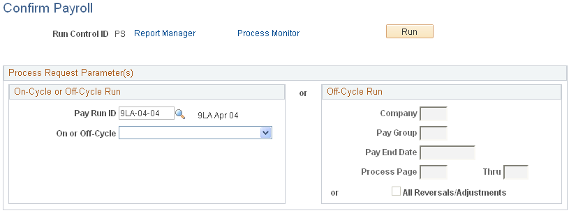

Use the Confirm Payroll page (RUNCTL_PAY_CONF) to enter pay confirmation process parameters and run the Pay Confirmation process.

This example illustrates the fields and controls on the Confirm Payroll page.
On-Cycle or Off-Cycle Run
Field or Control |
Description |
Pay Run ID |
For on-cycle confirmation, enter the pay run ID. Use the identical pay run ID in the Pay Confirmation process that you used during both the Paysheet Creation and Pay Calculation processes. |
On or Off-Cycle |
To confirm all off-cycle checks that are associated with a particular period, enter a pay run ID and select Off-Cycle. To confirm off-cycle checks by page range, leave the Pay Run ID field blank, select Off-Cycle, and use the Off-Cycle Run group box to specify parameters for the calculation: company, pay group, pay end date, and the page numbers. |
Off-Cycle Run
Field or Control |
Description |
All Reversals/Adjustments |
Select to process all reversals and adjustments. |
