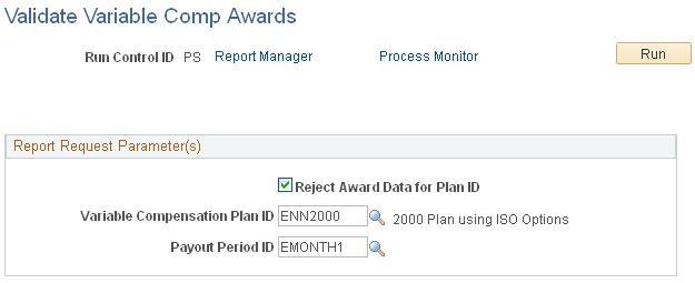

Use the Validate Variable Comp Awards (validate variable compensation awards) page (RUNCTL_VCAWARD) to run the Process VC Awards process to validate award data submitted by Manage Variable Compensation and send acknowledgement of validation.
Also use to reject an entire transmission of awards data.

This example illustrates the fields and controls on the Validate Variable Comp Awards page.
Field or Control |
Description |
Reject Award Data for Plan ID |
Select this option only if you want to reject award data for a selected plan ID and payout period that has been sent by the Manage Variable Compensation administrator since you last ran the Load Paysheets process. You cannot save this page if any awards for the plan ID and payout period that you select in the next two fields have already been processed through payroll, regardless of the stage of payroll processing. |
Variable Compensation Plan ID |
This field appears only if you select the Reject Award Data for Plan ID check box. Select the variable compensation plan for which you want to reject awards. |
Payout Period ID |
This field appears only if you select the Reject Award Data for Plan ID check box. Select the payout period for which you want to reject awards. |
