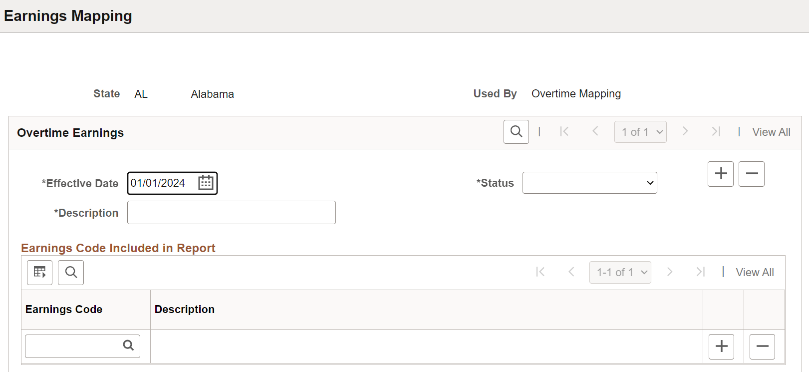

Use the Earnings Mapping page (PY_ST_ERN_MAPPING) to list the overtime earnings codes to be used exclusively to pay overtime wages that qualify for Alabama tax exemption.
Navigation:
This example illustrates the fields and controls on the Earnings Mapping page.
Employers must update the Earnings Mapping Table(s) with the applicable Overtime Earnings Code(s) before the monthly/quarterly report can be generated.
The system determines whether the overtime earnings code qualify for the Alabama Tax exemption by looking at the Earnings Mapping table. If an employee has overtime wages paid using the earnings code added to the Earnings Mapping table, the employee and the corresponding overtime wages will be included in the report.
Note: When calculating and paying overtime, some employers use two different Earnings Codes to split and separately pay overtime straight-time and overtime premium amounts. If you pay overtime using this method, be sure to add both of the Earnings Codes on this page for the report to pull the overtime pay.
