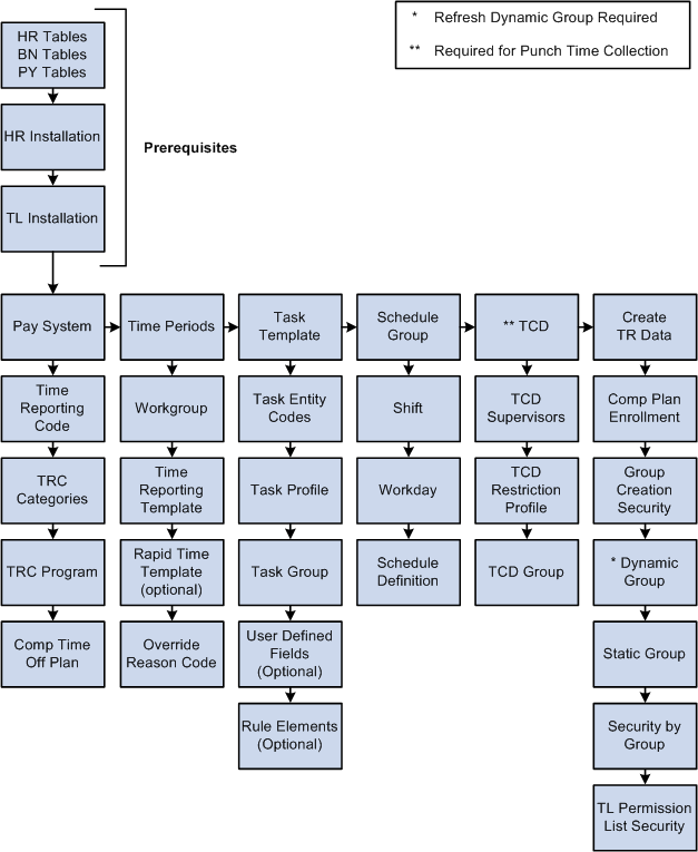

This example illustrates the tables and pages required to implement PeopleSoft Time and Labor
