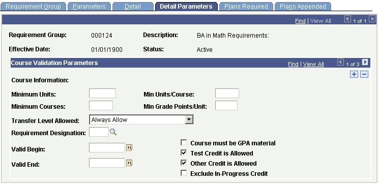

Detail Parameters |
ADVIS_RG_DET_PARM |
Establish course validation parameters. This page is blank unless the group line type on the Detail page is Course or Wild Card Course. |

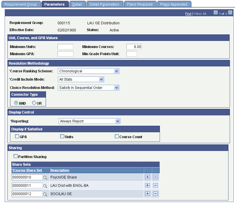

Access the Parameters page ().
This example illustrates the fields and controls on the Parameters page. You can find definitions for the fields and controls later on this page.
Note: For requirement group parameters to work, you must define detail lines on the Detail page. You can set up the parameters first, but detail lines are necessary for the parameters to be effective.
The fields on this page are identical to the fields on the Requirement Parameters page. If the field values that you enter on the Requirement Parameters page are greater than the field values that you enter on the Requirement Group Parameters page, then the parameters that you specify at the requirement level override those at the requirement group level.
You should always insert required parameters at the lowest level possible. For example, if the requirement specifies that the minimum number of units is 24 and the requirement group specifies that the minimum number of units is 18, then the audit attempts to find 24 units. However, the reciprocal is also true. If the requirement needs 6 units but the requirement group needs 10 units, then the audit engine searches for 10 units.
If a requirement (or a requirement group) needs a minimum number of units and courses that is greater than the sum of the specific line requirements and the Credit Include Mode field value is All Stats at the requirement (or requirement group) level, then the audit engine first uses as many units or courses as needed at the lowest parameter level. For example, if a single requirement line needs one course and a requirement group also points to that single requirement, then you should set the minimum course parameter at the requirement line level.
For more information about how parameters at the requirement group and requirement levels interact, refer to the Credit Include Mode diagram and the supporting text.

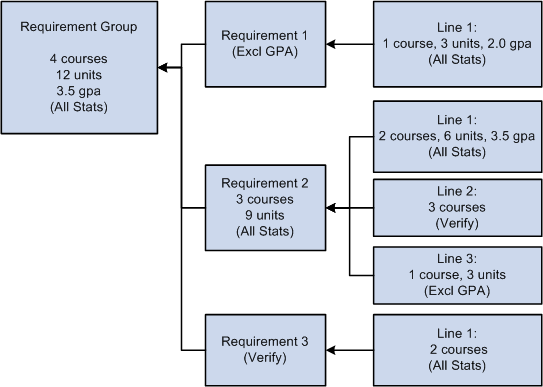

In the following example, the requirement group requires a total of four courses for 12 units with a combined minimum GPA of 3.5. The three detail lines (requirements) contribute to these parameters according to the credit include mode value assigned at each level:
The diagram illustrates how the assigned credit include mode value at every level impacts requirements and parameters.
Requirement 1 has one detail line. The line requires one course of three units with a minimum GPA of 2.0. Credit include mode for this line is set to All Stats, which allows units, course count, and GPA to be passed to the requirement level. The requirement credit include mode is set to Excl GPA, which allows only units and course count to contribute to the minimum parameters required at the requirement group level.
Requirement 2 requires a minimum of three courses for a total of nine units. Line 1 requires two courses with a minimum of six units and a minimum GPA of 3.5. Credit include mode for this line is set to All Stats, so all information is passed to the requirement level. Because this is the only line that contributes to the GPA at the requirement level, the GPA required at the requirement group level is derived from the courses captured here. Line 2 requires three courses, but the credit include mode at this level is set to Verify, so no course information is passed to the requirement level. No courses used here contribute to the three courses or nine units at the requirement level. This line only helps to satisfy the overall requirement by passing a true (if the three courses are found) or false. Line 3 requires one course of three units. The credit include mode for this line is set to Excl GPA, which prohibits the line from contributing to the minimum 3.5 GPA at the requirement group level. Only course count and units are passed to the requirement level.
Requirement 3 has one detail line that requires two courses. Credit include mode for this line is set to All Stats, so courses are used to satisfy this line, and course count, units, and GPA are passed to the requirement level. However, the credit include mode for the requirement is set to Verify, so no course information is passed to the requirement group level. This requirement passes a true or false value to the requirement group level and is used in determining the completion status of the overall requirement group.

Access the Detail Parameters page ().
This example illustrates the fields and controls on the Detail Parameters page. You can find definitions for the fields and controls later on this page.
Course Validation Parameters
Field or Control |
Description |
Course Information |
Displays course information from the Detail page. Course information appears only if you entered a group line type of Course or Wild Card Course. |
Minimum Units |
Enter minimum units for the class. |
Min Units/Course (minimum units per course) |
Enter the minimum number of units that each course or wildcard course must provide to satisfy the requirement group. |
Minimum Courses |
Enter the minimum number of courses required for this detail line. |
Min Grade Points/Unit (minimum grade points per unit) |
Enter the minimum number of grade points per course unit that the student must attain for a course to be included in this detail line. |
Transfer Level Allowed |
Enter the allowed type of transfer credit (if any) for the course. Values for this field are delivered with your system as translate values. Do not modify these values in any way. Any modifications to these values will require a substantial programming effort. Values are: Always Allow: Select to specify that all applicable transfer credit can satisfy the requirement. Four-Year Institution Only: Select to specify that only transfer credit from four-year institutions can be used to satisfy the requirement. Never Allow: Select to specify that transfer credit can never satisfy the requirement. Two-Year Institution Only: Select to specify that only transfer credit from two-year institutions can be used to satisfy the requirement. None: Select to specify that all applicable transfer credit can satisfy the requirement. When selected, the value converts to Always Allow Note: On the School Data page, you can define an external organization as a two- or four-year institution. The Advisement School Type field on the School Type Table page contains the value that drives the derived lists in academic advisement. Each school type may belong to an advisement school type. |
Requirement Designation |
Select to specify the course as valid only if it has this requirement designation associated with it. Typically, you attach this designation to a course, and it affects one section of that course. A requirement designation may reflect additional work that a student needs to complete in addition to the regular course. For example, the requirement designation might indicate that the course is valid only if it was taken with an optional extra credit requirement designation of architecture design credit. Depending on the setup data in the Requirement Designation Table page, a separate course grade may or may not be required for designation credit to be earned. If a separate requirement designation grade is required, then you must enter an RD (requirement designation) grade of Satisfied on the Grade Roster 2 page or the Student Enrollment 4 page for academic advisement to include the course. If a separate requirement designation grade is not required, then the student must earn a passing grade in the course to which the requirement designation is attached for designation credit to be granted. (You define the minimum grade needed.) If a requirement designation is required, then an RD grade of Unsatisfied (or no RD grade at all) causes the course to be rejected. If a separate requirement designation grade is required but the course is still in progress, then the degree audit records the requirement designation as if it were satisfied. |
Valid Begin and Valid End |
Enter a date range to specify when the student must take this course to satisfy the requirement. Leave these fields blank to specify that the student can take the course during any time period. The system uses the start date of the term in which the student takes the course. |
Course Must Be GPA Material (course must be grade point average material) |
Select to specify that the course taken to satisfy this requirement group needs to be applied toward the student's career grade point average calculation. The student cannot take the course on a pass/no pass or audit basis, but only for a grade. Important! Only courses with grades for which you select the Include in GPA check box on the Grading Scheme Table page are eligible. |
Test Credit is Allowed |
Select to specify that the course can originate from the test credit portion of the student's academic record. |
Other Credit is Allowed |
Select to specify that the course can originate from the other credit portion of the student's academic record. Note that the system marks and treats internal transfer credit as enrolled credit. |
Exclude In-Progress Credit |
Select to specify that the course must be fully graded for the system to consider it valid. If you do not select this check box, then the system includes a no graded course, a course with a grade of incomplete, or a course in progress as part of the academic analysis and the course satisfies all parameters. Typically, you use this check box for enrollment requisites on the Enrollment Requirement Group component. You do not usually use it for academic advisement reports. |
Example
In this example, the Exclude In-Progress Credit check box is selected. To fulfill the honors requirement, a student must have a minimum 3.5 verifiable cumulative GPA. To build this requirement, create an academic requirement group with the following two detail lines:
Detail line 1: Condition line type of cumulative GPA >= 3.5
AND
Detail line 2: Wild Card Course line type.
On the Parameters page, enter a Minimum Courses field value of 1. On the Detail page, create a detail line with a Group Line Type field value of Condition. On the same page, create a second detail line with a Group Line Type value of Wild Card Course. On the Detail Parameters page for detail line 2, select the Exclude In-Progress Credit check box. Now the system verifies that the student has a cumulative GPA of >= 3.5 and is not a first semester student with only in-progress courses.
Remember, if the Exclude In-Progress Credit check box is not selected, then even those students who have no course work completed, but who have at least one course in progress, will meet this requirement.
