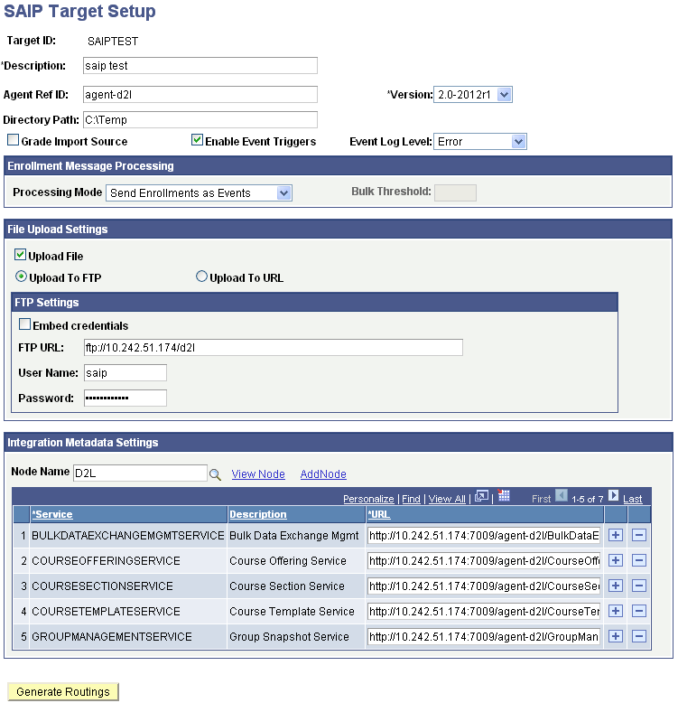

This example illustrates the fields and controls on the SAIP Target Setup page. You can find definitions for the fields and controls later on this page.
SAIP autogenerates the routings in Integration Broker for each target.

Agent Ref ID |
This is an instance identifier used to differentiate, if necessary, between multiple end system reference agents. This value is also used by SAIP to associate incoming requests with targets. Based on the Learning Information Services 2.0 specification, sending systems can distinguish themselves by populating an IMS header value, imsx_sendingAgentIdentifer. SAIP checks this value against the Agent Ref ID string which is set in the Web Service Targets page for the target. Make sure to coordinate the value that is set here with the external LMS to ensure incoming messages can be correctly processed. |
Version |
Select the version number that corresponds to the LIS version that the target system has implemented (for example, with Blackboard Learn SP8 select version 2.0-2011). See the Student Administration Integration Pack Implementation Guide in My Oracle Support (ID 1357846.1) for SAIP documentation specific to your LMS vendor. |
Directory Path |
If you want SAIP to place the snapshot XML file in file, you must specify that path here. If no directory path is specified, the XML file is placed in the application server's TEMP folder. |
Grade Import Source |
Select to define the target as the source for the import of final grades into the grade roster. When this check box is selected, the Grade Import group box and the Import Grades button appear on the Grade Roster page (GRADE_ROSTER_TYPE) in the Student Records Grade Roster component (GRADE_ROSTER) and on the grade roster page in faculty self-service (SS_GRADE_ROSTER), provided that grade import has also been enabled on the SAIP Installation page (SAE_SETUP). You must click the Import Grades button on the Grade Roster page to run the import. When the check box is not selected, grade import is not available. You can select or clear this check box at any time after initialization without consequence. |
Enable Event Triggers |
Select to enable all of the event-based triggers that are delivered preset within the SAIP system. |
Note: The Target ID must be globally unique across both LDAP and web service bindings.
