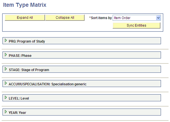

Identifying Child Item Types
As explained earlier in the “Setting Up Academic Item Types” section, the Item Order value of an academic item (defined on the Academic Item Type page) indicates which items are potential child items for that academic item.
After you create your academic item types, use the Item Type Matrix component to determine which item types (those with a higher item order than the item itself) can be defined as child item types for each academic item.

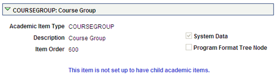

When the Child Academic Items check box is cleared on the Attributes page for an academic item type, a message appears in the Item Type Matrix for that item type: This item is not set up to have child academic items.

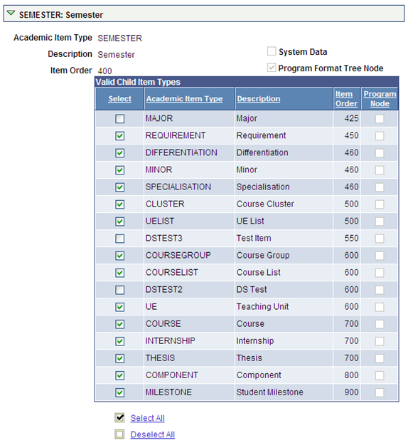

The Valid Child Item Types grid is refreshed whenever the component is opened. For each item type, the system retrieves all other academic item types with an item order (SSR_ITEM_TYPE.SSR_ITEM_LVL) that is greater than its own item order.

Select |
Select this check box to identify the item as a valid child for the academic item type. Note: Only item types for which this check box is selected are listed as potential child items in any prompt for this item. This applies in: Program Format definition. Academic Item Registry: adding child elements Academic Progress Tracker: adding child items and substituting items. See Setting Up Program Formats |

Sort items by |
Sort by Item Order, Item Type, or Item Description. The default value is Item Order. |

Here on the Item Type Matrix page (SACR, Product Related, Student Records, Program Enrollment, Item Type Matrix):
Click the Sync Entities button. This initiates the SSR_PE_SYNC process.
Check the Process Monitor to ensure that the process completes successfully.
This process can be scheduled using the process scheduler
Note: If you make changes on the Item Matrix page, be sure to save those changes before you launch the Sync Entities Process.
