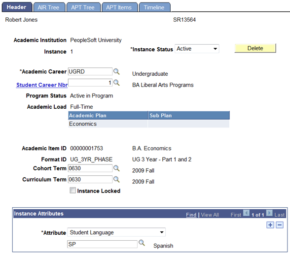

An APT Instance Header:
Can have multiple attributes.
Can have multiple rows for the same item attribute as long as the attribute is repeatable, and the Value is different (for example Attribute A, with Value 1, Attribute A with Value 2).
Attributes are assigned using the Instance Attributes scroll area:
Field or Control |
Description |
Attribute |
The name of the attribute. This value comes from the description entered for the attribute on the Common Attribute component. |
Value |
This field changes depending on the type of attribute. This could be a numeric, date, time or text field. Alternatively, the field could prompt against a list of values if one has been defined for the attribute. |
