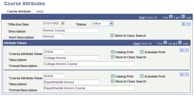

Access the Course Attributes page ().
This example illustrates the fields and controls on the Course Attributes page. You can find definitions for the fields and controls later on this page.
Note: Use course attributes for institutional research purposes and to print repetitive text in the schedule of classes or course catalog, such as Offered in Fall Only. Course attributes are attached to courses on the Catalog Data page and to classes on the Basic Data page. Unlike requirement designations, course attributes do not transfer to PeopleSoft Academic Advisement.
Field or Control |
Description |
Status |
Select a status for this course attribute. Select Active when adding a new course attribute. Select Inactive if your institution no longer uses this attribute and any of the corresponding attribute values. |
Description |
The description that you enter here appears on the schedule of classes report or the course catalog report if you select the Schedule Print check box or the Catalog Print check box. |
Course Attribute Value |
When you attach attributes to courses and classes, you can also specify attribute values. Therefore, you can define parent course attributes that have one or more attribute values. Insert rows to create multiple attribute values. |
Catalog Print |
Select to display the course attribute formal description in the course catalog report. Note: The SSR_COURSE (Course Catalog) web service is one of a number of delivered Enrollment Web Services. The service operation SSR_GET_COURSES: Browse Course Catalog Summary obeys the Catalog Print setup that you select on the Course Attributes page and on the Requirement Designation Table page. For detailed information about Enrollment Web Services, see Enrollment Web Services Developers Guide and Enrollment Web Services Users Guide in My Oracle Support (ID 1371391.1). |
Schedule Print |
Select to display the course attribute formal description in the schedule of classes report. |
Show in Class Search |
If this check box is selected for a Course Attribute and the Class Search Profile (for example, STDNT) includes a search criteria of Course Attribute, then a student can search by the Course Attribute in Self Service. If this check box is selected for a Course Attribute Value, the Class Search Profile (for example, STDNT) includes a search criteria of Course Attribute, and the Include Course Attribute Value check box is selected for the profile, then a student can search by the Course Attribute Value in Self Service. See Setting Up Class Search Profiles |
Description |
Enter a description of the attribute values. |
Formal Description |
Enter the text that you want to appear on the schedule of classes report or the course catalog report if you select the Schedule Print check box or the Catalog Print check box. |

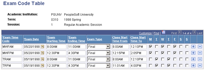

Access the Exam Code Table page ().
This example illustrates the fields and controls on the Exam Code Table page. You can find definitions for the fields and controls later on this page.
Note: Define exam time codes for each term and session. The system uses these codes when you run the exam scheduling process on the Exam Scheduling page. You can also manually post these codes to individual classes.
Field or Control |
Description |
Exam Time Code |
Enter an exam time code to define (in an abbreviated manner) the exam code. |
Exam Date |
Enter the date for the exam. |
Exam Starting Time |
Enter the start time of the exam. |
Exam Ending Time |
Enter the end time of the exam. |
Exam Type |
Select the exam type. Values for this field are delivered with your system as translate values. You can modify these translate values. |
Class Start Time From |
Enter the minimum start time for classes with which you want to associate the exam time code. The system uses the value during the exam scheduling process. The system schedules exams for classes that fall within the two start times (and days) that you designate. |
Class Start Time To |
Enter the maximum start time for classes with which you want to associate the exam code. The system uses the value during the exam scheduling process. The system schedules exams for classes that fall within the two start times (and days) that you designate. |
M (Monday), T (Tuesday), W (Wednesday), T (Thursday), F (Friday), S (Saturday), and S (Sunday) |
Select the days of classes that you want to associate with the exam code. |

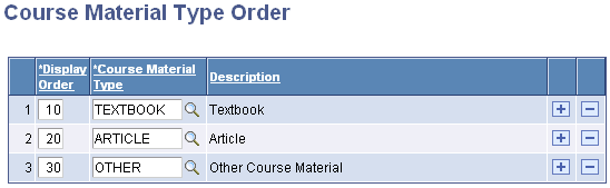

Access the Course Material Type Order page ().
This example illustrates the fields and controls on the Course Material Type Order page. You can find definitions for the fields and controls later on this page.
Note: The system uses the display order that you define here to determine the order in which course materials appear on the Class Detail page and on the self-service Faculty and Student Textbook Summary pages. If you do not define a course material display order, the course material appears at the end of the list.
Field or Control |
Description |
Display Order |
Define the order in which you want the course material type to appear on Class Detail page and on the faculty and student Textbook Summary pages. |
Course Material Type |
Select a value based on the course material type values that you defined on the Course Material Type page. |
Description |
The description appears by default from the Course Material Type page. |
