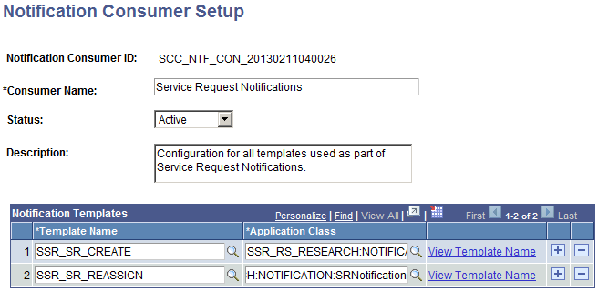

Use the Notifications framework to set up service request notifications so that when a service request is created or reassigned, the system automatically sends a notification to the administrator to whom the request has been assigned/reassigned.
The Notification Consumer ID: SCC_NTF_CON_20130211040026 Service Request Notifications is delivered:
This example illustrates the fields and controls on the Notification Consumer Setup page example for Service Requests. You can find definitions for the fields and controls later on this page.
Delivered settings for Service Request Notifications:
Notification Trigger |
Template Name |
Generic Template |
Application Classes |
Notes |
Entry of a new Service Request by a student or administrator from the Service Request pages. |
SSR_RS_CREATE |
SSR_RS_CREATE |
SSR_RS_RESEARCH:NOTIFICATION:SRCreateTemplateProvider |
You must use the delivered template name. You can change the notification to use a different notification channel instead of email. If the Notification Type is set to Alert, a PeopleTools alert is generated in the Notifications region of a fluid homepage as well as a Notification Framework alert in the Notifications Center. Use the sample generic template as an example for creating your own notification content. The sample template defines the available field variables that can be used in the notification message content. |
Reassignment of an existing service request from the administrator Service Request pages. |
SSR_RS_REASSIGN |
SSR_RS_REASSIGN |
SSR_RS_RESEARCH:NOTIFICATION:SRReassignTemplateProvider |
See Notes in the row above. |

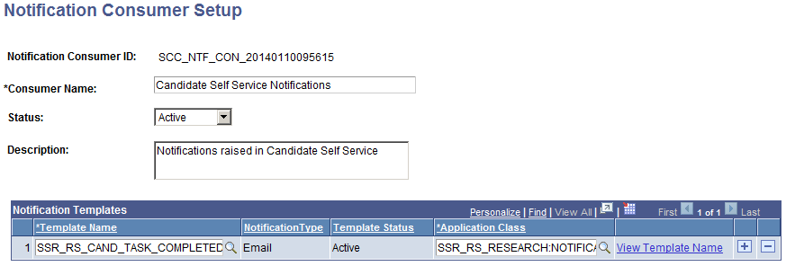

Use the Notifications framework to set up service item notifications so that when a service item is created from the Candidate Center, the system automatically sends a notification to a designated administrator.
The Notification Consumer ID: SCC_NTF_CON_20140110095615 Candidate Self Service Notifications is delivered:
This example illustrates the fields and controls on the Notification Consumer Setup page example for Service Items.
Delivered settings for Candidate Self Service Notifications:
Template Name |
Generic Template |
Notes |
Entry of a new Research Service Item from the Candidate Center by the student. |
SSR_RS_CAND_TASK_COMPLETED |
SSR_RS_RESEARCH:NOTIFICATION:RSTaskTemplateProvider |
Use the sample generic template as an example for creating your own notification content. |

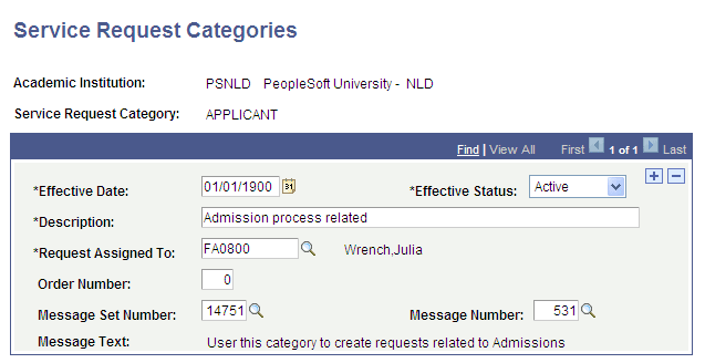

Access the Service Request Categories page (
).This example illustrates the fields and controls on the Service Request Categories page. You can find definitions for the fields and controls later on this page.
Field or Control |
Description |
Request Assigned To |
Select any EmplID from the system. The selected ID is the designated administrator of last resort. When a service request is created and the system is unable to determine the appropriate administrator to whom to assign the request, this ID is used as the default. |
Order Number |
This field controls the sorting order of the category in the Select a Request Category self-service page. The system performs the sorting in ascending order. Default is 0. |
Message Set Number, Message Number and Message Text |
The message text that you select here appears when the mouse cursor is moved over the category in the Select a Request Category self-service page. You can configure the message using the PeopleTools Message Catalog component (PeopleTools, Utilities, Administration, Message Catalog). |

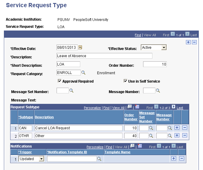

Access the Service Request Type page (
).This example illustrates the fields and controls on the Service Request Type page. You can find definitions for the fields and controls later on this page.
The Service Request Type values that you set up here are available in the Service Request Management component for administrators as well as the Service Request Assignment Setup component. You can choose whether or not to make the Service Request Type available in self service for students.
See Administering Service Requests (Administrators)
See Creating and Updating Service Requests (Candidates)
Field or Control |
Description |
Request Category |
Select the category to which the type belongs. |
Approval Required |
The check box is informational-only. |
Use in Self Service |
Select if you want the type (and its subtypes) to be made available in the Select a Request Type self-service page. |
Order Number |
This field controls the sorting order of the type in the Select a Request Type self-service page. The system performs the sorting in ascending order. Default is 0. |
The message text that you select here appears when the mouse cursor is moved over the type in the Select a Request Type self-service page. You can configure the message using the PeopleTools Message Catalog component. |
Request Subtypes
Subtypes enable users to be more specific in the definition of the request (for example, Request type: Notice of intent to submit and Subtype: Request to extend submission date).
The fields for subtype are similar to the fields for the request type
Use of subtypes is optional. If you do not define a subtype, the Select a Request Subtype self-service page does not appear for the student (after the student selects a request type).
Notifications
Use this setup to define optional notifications by service request type. The administrator assigned to the service request receives the notification.
Field or Control |
Description |
Trigger |
Select the action that initiates the corresponding notification template:
Notification Template ID |
The notification template ID prompts the templates setup for the Service Request Notifications consumer ID. Only templates associated with the SSR_RS_RESEARCH:NOTIFICATION:SRTemplateProvider application class can be used. |

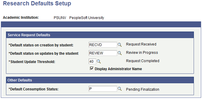

Access the Research Defaults Setup page (
).This example illustrates the fields and controls on the Research Defaults Setup page. You can find definitions for the fields and controls later on this page.
Service Request Defaults
Field or Control |
Description |
Default status on creation by student |
Select the status which the system assigns to the new service request row when the student creates a new service request from self-service pages. This field prompts you with request status codes (System Usage = Request) from the Process Status Codes page. |
Default status on updates by student |
Select the default status code to be used when students update an existing service request. |
Student Update Threshold |
Select a status code level value. These values are defined on the Process Status Codes page. The status code level value here indicates the maximum status code level at which a student can update a service request using My Service Requests. For example, a student cannot update a service request from the self-service page if the threshold here is set at 30, and the student's service request status code level value is greater than or equal to 30. Note: Students can view service requests that they can no longer update. |
Display Administrator Name |
Select this check box if you want the student's My Request Detail self-service page to display the administrator’s name. If you do not select this check box, the My Request Detail page displays the text Staff instead of the administrator name to insure anonymity. |
Other Defaults
Field or Control |
Description |
Default Consumption Status |
Select to assign an initial consumption status when the candidate record is created for the first time from a process that does not allow the user to manually set the value. The impacted processes are: Quick Admit, Student Program/Plan updates, and Program Addition. Note: The impacted processes display an error message for any new candidate records until this setting is completed. |

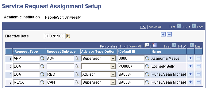

Access the Service Request Assignment Setup page (
).This example illustrates the fields and controls on the Service Request Assignment Setup page. You can find definitions for the fields and controls later on this page.
Use this page to define how a service request is assigned to an administrator for review.
When a service request is entered, the system uses the service request type and subtype values to find matching values in the setup.
If a matching row is found and if the Advisor Type Option is set, the system tries to find the student's academic advisor or research primary supervisor. If found, the system identifies the advisor and assigns the service request. If the advisor is not found (or if the Advisor Type Option was not set), the system assigns the Default ID as the administrator.
If a matching row is not found, the system searches for a row with a matching request type value and a blank request subtype and follows the same assignment logic if a match is found. If the system still does not find a match based on the preceding criteria, it then identifies the category of the service request and assigns the request to the administrator defined in that request category setup.
Beginning with April 2014, the Rules Engine performs the service request assignment functionality, with the rule following the parameters as previously described. If you require additional flexibility in how service requests need to be assigned in your institution, you can update the rule with your own business logic. The delivered rule is:
Rule ID: SCC_RULE_ID_20140205065106
Rule Name: "Service Request AssignedTo : Rule Trigger"
Rule Category Name: Service Requests
For more information about the Rules Engine, see Understanding the Rules Engine.
Field or Control |
Description |
Request Type and Request Subtype |
Select a value from those defined on the Service Request Type page. |
Advisor Type Option |
Select Advisor, Supervisor or leave the field blank. If you select Advisor, the system assigns service requests of this type/subtype to the candidate’s Academic Advisor, as indicated on the Student Advisor page. See Assigning Academic Advisors to Students. If you select Research Supervisor, the system assigns service requests of this type/subtype to the candidate’s primary Supervisor as indicated on the Candidate Management - Supervisors page (the Supervisor record with the Primary Supervisor check box selected). |
Default ID |
If you do not select an Advisor Type Option, the system assigns service requests of this type/subtype to the person that you select as the Default ID. |
