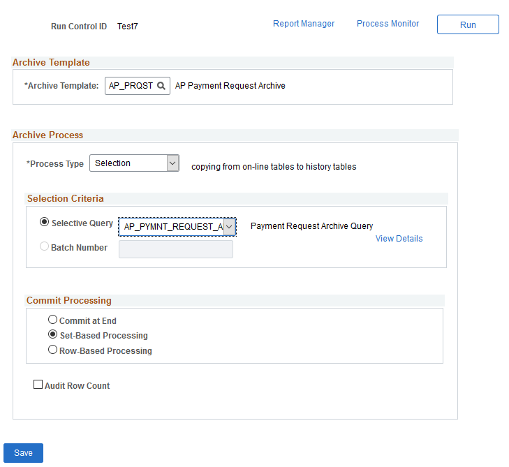

Access the Archive Data To History page (select ).
This example illustrates the fields and controls on the Archive Data To History page

Archive Process
Use this section to manage the processes that are associated with the selected archive template. As the archiving process runs, counters are inserted into work tables to indicate which records have been processed (for both set-based and row-based operations) and the number of rows processed (for row-based operations only).
For commits by table, the database server commits only after each record is processed. If the process fails in the middle of processing a record (say, the database logs were full), it will perform a rollback of everything that has not committed.
For commits by row, if the process fails for any reason, the counters keep track of only those rows that have been committed to the database. When the Application Engine job is restarted, it skips all the rows that have been committed, and begins with the first uncommitted row.

Process Type |
Select an option:
Selective Query |
Specify the archive or restore query defined within the archive template to use at run time. If there are bind variables, you will be prompted to enter the bind variables when you select the Define Binds link. |

Commit Processing
By default, batch processing is performed by the Data Archive Manager using set-based processing. Unless specified using the check boxes below, a commit is issued to the database after each table is processed within the Archive Template.
Field or Control |
Description |
Commit at End |
Data Archive Manager processes data using set-based processing, but doesn't issue any commits to the database server until the entire process has completed. For example, if your Archive Template is defined with Pre- and Post-AE programs, the Data Archive Manager will first run the Pre-AE program, then it will process all of the tables in the Archive Template, then it will run the Post-AE program. Upon successful completion of all these steps, a commit will be issued to the database. When you select this option, the set-based processing option is automatically selected as well. |
Commit by Table |
Data is processed by passing a single SQL statement per record to be archived to the database server. A commit is issued to the database server after successful completion of each SQL statement. |
Commit by Row |
Data Archive Manager processes data one row at a time using PeopleCode fetches. This method of archiving is more memory intensive and takes longer than set-based processing. However, for archiving processes that contain significant amounts of data, row-based processing could be used to reduce adverse affects on the database server. Row-based processing is appropriate when you're archiving large amounts of data from transactional tables and wish to issue commits more frequently. If you select this option, you must enter a commit frequency. |
Commit Frequency |
Specify the number of rows to process before issuing a commit to the database. |
